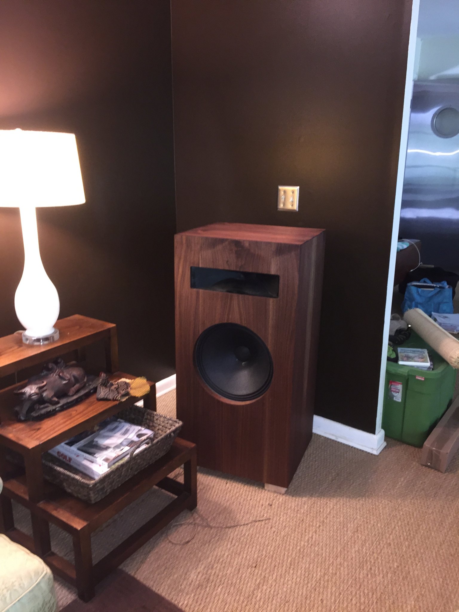

Altec 802D+416A Best Cabinet Design?
'Best' is a 'floating target' based on ALL the needs of the intended app; otherwise, my default recommendation is to use the pioneer's reflex alignment = (measured) Vas/1.44 = cab net volume (Vb) tuned to (measured) Fs = box tuning (Fb).
The basic requirement for a horn is its XO point/slope order and polar response with this driver combo being either 500 or 800 Hz/2nd order, ~ 90 H x 40 V.
Model 19 is what most people like the most with that drivers combination. Off course it's a very oldskool and old design.
The plans are here:https://greatplainsaudio.com/gpa-vintage-altec-ezine/altec-lansing-model-19-cabinet-plans/
And for that you also need the Altec H-811B horn and the N1201-8 crossover (plans of that are here: http://www.audioheritage.org/vbulle...c-Lansing-Model-19-crossover-issues&styleid=9)
But if that also fits your plan, i can't tell, it's just what most do. Some do custom cabinets and put the woofer in an Onken style cabinet and so...
Thanks for the replies @waxx, @ogie, and @GM! Ogie, those cabinets are much more manageably sized than most other designs... I'll read through that thread you linked.
I have the N-500-G crossover, but it at least needs to be recapped and the rotary switch needs to be replaced... I was thinking I would just start from scratch unless there is some unobtainium magic that I should preserve there. The 511B horns leave a very small sweet spot in my experience, and I am hoping to get a broader sweet spot if possible...
Do you know if there were significant production differences in 416A coming out of the factory different years?
Wel, you could also only use the woofer section of the 19 and put the tweeter in a more modern horn like the JBL 2380A or 2382A. That has been done a lot also. You may have to adapt the crossover for the different horn altough...
FYI/FWIW, the popularity of the M19 is primarily due to its XO that negates the 811's expo horn expansion's 'honk', lifts up its rolled off HF, but only works properly if the horn, woofer vertical spacing, cab width is maintained plus many space them up or tilt them back, so some informed DIYers have been doing column/tower/MLTL versions to suit, often tuning to Fs to take advantage of the extra net volume [Vb], better blend to the room.

As for the 'unobtainium magic', this is to a great extent dependent on whether or not it's driven with period correct electronics or not, so assuming not, it takes a significant amount of tweaking to make it ~suitable for modern HIFI apps, so as much as I've enjoyed my various 511s, can't in good faith recommend them to anyone much younger than regular retirees without at least using DSP for XOs, frequency shaping plus significant horn bell damping and a larger version of the later 811 horn speaker's foam surround used to quell the mass quantities of eigenmodes that causes all the reflections back to the throat, modulating the driver (pass band response 'ripple').
As for any 'rising on axis' horn design, a super tweeter is your only viable option with a ~ 3 - 8 kHz XO point/slope to 'taste' 😉.
Early on, no, but over time due to various reasons there was a significant shift for the worst as forum member Pano found out the hard/expensive way with some GPA re-rebuilds, so recommend doing full T/S measurements before wasting another minute pursuing this project and FWIW/YMMV, ditto any Altecs before GPA's own versions, switching instead to modern (prosound) brands/models designed in ~ the performance parameters of truly vintage W.E./Lansing/Altec drivers.
