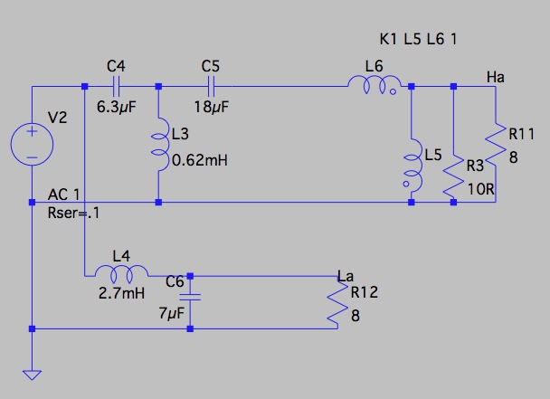

I use GPA 604s. The lowpass is important and I have the best results with a huge cored inductor with a DCR of .07R and low ESR shunt cap. Air core inductors don't cut it here.
That's interesting. Jeff Markwart highly recommends foil air core for his Altec crossover upgrade. Are you using GPA's 604-H crossover?
No, I started with GPA's crossover, then built a Markwart crossover and currently use a modified version of that Markwart without the shelving filter and an autoformer to attenuate the compression driver.
I also took out the loading cap of the compression driver which didn't change anything in my perception of the mids/highs but did a lot for bass. Less "muddy, one-note" and more distinction. In less audiophile speak: the overtones that make the specific sound of an instrument did more of their thing.

Thanks for sharing your experience. I'm currently trying to overcome the muddy bass you referenced as well as fatiguing mids. Would you be willing to share your schematic?
By loading cap do you mean the 6uF C4 in the Markwart schematic? Did you keep all resistors as designed? Finally, where did you insert the autoformer? and what are its specs?

It's bedtime, I'll draw up the crossover schematic tomorrow.

Here's the schematic of my current crossover. Capacitors are relatively uncritical, low ESR polypropylene is a plus. L4 is cored inductor, DCR 0.07 Ohm.
The autoformer L5/L6 is set to -12dB, R3 is the shunt resistor setting the impedance seen by the high pass filter. R3 lets you pick an impedance to play around with smaller C, which then has to be made up with larger L of course.
Picking R3: it can be calculated easily. I did that as a start, then checked behaviour of the crossover on a scope and lastly put a rheostat in that position and measured different settings.
As what worked for me here is for different drivers in a different cabinet it can only be used as an inspiration, you will have to measure anyways.

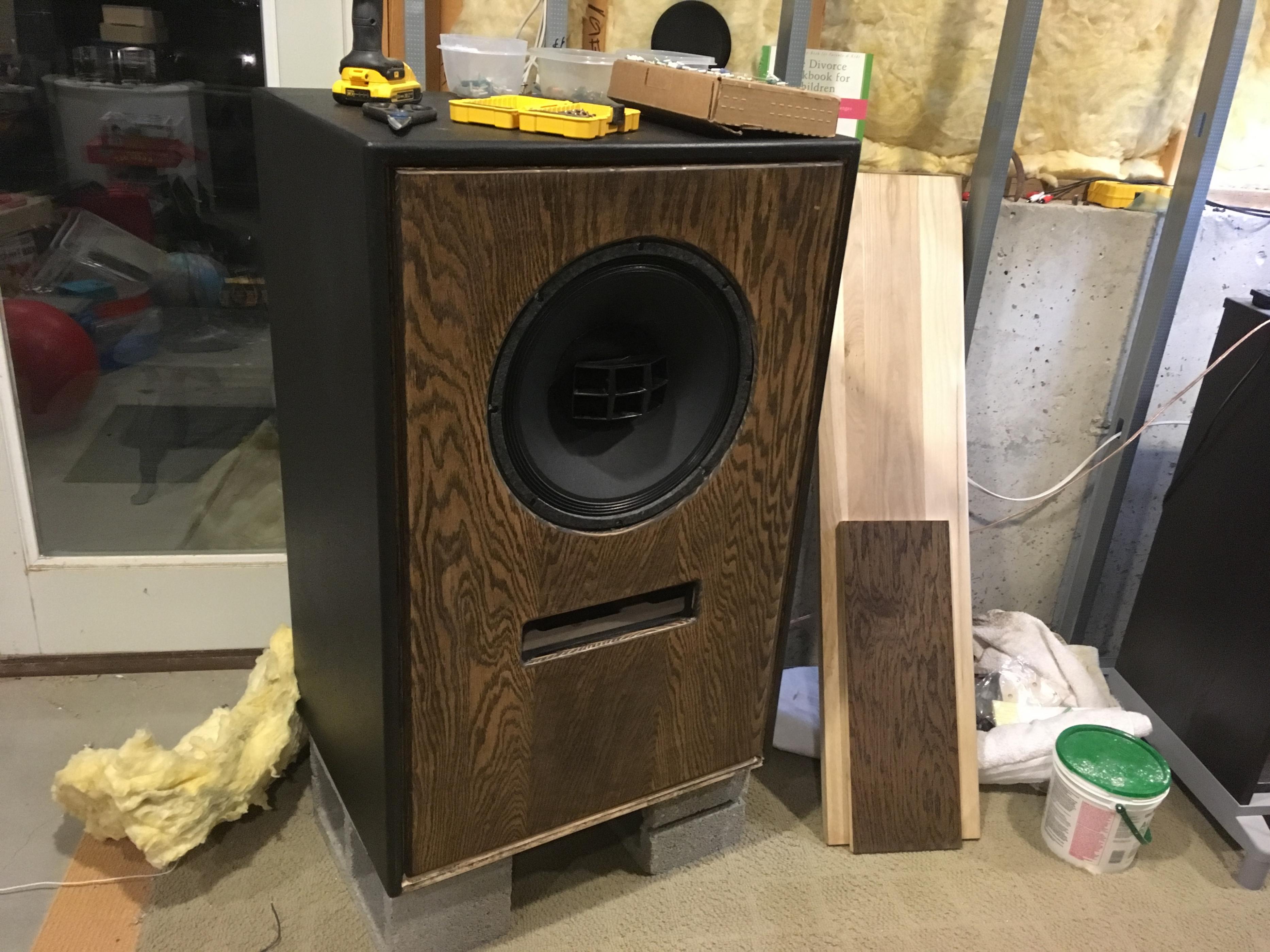

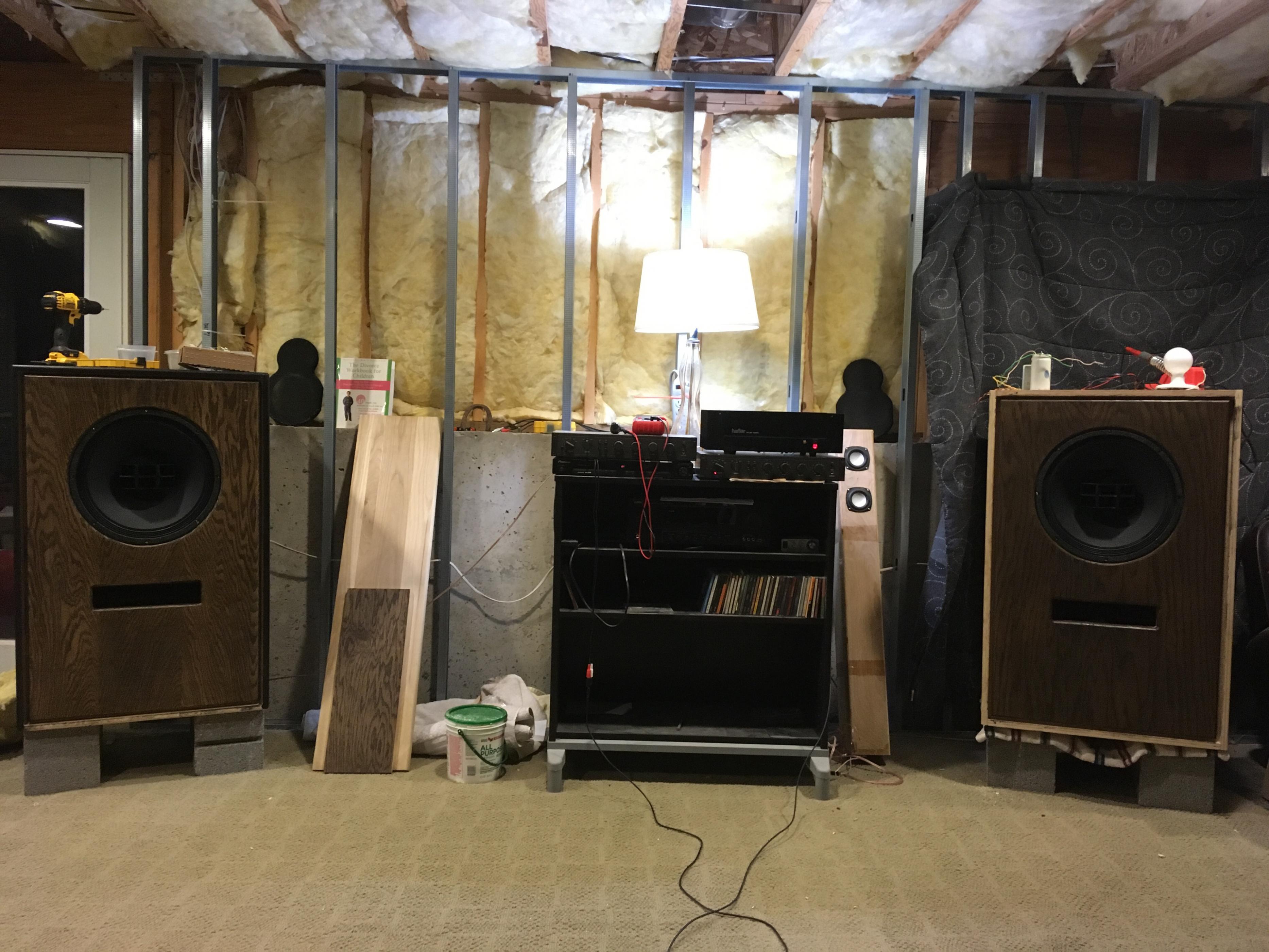

One last question (for now 😀) what cabinet do you have your 604s mounted in?
