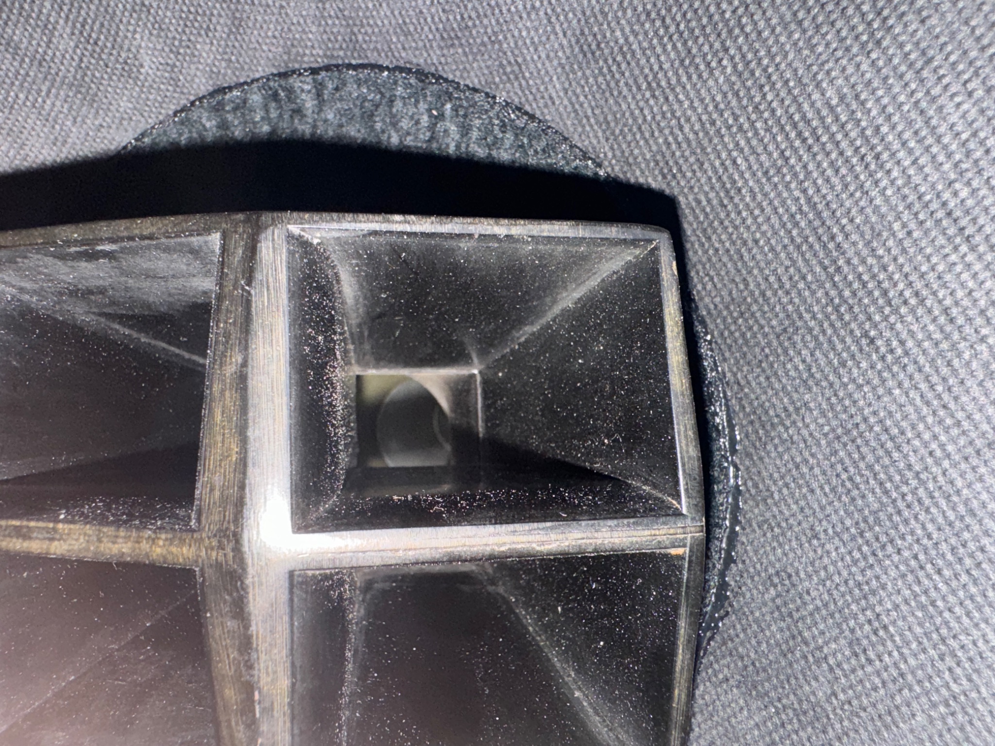

Hello! I've got an Altec 604-8G speaker and the horn is loose. It rocks back and forth side to side and I'm wondering how to tighten it. The upper part of the horn is still firmly glued in place, so I imagine it's the lower section. I've seen pictures and videos and mentions of two accessible screws that should be visible when looking into the horn; however, these don't exist on my speakers. Seems like this is some variant without accessible screws. That said, how do I tighten down the horn? Thanks!

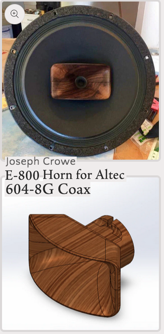

The screws may be positioned like in Crowe's E-800 (behind the felt cover)Seems like this is some variant without accessible screws. That said, how do I tighten down the horn? Thanks!

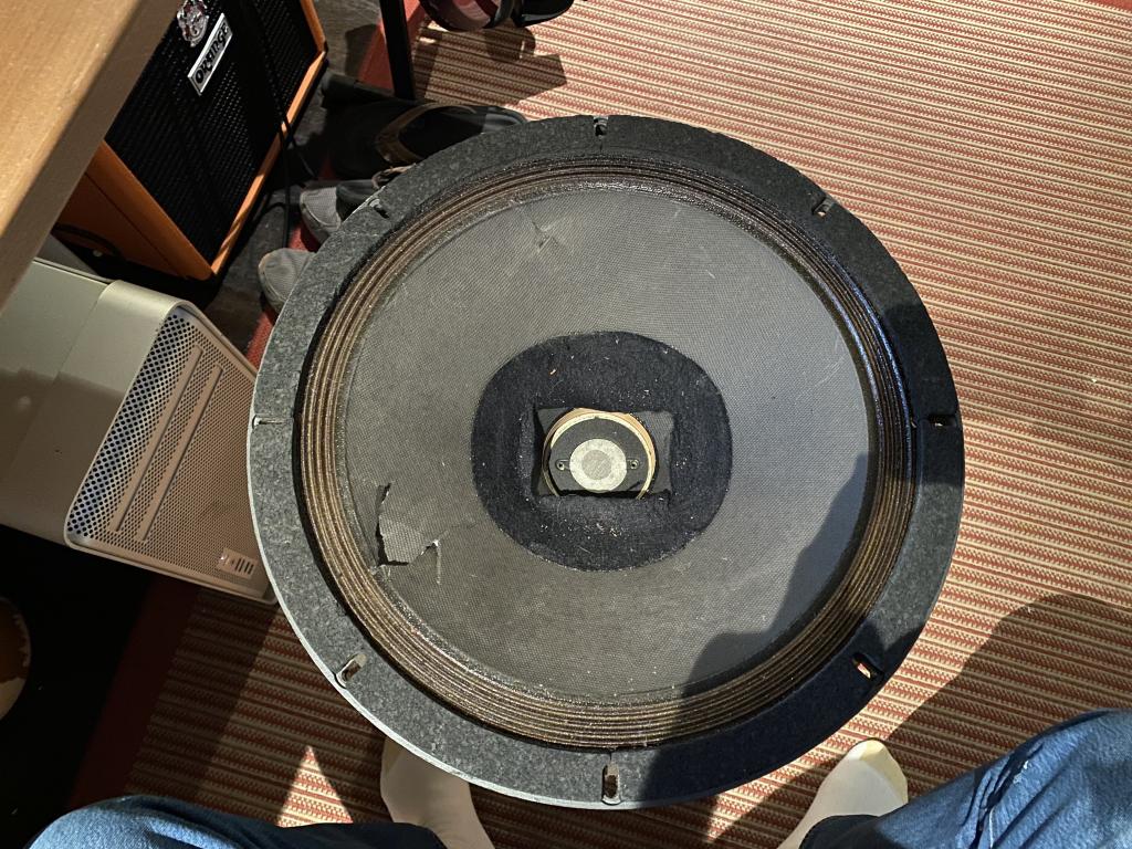

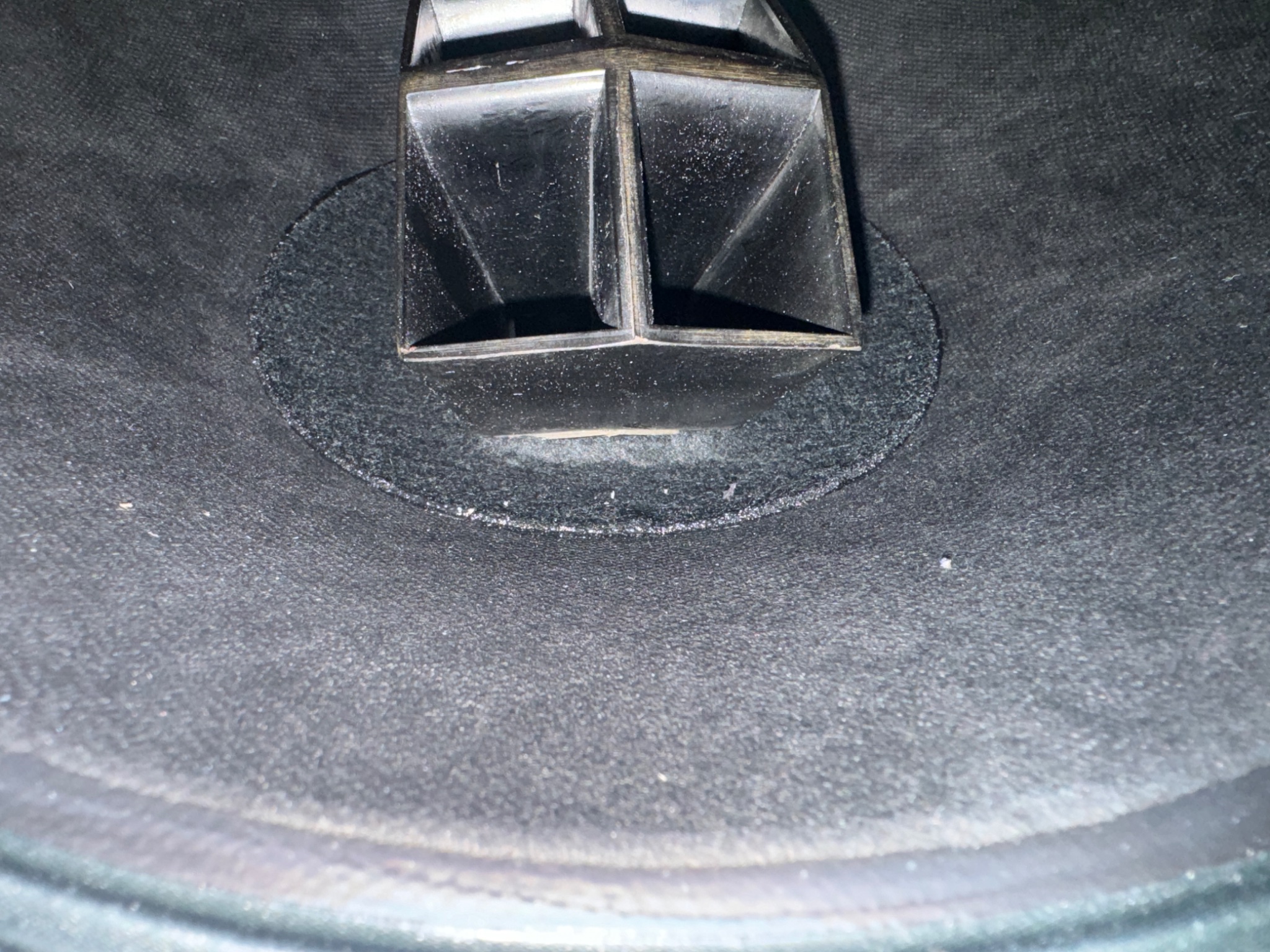

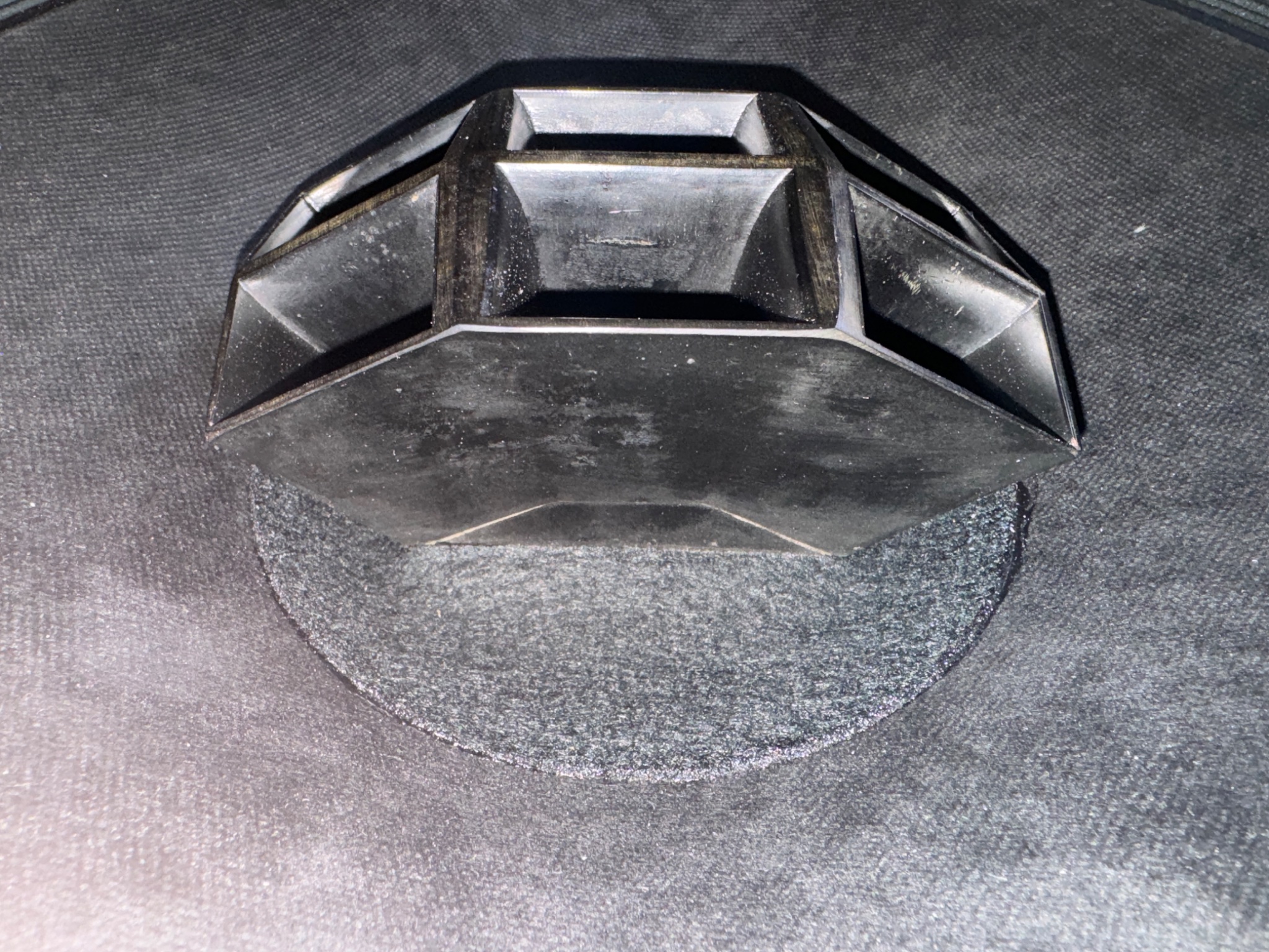

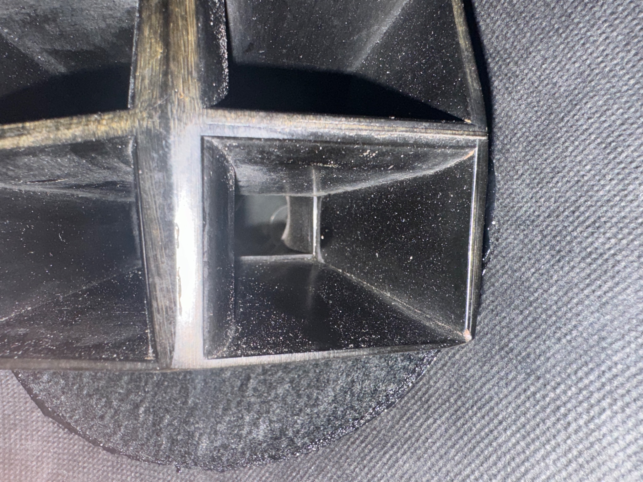

Thanks for the replies. Here are some pictures of the horn and a short video. As you can see the holes are not visible when looking into the horn so perhaps they are indeed under the felt. That said any tips to remove the felt from around the horn? I think this is preferred as opposed to messing with the cone.

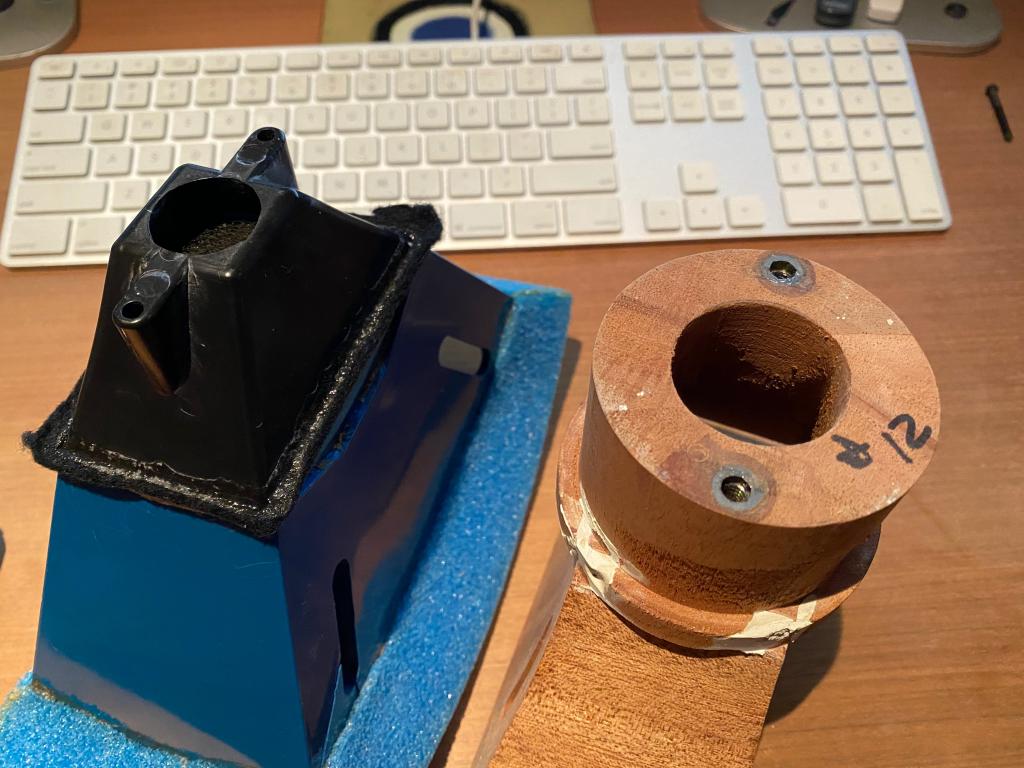

I’ve seen a few images online - I believe on Lansing Heritage - that show something like this… these are the Urei speakers of course but effectively the same. This has the screws accessible from inside the horn unlike mine. I worry about damaging the cone, etc. trying to get at the screws.

If the driver was mine, I'd mash through the felt with a screwdriver rather than removing it.That said any tips to remove the felt from around the horn?
Should be easy enough to locate, might use a toothpick to probe first.

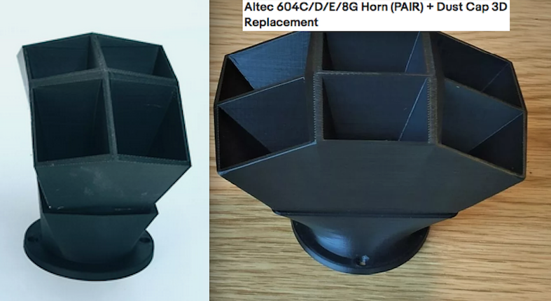

From this 3D print replica replacement, looks like the screw positions are more of a straight shot than I'd have thought:

Judging by what’s on the net, there are only two screws per horn, they are Philips head and I would bet my bottom dollar, it’s a number 2.
........and this from googling:
Carefully unglue the felt ring around bakelite horn. Do not unglue it from the paper cone! Take a carefull look under the felt ring, there are two screws situated at the top and bottom. Carefully, with the right screwdriver and twizzers, unscrew both and remove the original horn.
