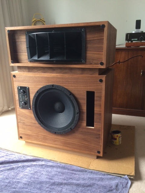

I recently built a Model 19 pair, and I can certainly attest to the deeper bass due to 240-250 liter cabinet size. The 811 horns sounded good, but not as balanced as the 564.
So, I'm going to do two things:
- check the driver in cabinet using sine wave and measure
- play around with dampening, as I've followed a Ye Olde Altec rule of applying dampening to three non facing sides.
See pic of Model 19 (ignore the xover, as these were temporary units). Fs of the reconed drivers were 21Hz....and the bass response in the cabinet was excellent. Foam around driver not in that pic.

'Prosound' as it applied during Altec's 'reign'. Today, it's flat out boombox mode mid-bass 'thump', then EQ'd to suit the app = ~100 L/60-65 Hz Fb.
Can't recall ever auditioning the 564, but in theory would be great for small listening areas such as a recording studio and especially if this small audio 'triangle' was set in a much larger space.
Yeah, saw those recently, makes the originals look cheap in comparison, which no doubt are. Regardless, the 19 was a good value at the time if it was what one wanted and had the space to do it justice.

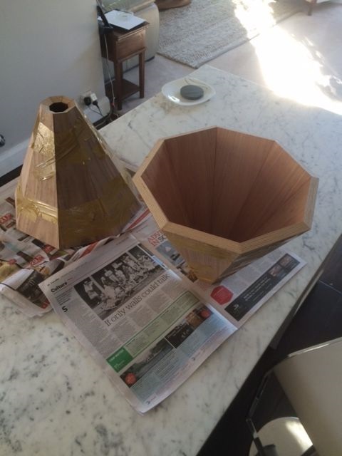

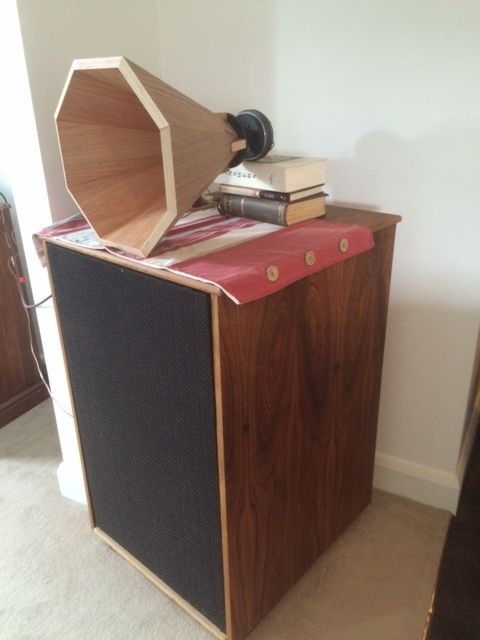

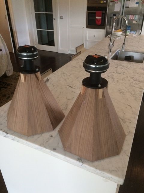

I also built a conical horn, approx. 400Hz Fs. I thought it sounded 'OK', but not terrific. See pic. These had two inch throat, and I used a 2:1 inch adapter for 1 inch driver.

Not surprised since a conical either needs a mouth end correction ['flip out'] to keep it from 'waist banding' or XO'd at least a half octave above its full WL axial length of ~34"/400 Hz, which yours appear to be much shorter, so assuming ~800 Hz in length, then around 1200 Hz and of course will need CD horn EQ to flatten it.
When I did it, had no clue about such things as Harry O. made no mention of it, though in retrospect his horns were big enough that cinema sound was so rolled off up high at the time that there wasn't enough HF BW to 'waist band'. No longer have the book, so don't know if this was somehow implied and I just missed it in my then near total ignorance.
Regardless, I could sure hear it, so having already begun my odyssey of using various materials to damp the various consumer/prosound horn's horrible mouth reflections back to the throat, added an open cell foam horn extension to them, making me a conical horn convert for any serious HIFI app, so might want to try it and d**n the WAF before giving up on so much fine woodworking. Typically I made them at least an octave larger than the design cutoff or 200 Hz in your case, i.e. extend the mouth till its diameter is ~22".
