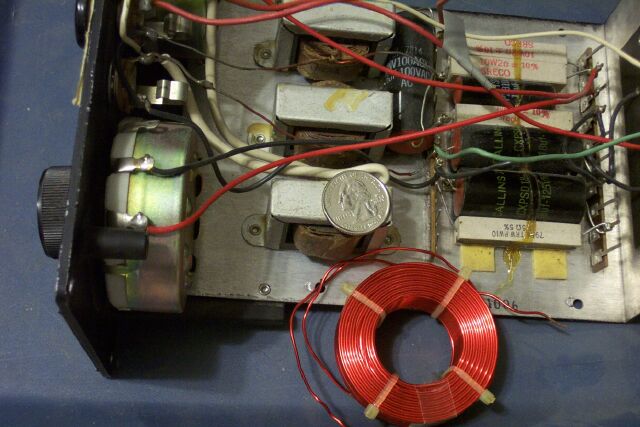

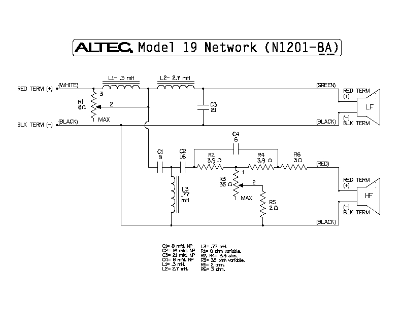

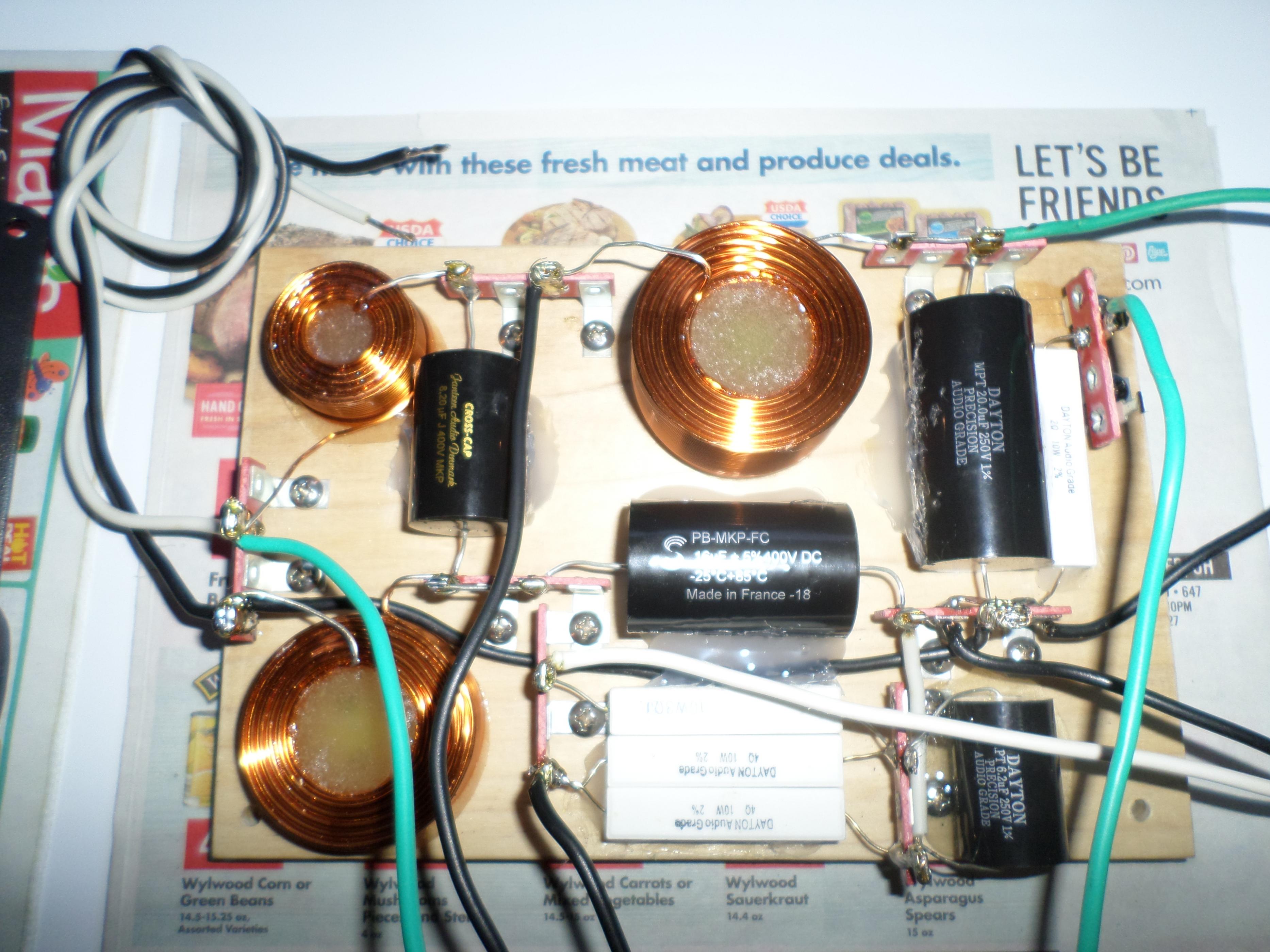

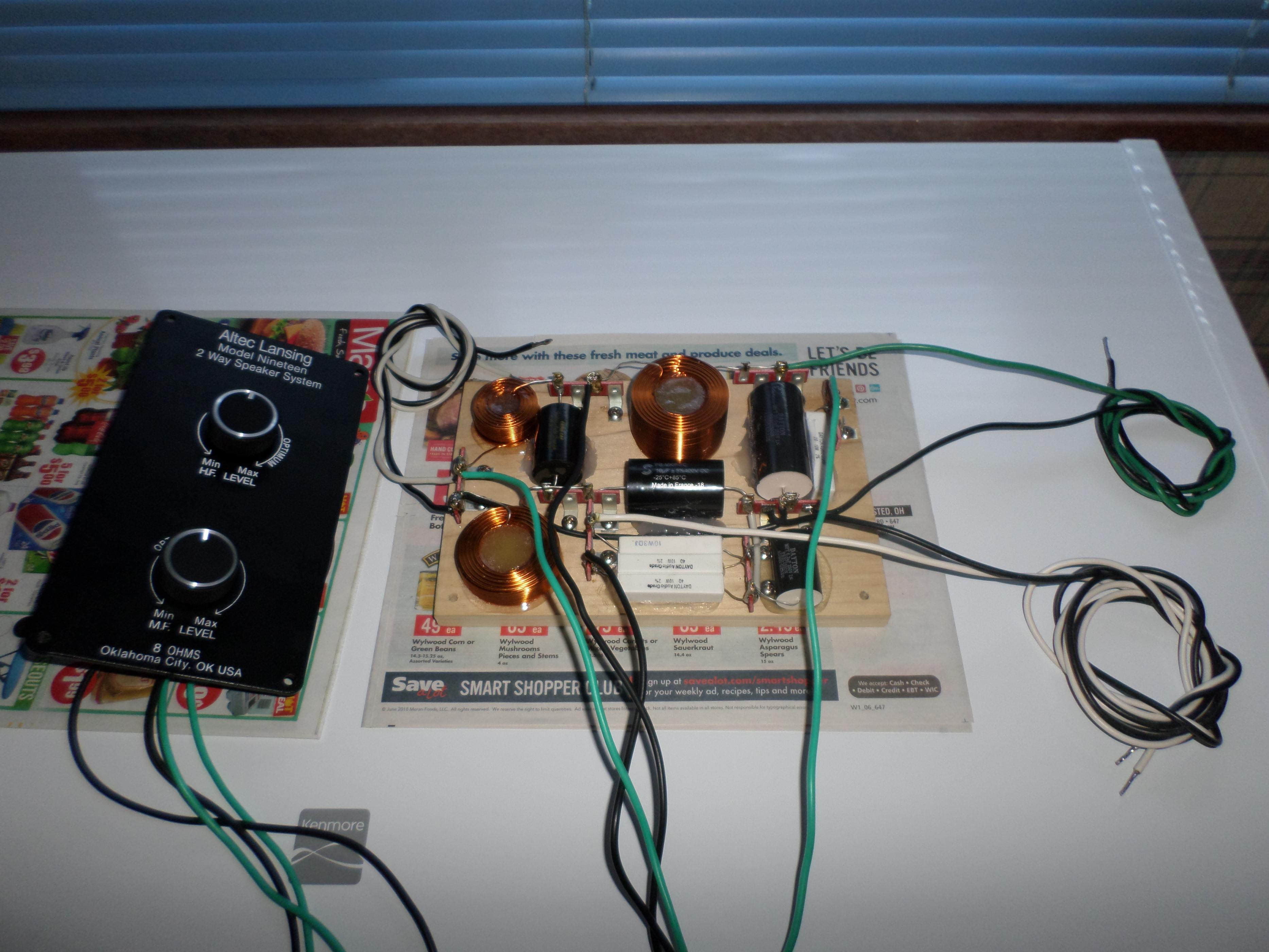

High Power and high quality Potentiometers for this crossover network
Best solution is the replace of the potentiometers by high wattage resistors. But a friend of me would like to continue using potis for the MF- and HF level but in better version.
From where I can order such mono potentiometers ?
In the attachement a pic of the crossover, where the poti is show so as the schematic diagram.
Best thanks for advices.
You can use just one leg of an L-Pot. Otherwise most parts houses should have the 8 and 35 ohm in high powers. They are expensive.

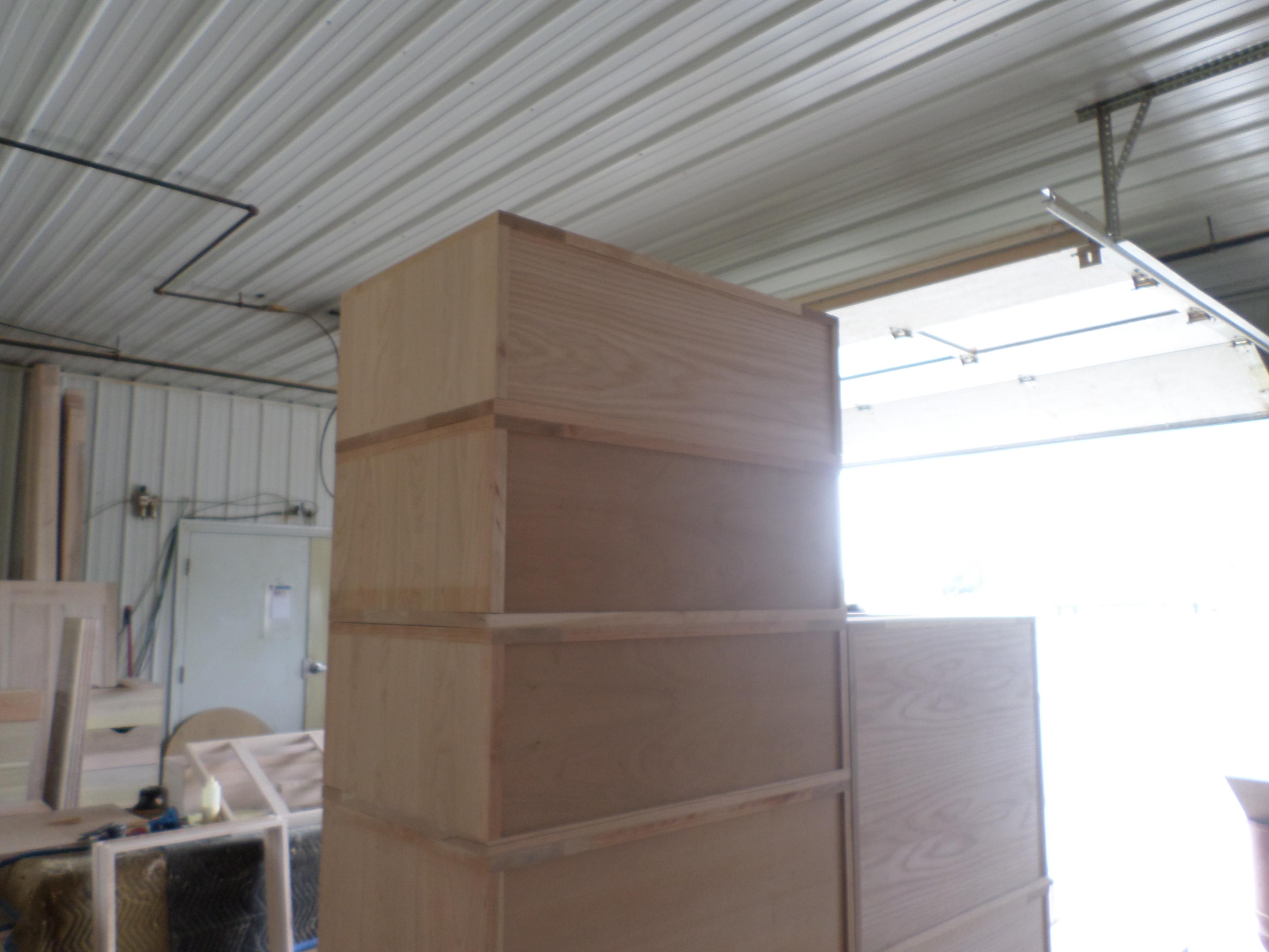

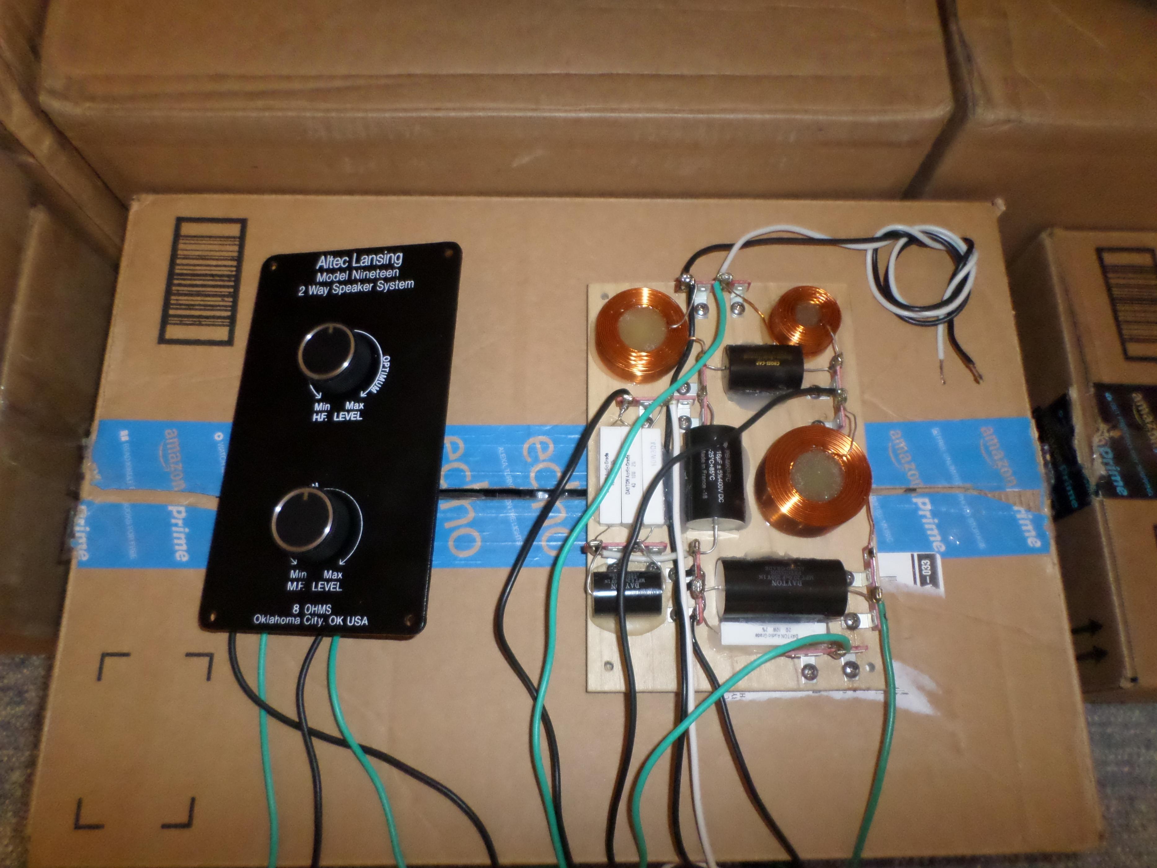

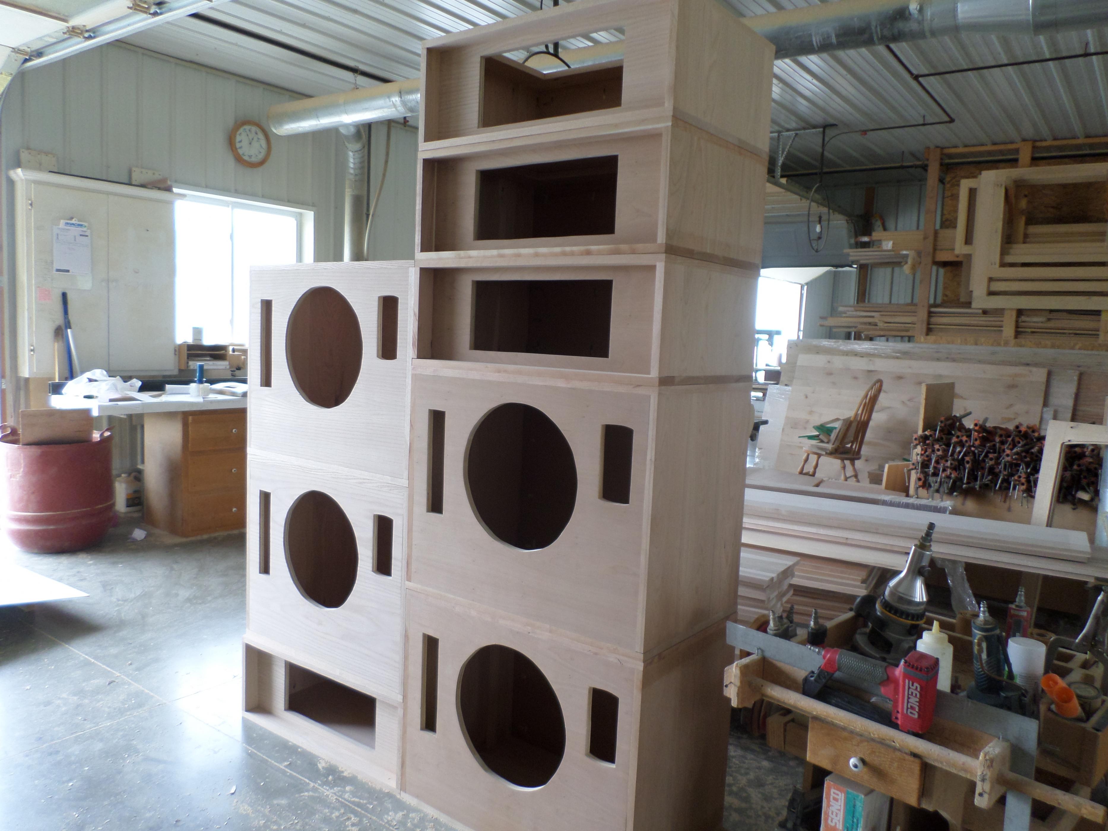

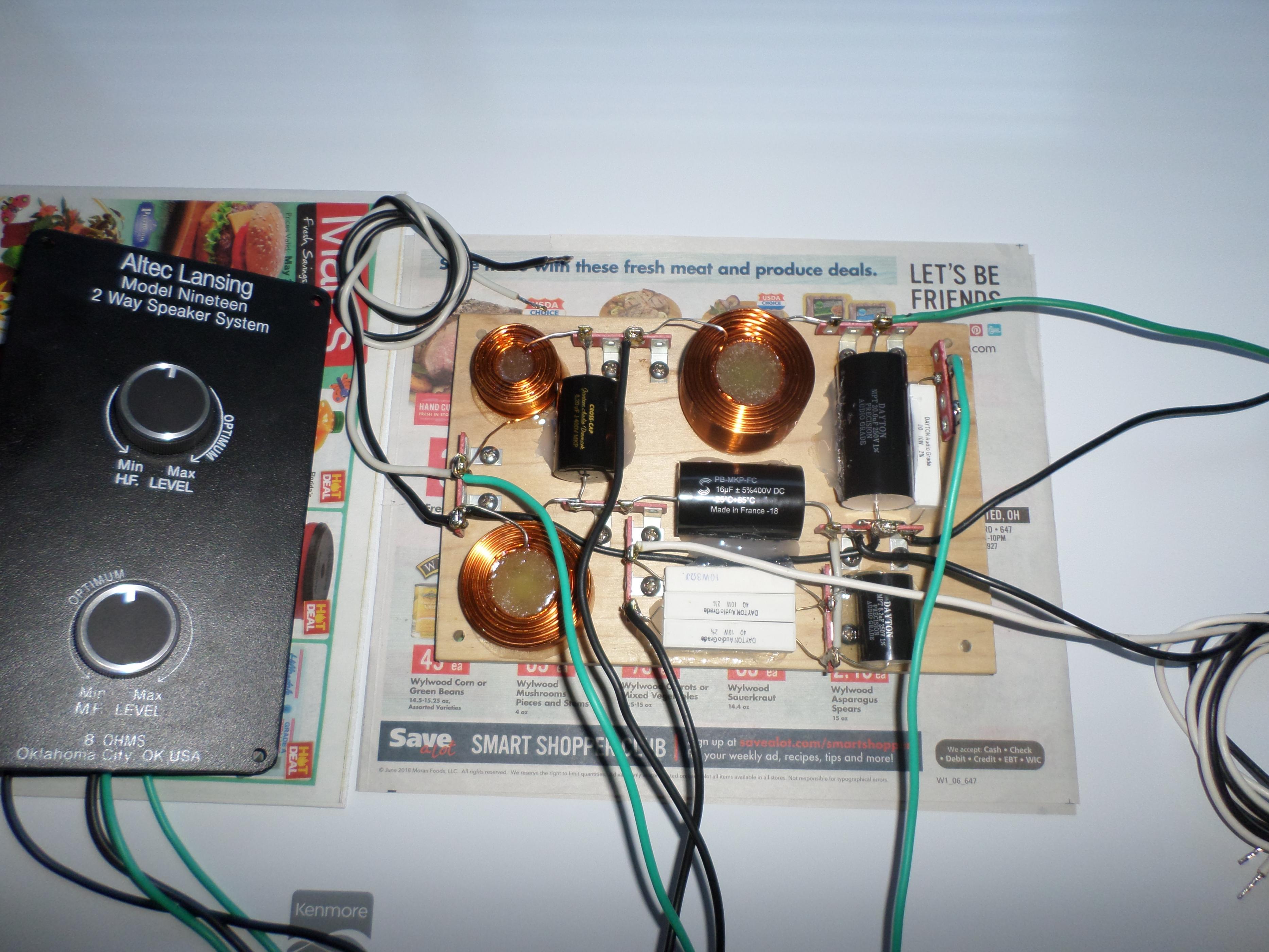

ALtec lansing Model 19 home built crossover.
I am building 2 sets of Altec Model 19s... and on 1 set.. I decided to build the crossovers...
its always more work than you think...but its going to work !.

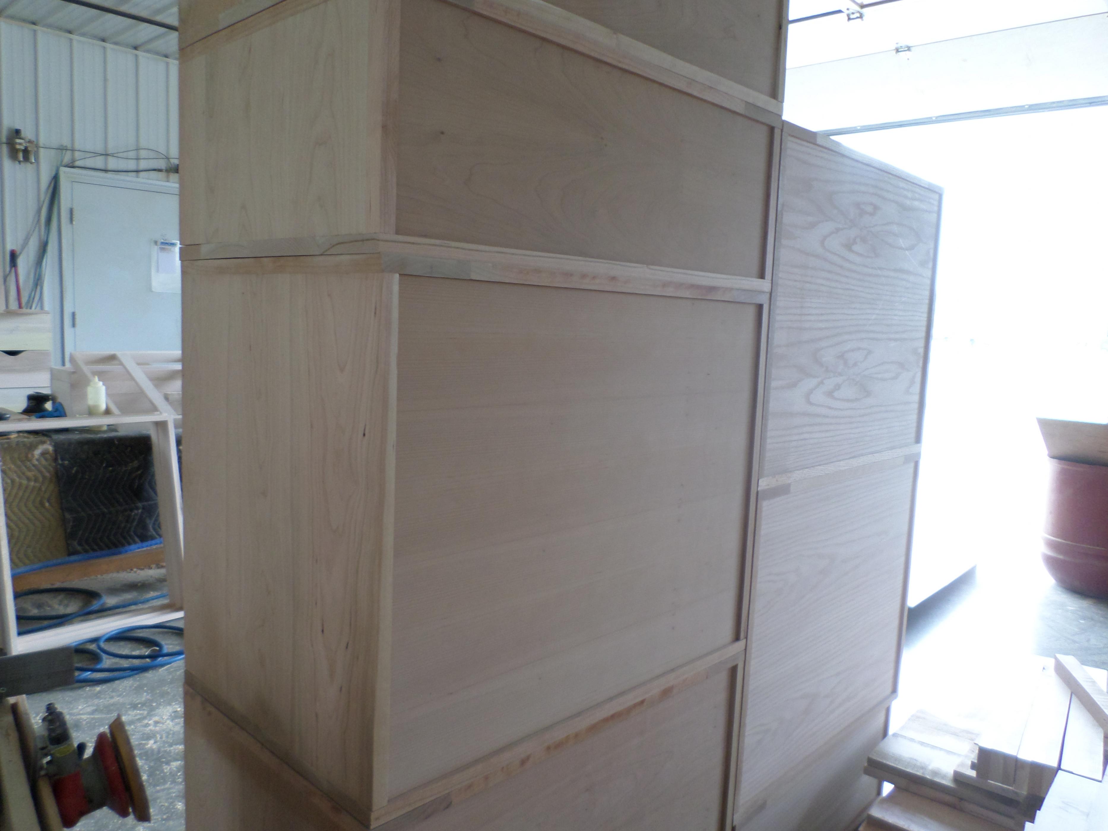

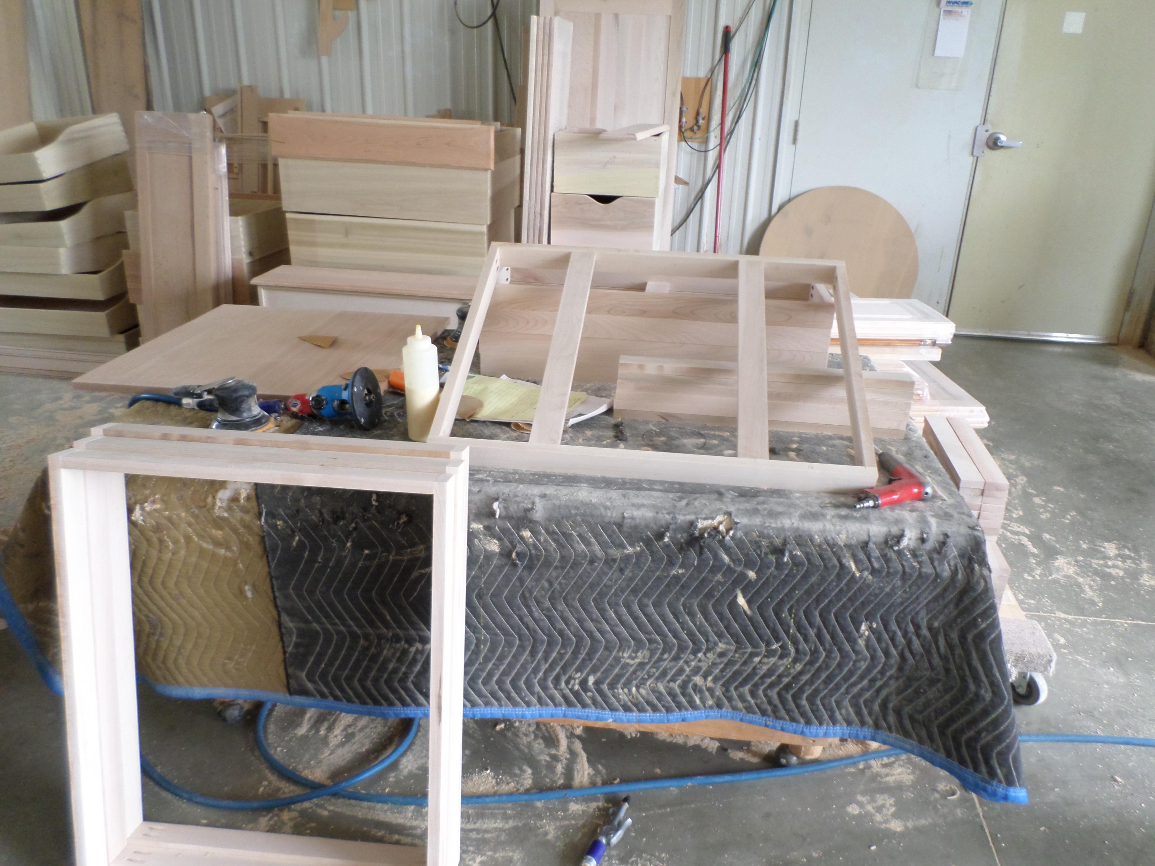

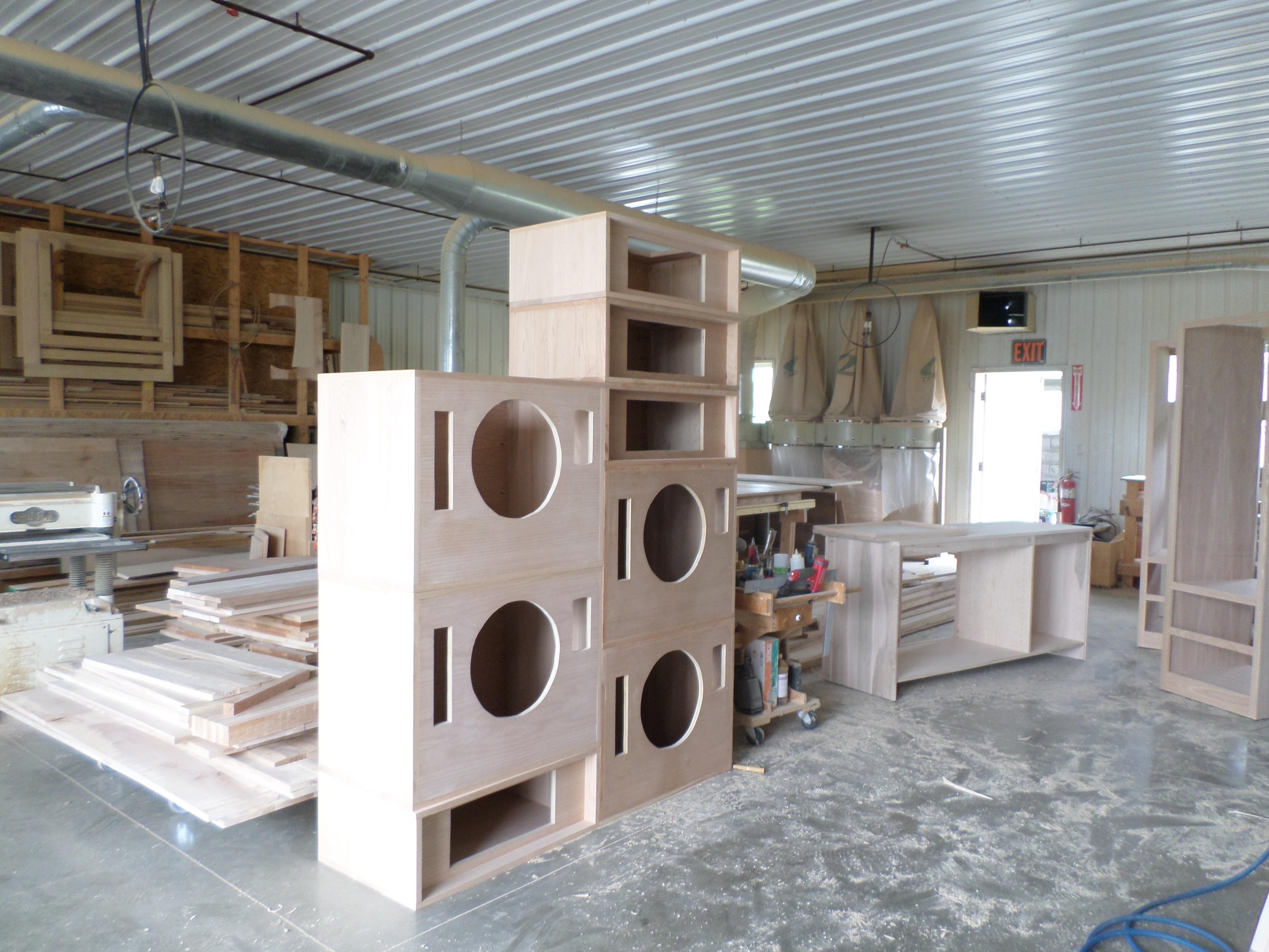

Altec 19 cabinets.. 1 set Cherry ,,1 set Oak
here is a few photos of the speakers I am building..
I will post the finished photos sometime in mid July.
