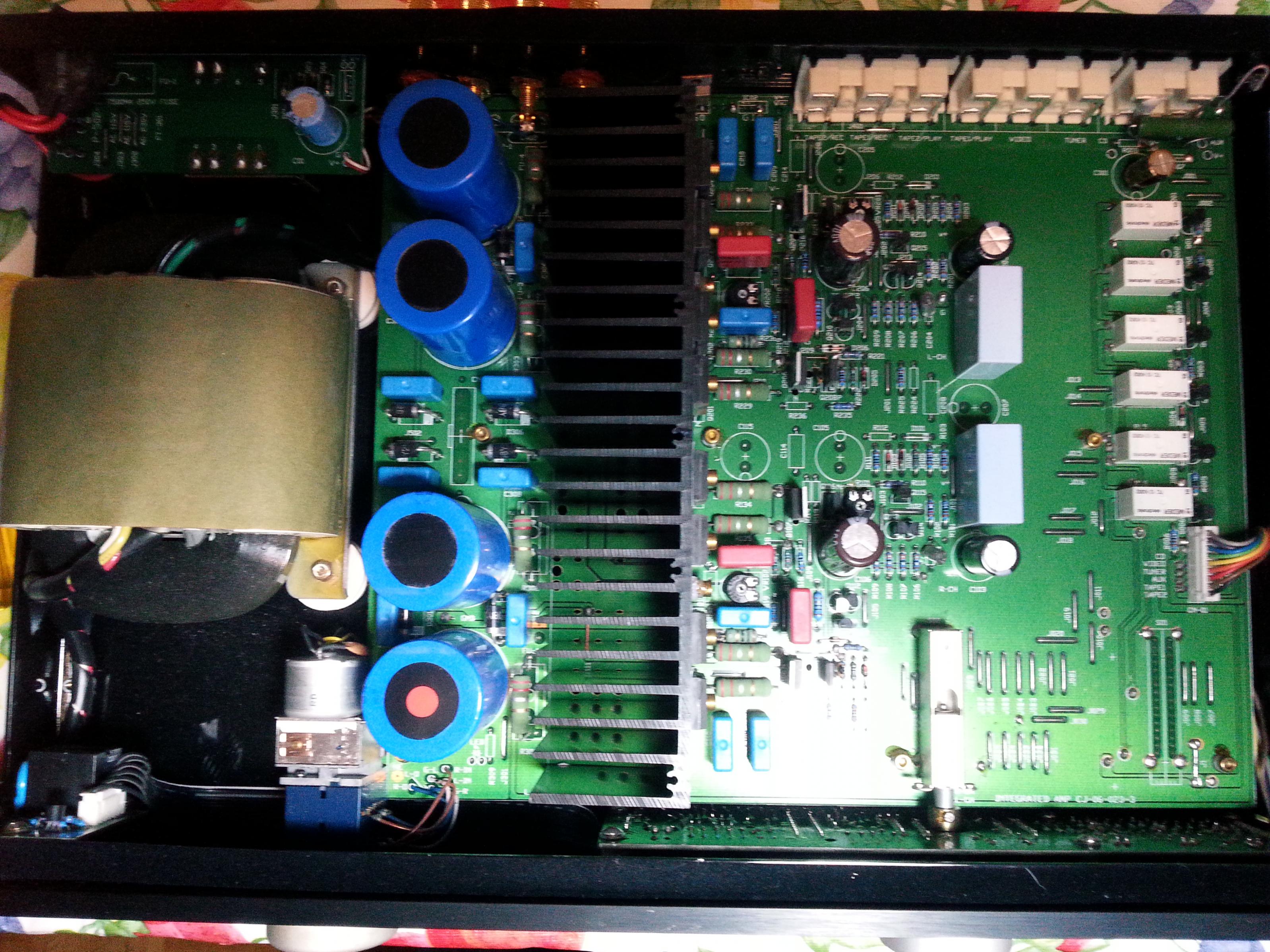

I have an Audio Refinement integrated amp with a level imbalance. The right channel is noticeably louder than the left. I traced the problem to the motorized pot.
The right channel also goes into cilpping a little before the left which makes sense, it works perfectly well other wise. Seeing this is a 20year old amp, I think it`ll be next to impossible to find a replacement pot. There is a part number on it 742t 100K AX2 but a search of that didnt come up with any hits.
I found one that is nearly identical differing only in the shaft. The one I need is a rather short split and knurled type while the replacement looks like it has a split but its longer and isn't knurled.
Alps 100K Blue Velvet, Stereo Motorized Potentiometer
In the event that a suitable replacement doesnt exist, would it be possible to repair this one or perhaps add some resistors to compensate for the gain mismatch?
Many thanks in advance.

The clipping was experienced only on a scope and not on a speaker 🙂
Due to it`s position, it`s extremely difficult to take accurate measurements of the pots but I did measure abnormalities.
Shunting both wipers results in equal volume on both channels.
The pot is literally hard-wired to the mother board by means of thin, solid wire that I dont want to disturb needlessly. I would have to remove the entire board if a wire snapped and I really dont want to do that.

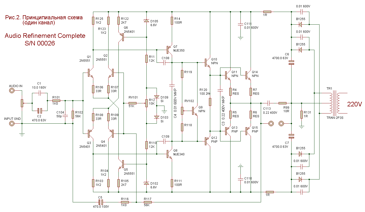

The closest thing to a schematic is something I found online.

In principle, increasing R101 on your schematic would lower the input voltage for the loudest channel (because R101 and R102 form a voltage divider), but whether it gives any other audible differences I am not sure (don't think so). However, you'd need measurements to verify how much to drop the input.
Oh, and the fix will be the same across the whole gang range of the pot, whereas the gang error might not be, so not 100% it's worth the effort to be honest - but YMMV.

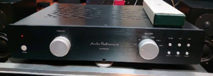

I just placed an order for a new pot/motor assembly. I`m debating whether to continue the split on the solid shaft some more and then cutting it down to size or leaving it as is and tap a hole into the knob for a set screw however, it`s large and solid metal.
I`ll have a better idea when it arrives from Germany, hopefully soon.
