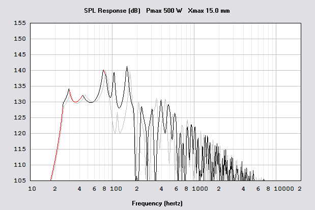

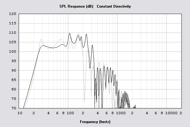

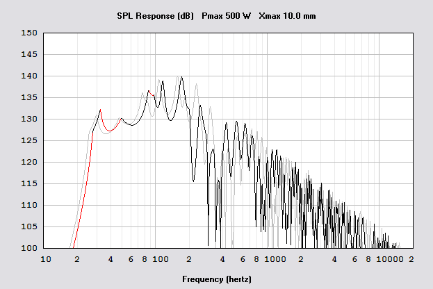

Agreed, here's the corrected one [shaded] @ ~636.602 L Vs mine @ ~431.632 L and at 500 W. Not much useful SPL gained for 200+ extra liters:

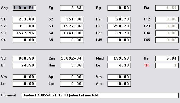

Final few questions on this design:
1) Is the 2.6:1 ratio above reasonable? Since it's a fairly lightweight pro-audio cone, I can go to something lower at the expense of a little more raggedness in the response. (seen below is a revision that lowers this a bit, at the expense of smooth response. 1.89:1)
2) Is an S3 of something like 1.2 * Sd Large enough? When I raised the S2, this was a result that worked well to smooth the response slightly as well as made the box even smaller. The final mouth is still over 2*Sd, yet that segment is quite short. (40cm). (S3=1036cm^2)
Seen below is these changes as well as a few others that help fit my physical dimensions. It has a slight roll off but I'm sure that will be supplemented by room gain. The other problem is the dip at 120hz, though it may be far enough away from the crossover freq not to make a huge difference.

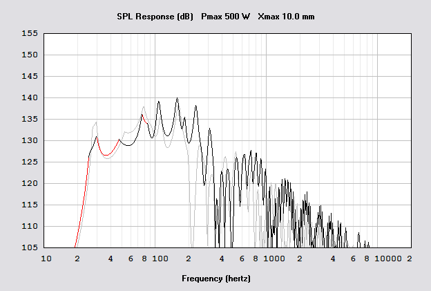

When yours is converted to a true single fold with a divider board, like shown in post #21, the net Vb 'grows' between S1, S4 due to this type layout being a parabolic expansion. Open yours in the wizard and click the S2, S3 'manual' to 'auto' and it will convert it to parabolic, which significantly increases net Vb.
That said, I just noticed the big offset between S1, S2 isn’t shown in post #21, so working backward from S2………. I get a 2.2 conic Fta, then converting to Par and using the wizard to get S2 back to ~351 cm^2 equates to ~361.889 L.
Now mine and your sims are much closer with my larger one going a bit lower and extending a little higher to account for its ~70 extra liters.

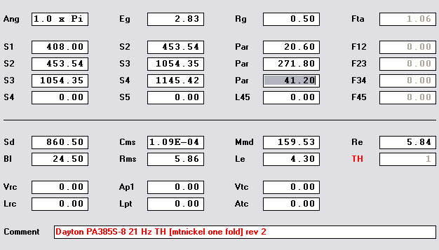

Again, this type layout doesn't fit your simple single fold. The expansion must be linear from S1-S4, i.e. have a parabolic expansion. Your corrected original is fine if it fits in your max dimensions.
When I convert this one by working backward from S2………. I get a 1.3 conic Fta, then converting to Par and using the wizard to get S2 back to ~453 cm^2 equates to ~259.111 L, so won't have as much gain BW as the larger one, but still a viable design.

Thanks for the explanation GM. Space isn't really an issue, I came up with that Sim mainly trying to decrease the compression ratio as well as I could. And my design doesn't need to be a perfect 1 fold as I showed in the diagram S4 can be variable and so can l34.
Any thoughts on the compression ratio?

Understood, but was trying to keep it simple since we got to get the basics right first. 😉
Tom Danley says around 3:1 is the limit in prosound apps, though some of his designs are 1:1, so with no personal experience with THs, I suggest you browse for builds with feedback on performance and see what CR @ S2 was used.

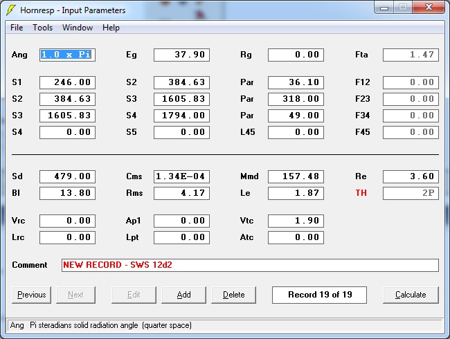

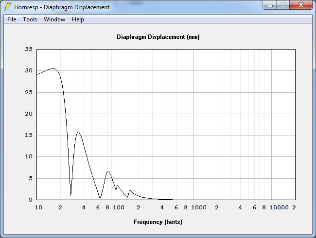

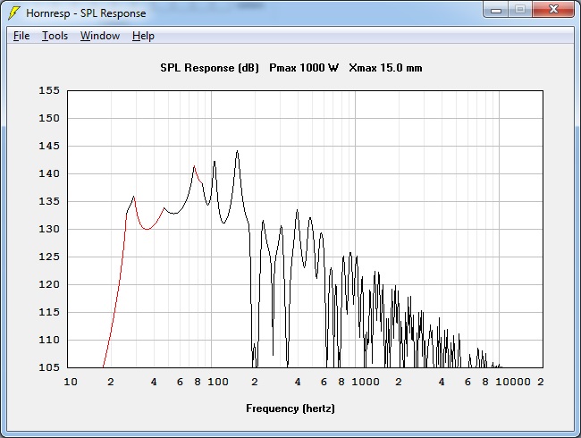

Ok, I was about to pull the trigger but again with my craigslist searches found a pair of Alpine SWS-12D2. With a reasonably higher FS these model better than the 15. Was thinking of just a pair of these. Somewhat more ragged response, but about $60 less in driver cost for me along with more confidence in 2 12" auto cones vs 1 PA 15" cone (for high SPL compression distortion). They extend a fair bit lower as well.
Anyone have preference of these vs the single 15" Dayton? Again they are local and I can pick them up tonight which is a big plus for me. I live in Canada and our dollar is tanking not to mention having to drive across the line to get my US purchases.

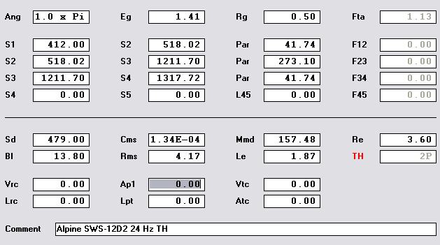

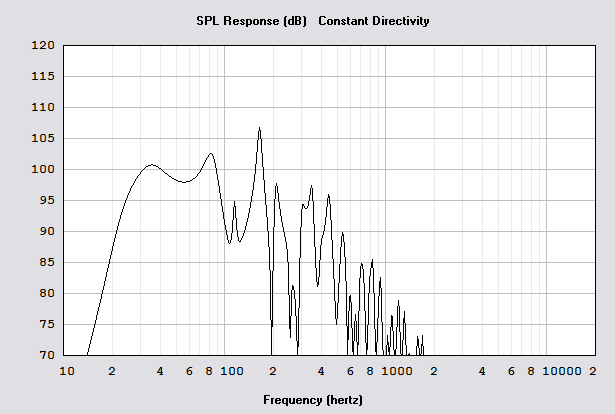

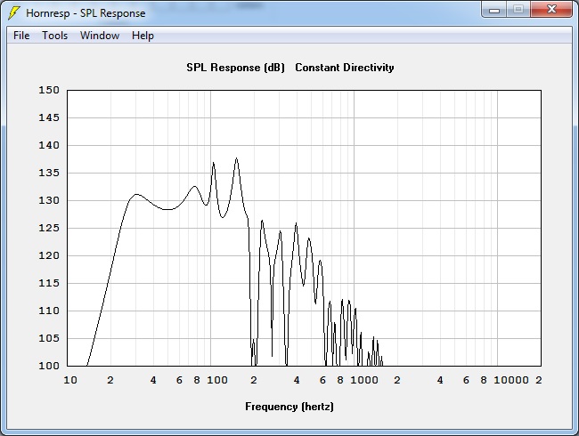

It’s more under-damped, so better suited to a TL or even tapped pipe [TP] to my way of thinking, but with no hands on experience with THs beyond auditioning a few commercial prosound ones with presumably much lower Qt drivers…………
Indeed, when ‘running the numbers’, I got a non-typical response, though at 500 W its response is near enough audibly identical with yours except for its ~unusable HF BW, so considering your stated XO point, mine at ~103 L smaller [308.392 Vs 411.162 L] seems the one to experiment with, especially since it’s a simple parabolic fold rather then your three different expansions alignment.
