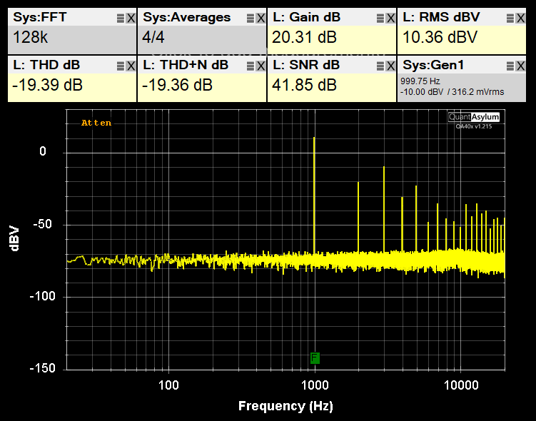

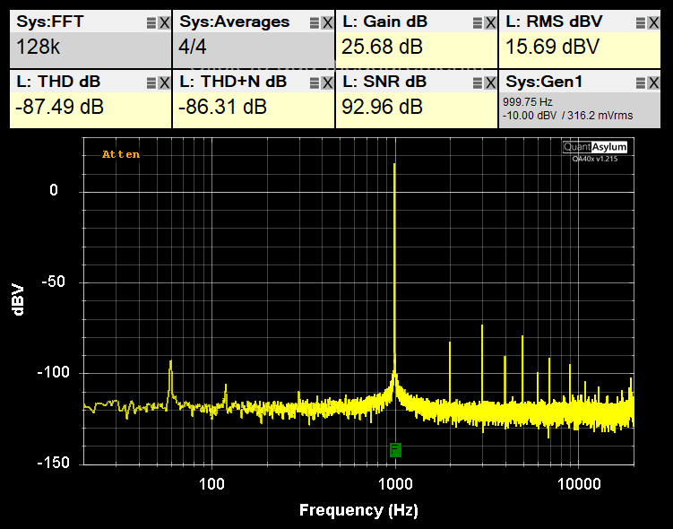

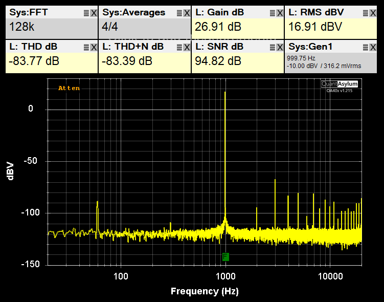

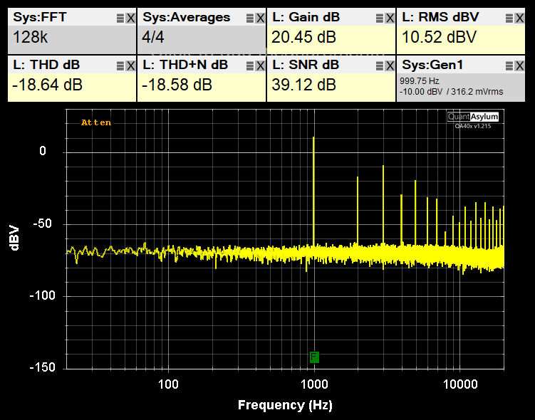

I recently purchased a Quant Asylum QA403 audio analyzer because I own a fair bit of old home and car audio equipment and I want to learn how to troubleshoot and repair them myself. All of the reputable repair shops in my area shut down long ago. I am a EE but I have not worked with analog circuits in decades. I am still learnoing how to use the QA403 but I thought I would post some screen shots from tests I have run on these amps, These are mostly THD plots at 1 kHz. It is readily apparent which channels are working and which are not. You can see a small peak at 60 Hz from the AC line feeding my power supply. First plot is a good channel. Second plot is a bad channel. All the bad channels look like this on both amps.

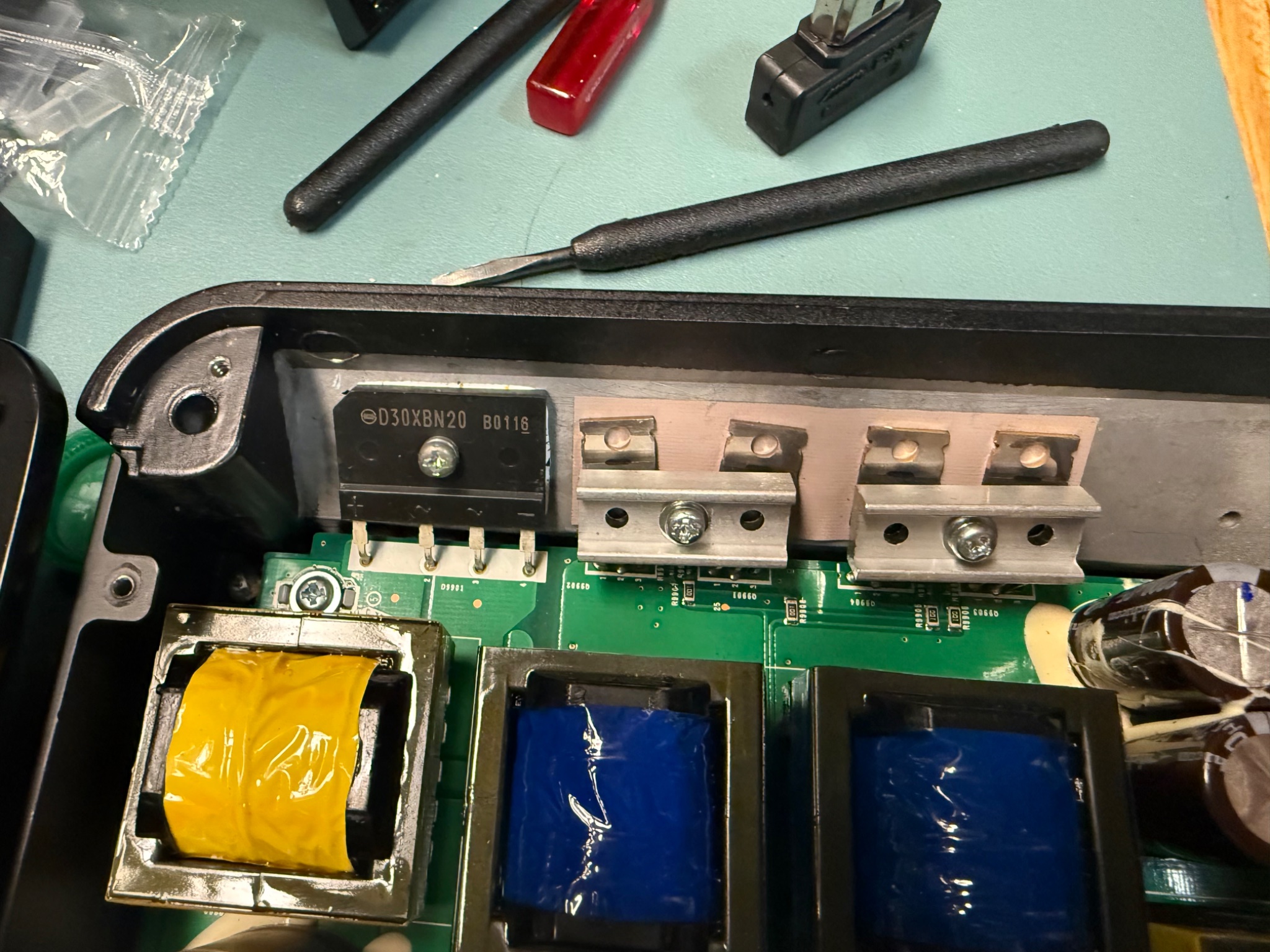

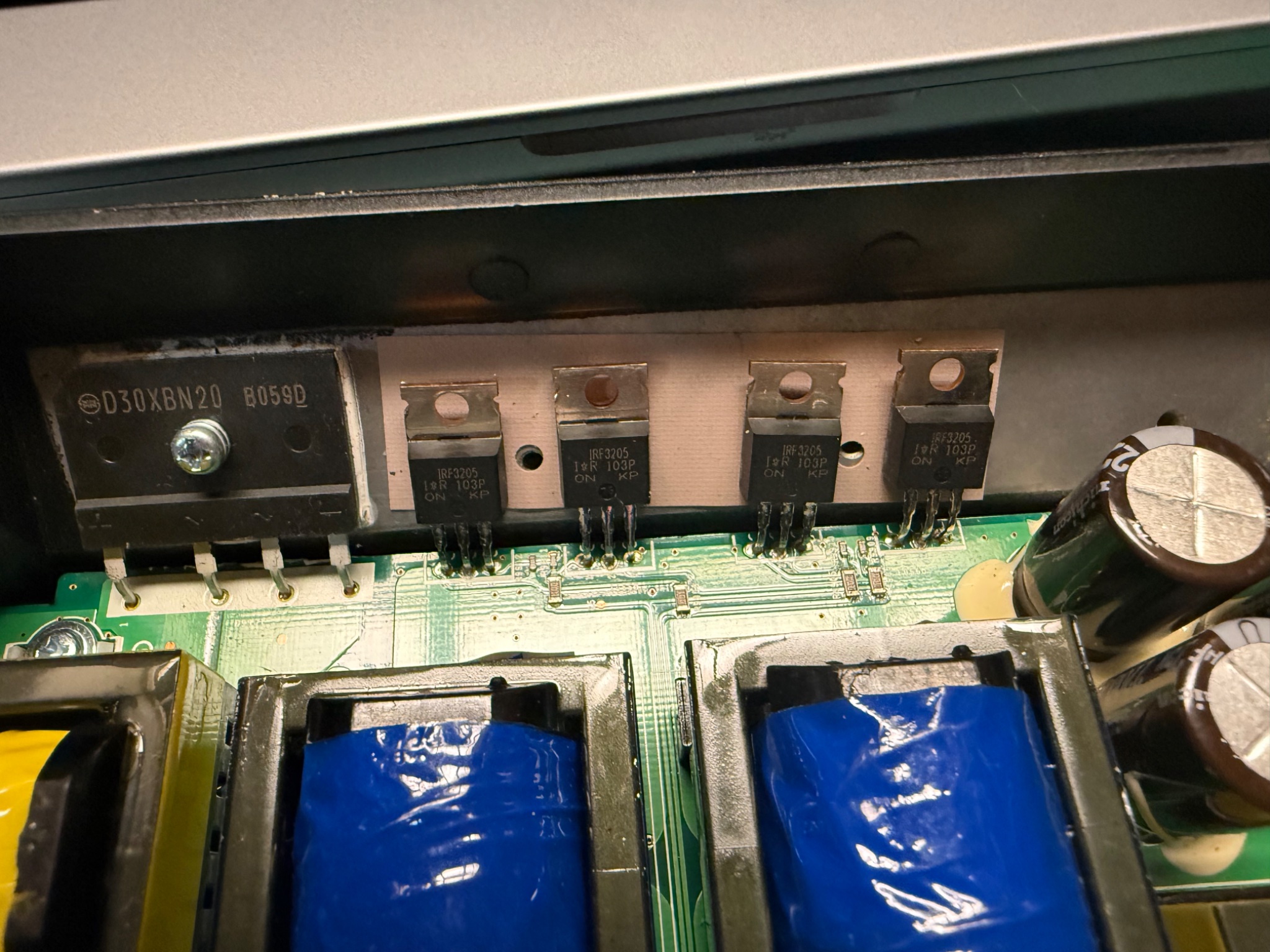

PAC Parts only has one in stock today. I figure the first step is to replace the cables before going further. Luckily, I found a thread on DIY Mobile Audio about PDX F9 amps that gave me clues about finding a generic replacement. I ordered some 14 pin 0.5 pitch flat flexible cables from Mouser that are much less expensive than the Alpine part. I ordered 3 different variants to experiment with. I also ordered a service manual from PAC Parts.

It's odd that the noise is higher across the board.

I went back and retested the amp from Japan. Channels 1-3 look good. Channel 4 has the high noise floor like the trace I already posted. I used the same connector for each test run.
The other PDX has the same problem on 2 of its channels so whatever it is, this appears to be a common fault. That is what led me to guess the ribbon cables are bad.
The seller in Japan is one I have bought stuff from in the past and he has been accurate in his descriptions of the equipment he sells. The lower cost amp was purchased from a Pawn shop seller on Long Island who said it was in good condition and for $160 I was willing to take the risk.
The other thing I did not mention is that on the good channels, my portable OWON scope is able to sync to the sine wave of the test tone and it is a fairly clean looking waveform. On the bad channels, there is so much noise, the scope is not able to sync on anything even though there is a 1 kHz test tone you can see in the plot from the QA403.
I am saying this because to me, that means a signal is coming through that circuit from input to output but it has a ton of noise.
