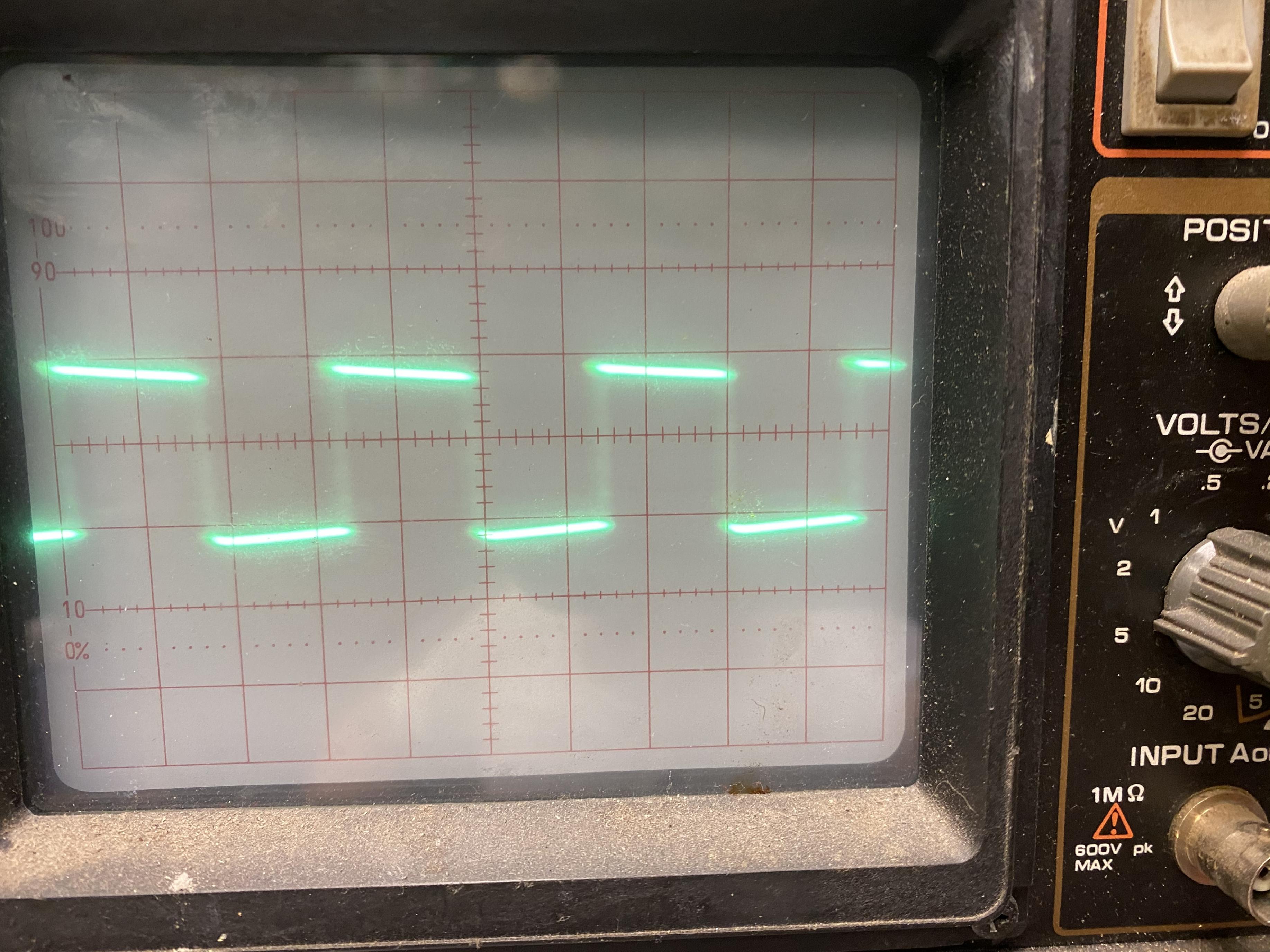

Replaced the diode and checked other components and they test fine .
I still don’t get any regulated voltages .
I noticed non of the regulators have input voltage

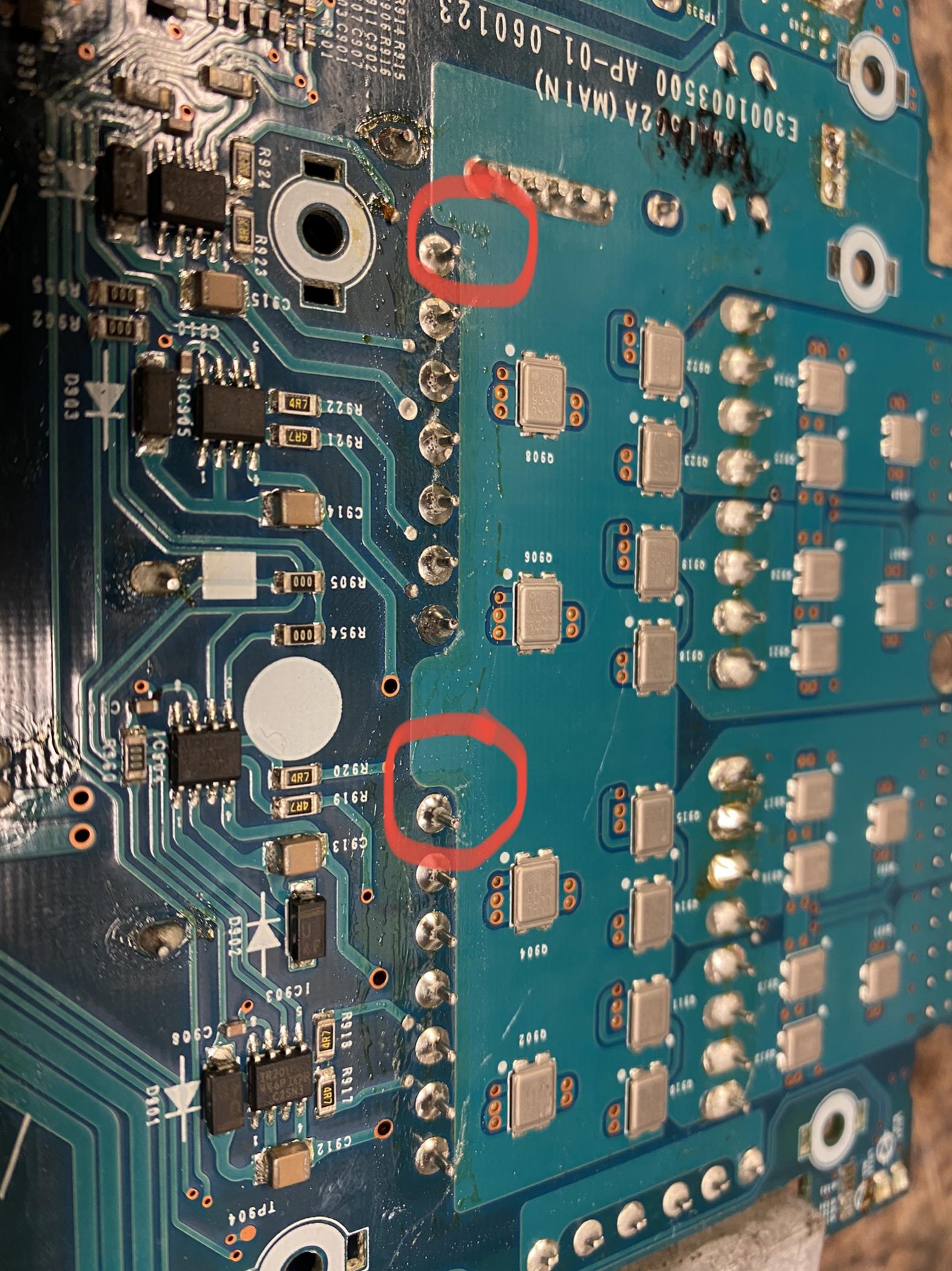

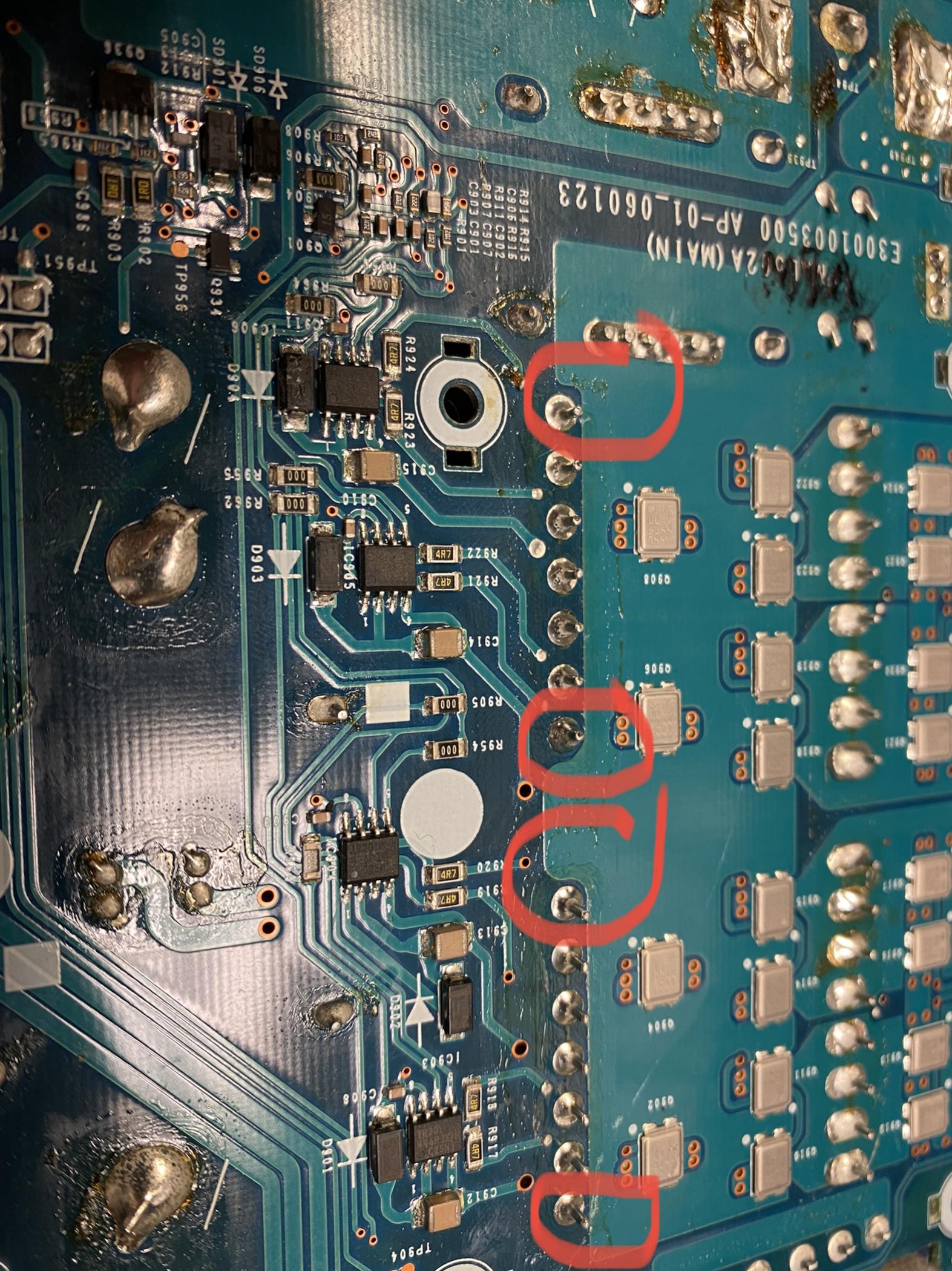

The transformers have 8 terminals on the primary and 7 on the secondary. Confirm that you read 0 ohms between all of the secondary windings. Do this for both transformers.
I mis spoke in the last post .
Rechecking again here is what I get .
From the pins circled in the pic I only get OL on the meter to all other pins on each transformer . So I don’t get 0 ohms from those pins to any other pin on the secondary .
All of the other pins have 0 ohms between them
And yes the pins connect to those diodes
So in other words unless I rip them apart or get new ones the amp is basically garbage .
In your opinion is it even worth trying to repair ?
