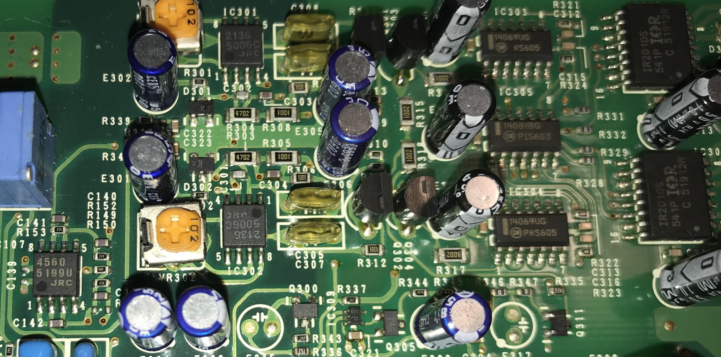

Hi All,
I have spent hours looking and measuring this amp and am still no closer to solving this. As a reference I am using the MRD-M1005 Service Manual and schematic, which is a very similar.
I can see a triangle wave on the output of both the NJM2136 (pin6), once I have the amp started up with a high volume input, but it will not start when remote is applied initially.
Can anyone explain to me how the clock is generated and what could cause this behavior?
Steps that I have taken:
- Power Supply Working as normal, generating both +-32V Rails, +-15V Analog and +- 5V used by the NJM2136.
- Measured all the supply voltages to all the operational amplifiers, all normal
- I even re soldered all the through hole components around the NJM2136, since some of those film capacitors I thought may have been part of the oscillating circuit.

NJM2136 Measurements
The triangle wave is about 0.5V peak to peak (not as large as I would have tough) and is offset on -2.0V. It looks a little noisy (if I am grounded on the battery ground), but if I ground to the A_GND it is fine.
Before Oscillation
For the NJM2136:
P1: 5.0V
P2: -0.2V
P3: 0.00V
P4: -5.0V
P5: Did not measure
P6: 4.2V
P7: 5.0V
P8: 5.0V
With no oscillation, there is no signal leading to the TC4069s and the IR2010S drivers do nothing.
Once Oscillating
P6: -2.0V with 0.5V ptp triangle wave.
The signal entering the TC4069s are initially really small on pin 1 and then as it propagates through the gates the signal gets larger and squares off.
I am used to the audio coming in on the one input of the OPAMP and the triangle wave on the other pin and it being used as a comparitor to create the PWM. Here the non-inverting input seems to be connected to the A_GND, so is the integration happening in Q301 - Q304?
Apologies if I am completely lost.

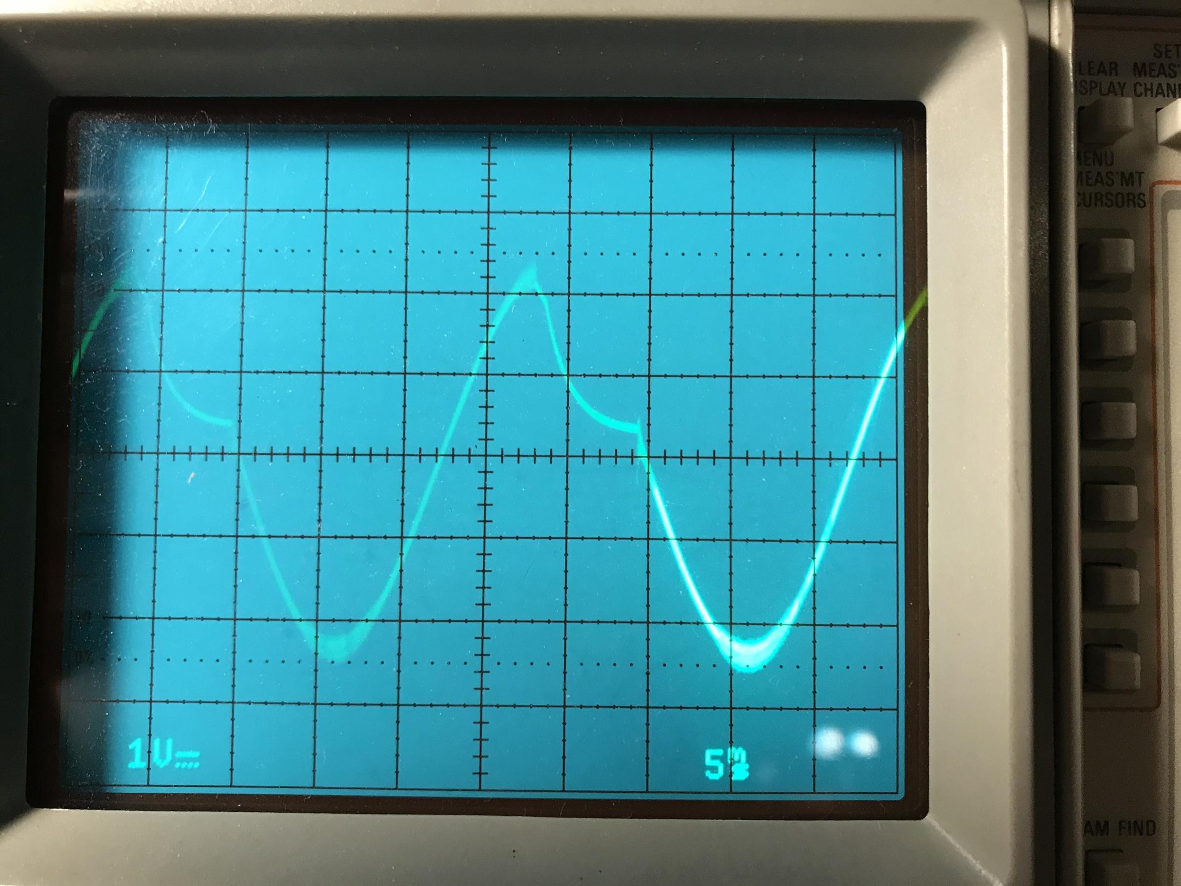

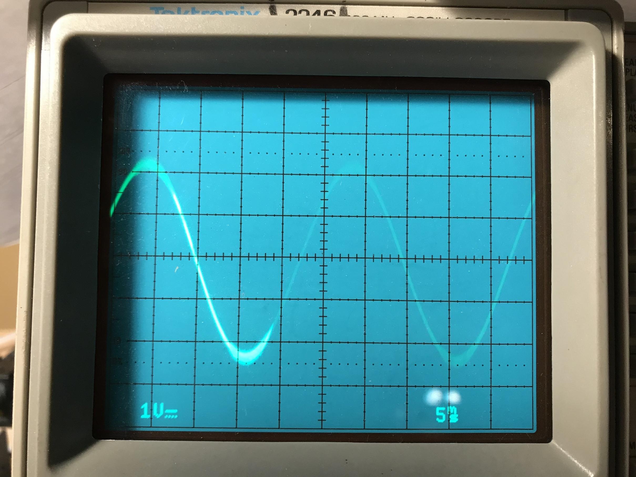

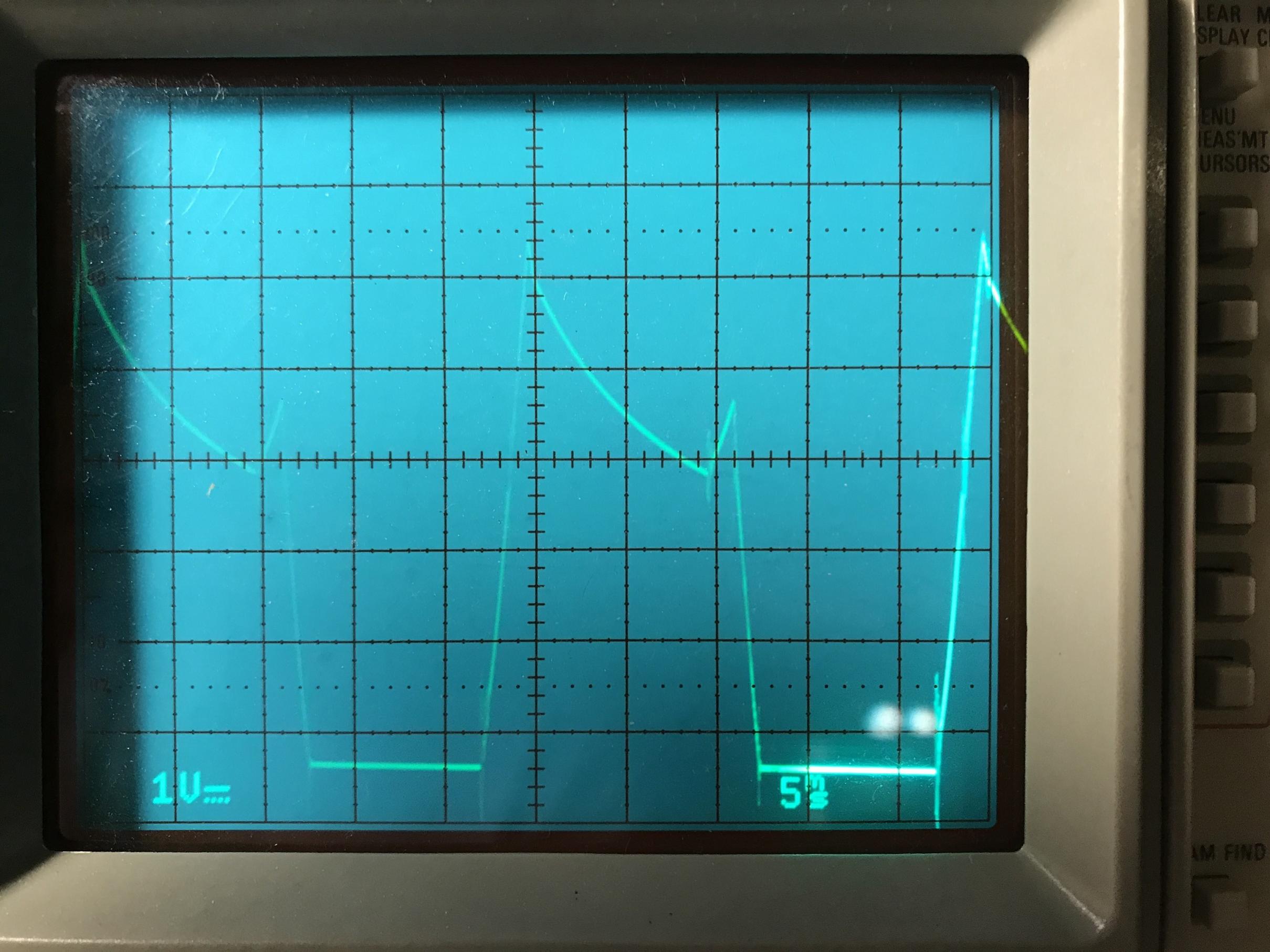

Have a look at the output of the amp, this may also be a clue to the problem.
It seems like the amp does not create a signal close to the rails, before part of the positive signal seem to get inverted. I observed this on both outputs, relative to ground. I know there are effectively two channels running in BTL configuration in this amp.
The first picture is before the onset of clipping (I am using a 10x probe) so about 40V peak to peak
The second one is where I am observing the positive portion of the signal inverting, as you can see the negative portion is just before clipping
The third picture is the amp clipping hard and the inversion is still present.
Is this the same on both the positive and negative speaker terminals?
If so, is the glitch on the positive half of both positive and negative speaker terminals?
Is the rail voltage solid when the signal dips.
This is sometimes what it looks like when the amp is in current limiting protection.
Yes, this is the same on both the positive and negative speaker terminals, relative to the main amp ground.
Yes, both positive half of both positive and negative speaker terminals
I do not know if the rail voltage is solid when the signal dips. I will add this to my list of things to check
This is with no load applied to the output and the amp is pulling about 1.5 amp when this happens. I guess the current limiting protection could be falsely activating up.

My list of things to check
- Measure the op-amp output leading into the PWM section
- Check the positive rail supply when I am observing the output inversion
- Check the over current protection circuit to see if it is activating
- The op-amp leading to the PWM section (IC107) has a clean output of 4V p-p when the output looks like the first picture. One section is non-inverting and the other op-amp is inverting also at the same amplitude. The signal on this op-amp remains distortion free until 8V p-p, when the signal from the op-amp starts to clip gently.
The signal amplitude remains very similar through a 1K resistor (R339 and R340). The signal then the signal pass through an electrolytic capacitor (E301 and E302), still with good signal strength and then through an 8.2K (R301 and R302), to the inverting input of the 2136 (pin2), where it is no longer visible, due to the op-amp action, I assume.
There is also limiting diodes D301 and D302 following the 8.2K to ground, which seem to be performing a limiting action, should the op-amp for some
reason not be able to control the signal on pin 2.
- When the output inverts like observed in the second and third picture, the positive supply remains completely stable.
