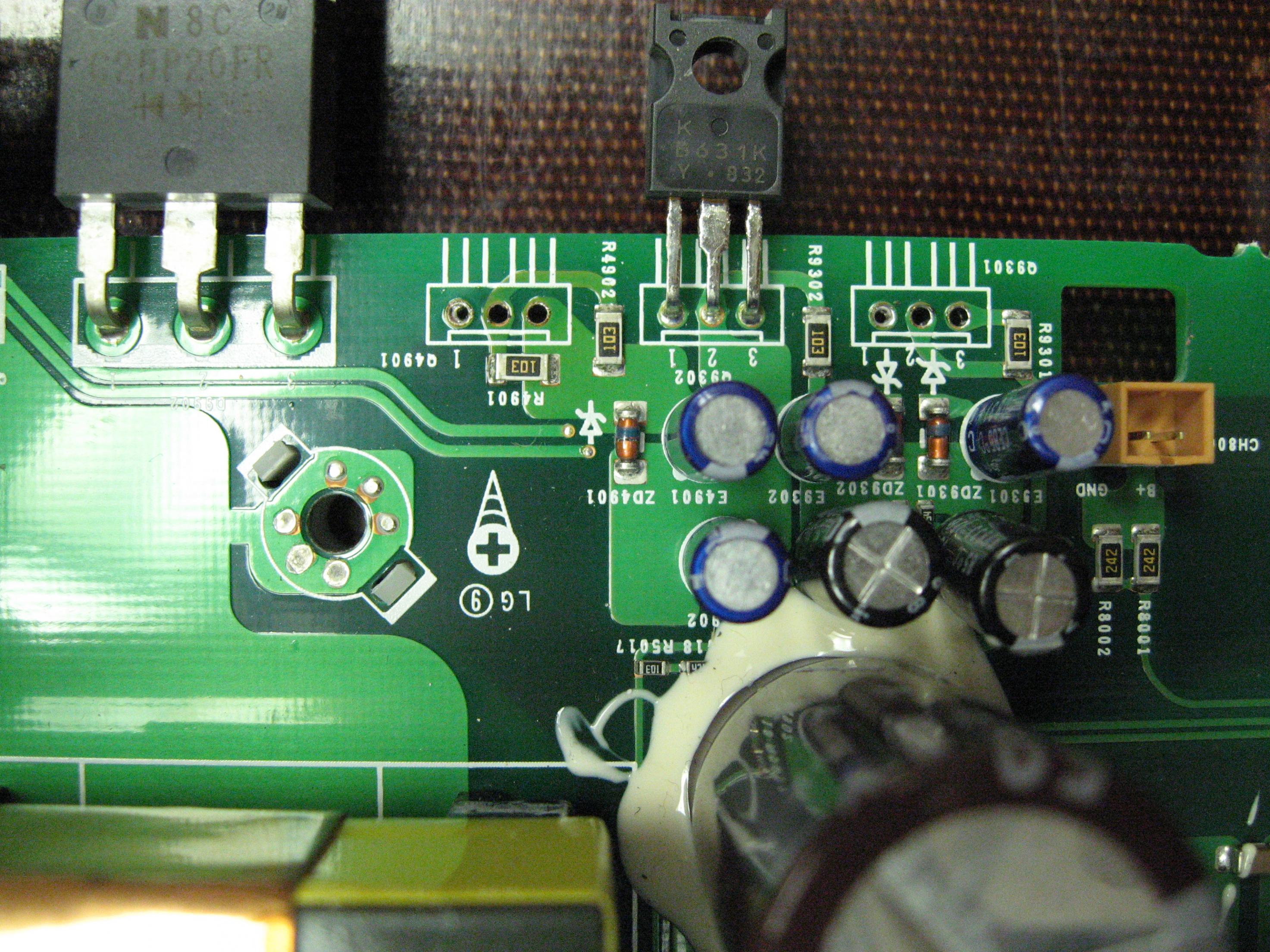

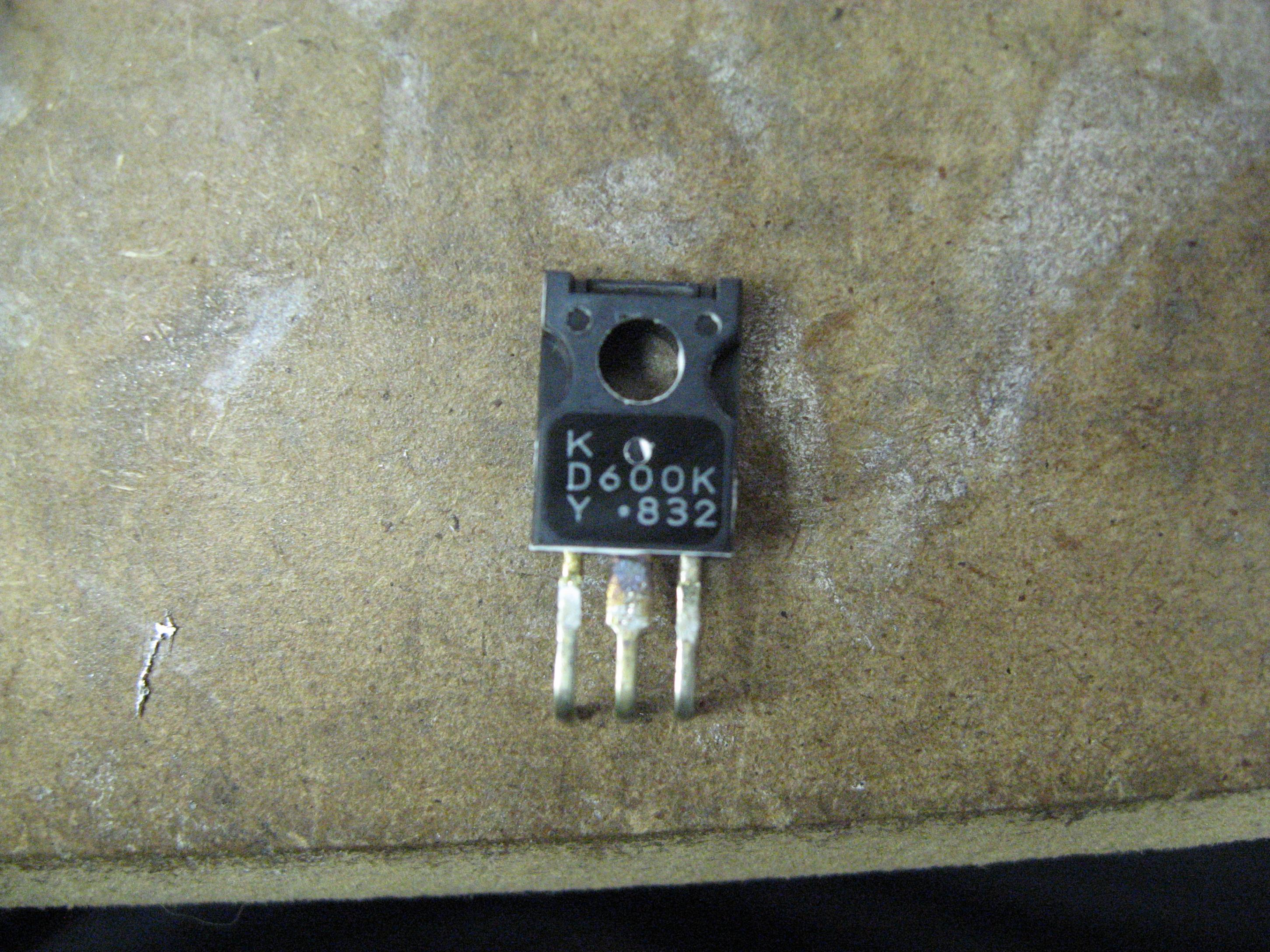

Perry I have one here (MRP-M1000) with Q4901 seems open on all legs (removed from board). Case has KD600K written on it. What is the exact part number? Where can I get another??? or is there a sub? Also you said possibly ZD4901 What part # is it? It seems to test fine in the circuit. Q3901 is good, I just removed it to use as a reference. Amp seemed to power up fine.. just had no output. And there was a small (-0.6 to -0.02vdc) voltage fluctuating up and down on the speaker terminals.

The KSA2690A should work but you'll need an insulator and heatsink compound.
http://datasheet.octopart.com/KSC2690AYS-Fairchild-Semiconductor-datasheet-33981.pdf
http://www2.kec.co.kr/data/databook/pdf/KTD/Eng/KTD600K.pdf
