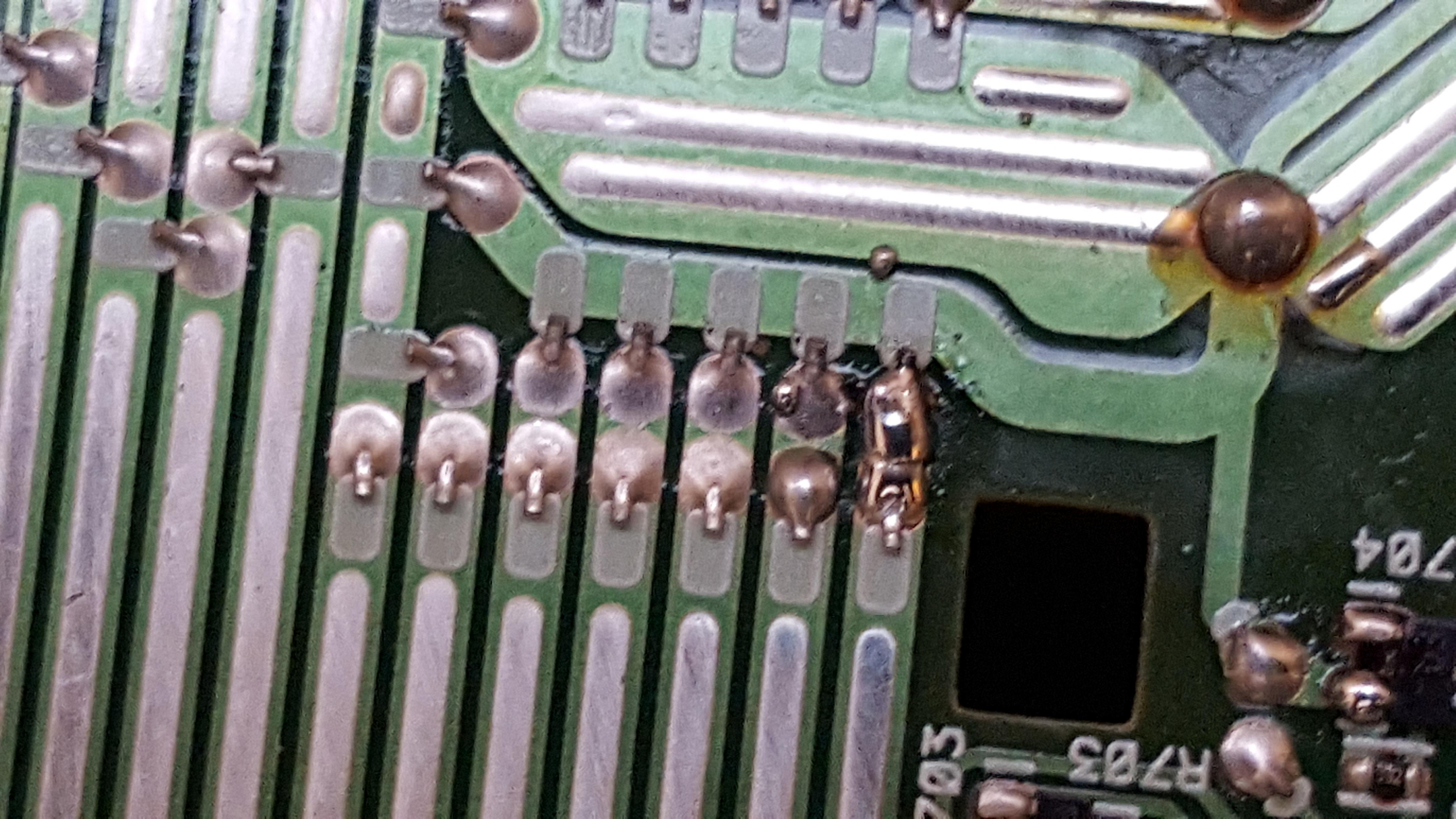

The amp is on the bench found the other 2 when jumped all 4 one at a time none cause the amp to work
Do you have a meter tor read capacitance?
Do you have any 2.2uf capacitors?
No I don't have any capacitor but my meter reads capacitance
While searching for q546 I found this in the picture attached, found out it came from one of the capacitor, soldered back the joint and the amp works again
I did that
It seems to be holding up so far, not sure what caused that at first, thank s for helping me out
