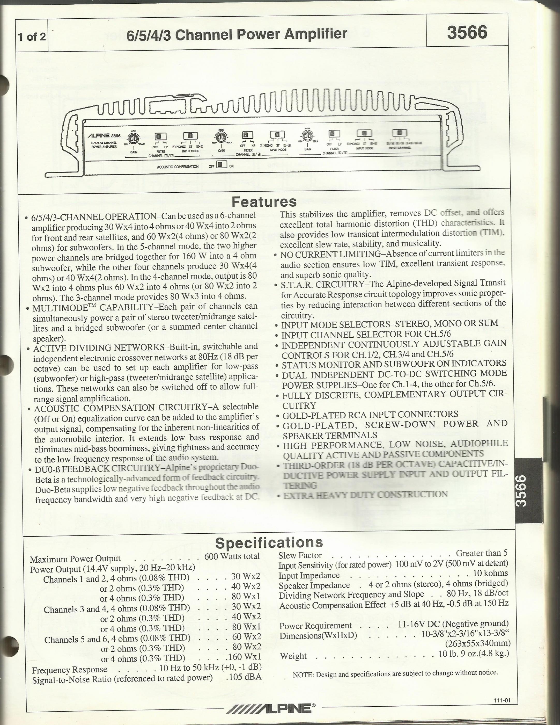

It's 30Wx4 plus 60Wx2, real power into 4 ohms. Into 2 ohms, it's 40Wx4 and 80Wx2. Bridged, channels 1+2 produce 80W into 4 ohms, same for channels 3+4. Channels 5&6 can be bridged for 160Wx1 into 4 ohms.

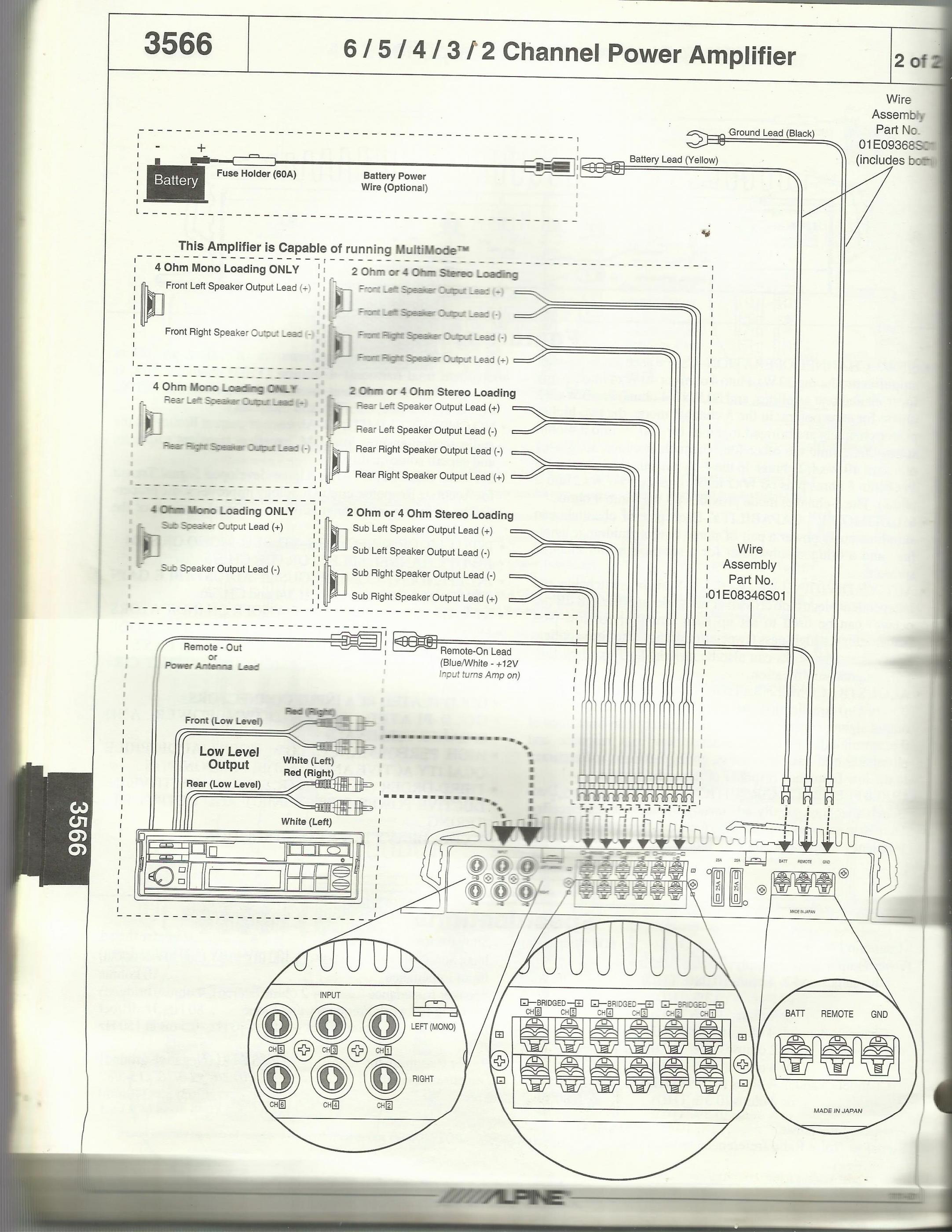

Alpine also stated 600W "Max Power" for this amp, with no THD, noise, or other notations whatsoever. Don't believe it, the usable power is listed above. I'll scan the spec sheet later and post it.
From the 1993 Product Technical Guide:
