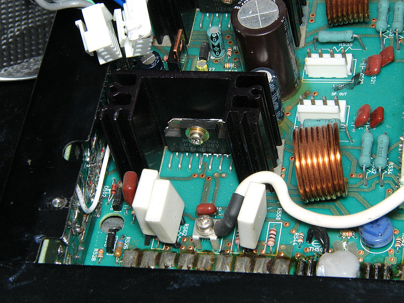

Ok got the board off the heatsink, the heatsink is machined just like you said.
I'm going to try to swap the IC's after i bought a new reel of desoldering wire.
So when I swap the IC's the high offset should swap from one channel to another?
Since both channel have a high offset shouldnt i replace both?

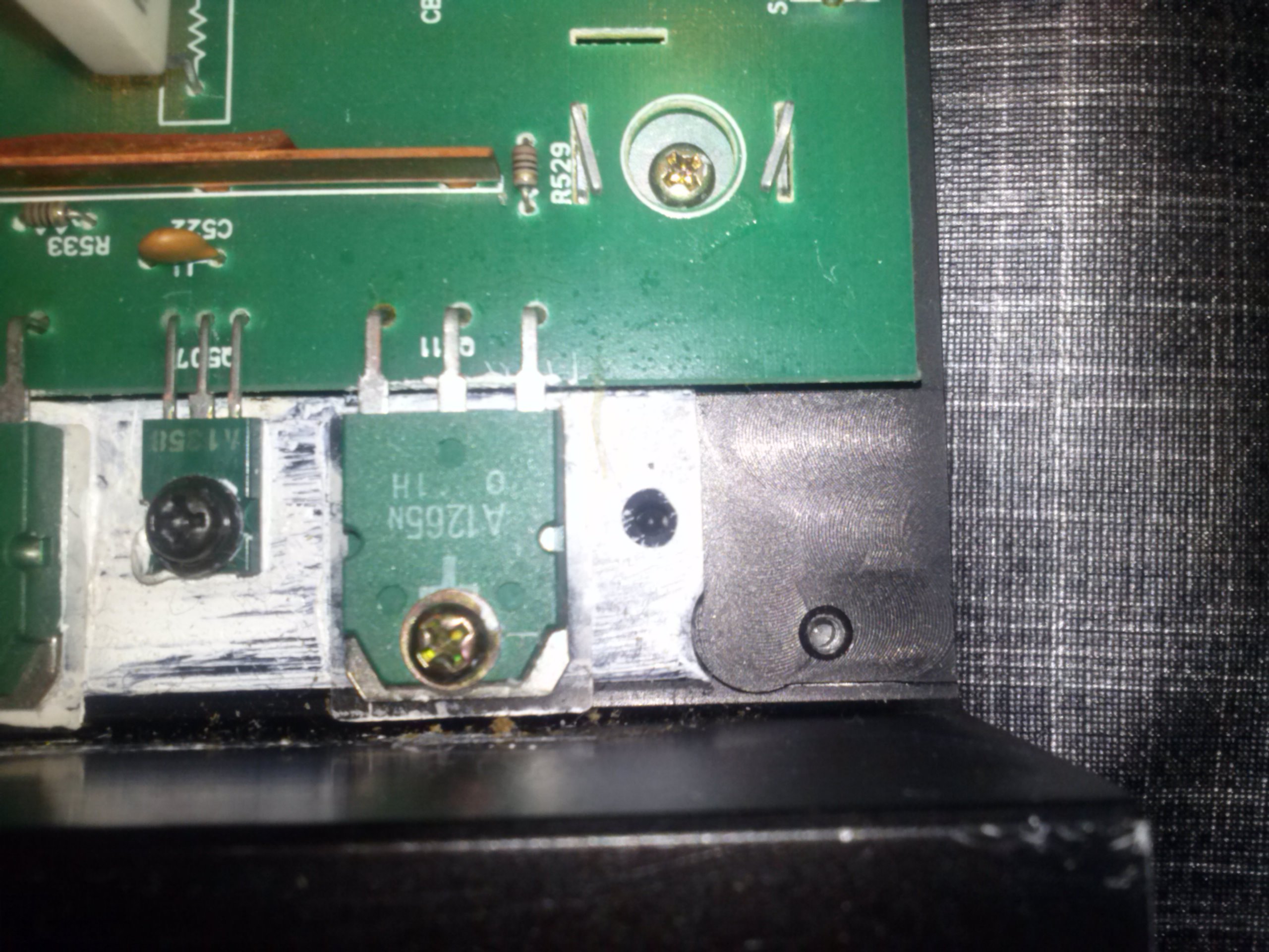

Should I swap the mica insulators when I put the transistors back or can I keep the old ones?
And how about the thermal compound?

Hopefully, the high DC offset will follow the IC. Don't get them mixed up.
Buying old type semiconductors/ICs from ebay is VERY risky. Too many are counterfeit or marked with the wrong part number (which means they're useless). I just purchased some UPC1318AV ICs from a reputable seller and all were mismarked. I don't know what they were but they were not the 1318.
The heatsink compound will need to be replaced before the amp is put back into service. The mica insulators can be reused.
Clamp the transistors down before applying power again.

There are three pots on the board one next to the transformer and 2 next to each IC can i use the ones next to the IC's?
The pot near the transformer is to set the rail voltage. The other two are idle current adjustments. Leave all of them as they are.
The DC offset pots would need to be added to the amp.
