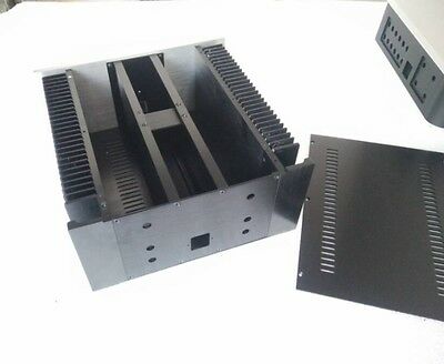

Neat setup - can you show us an oblique view so we can see the whole chassis front and heatsinks? Was it designed to have the clamshell concept of shielding the trafo in the middle? If you have a link where this chassis can be bought that might be of interest for others making this amp.

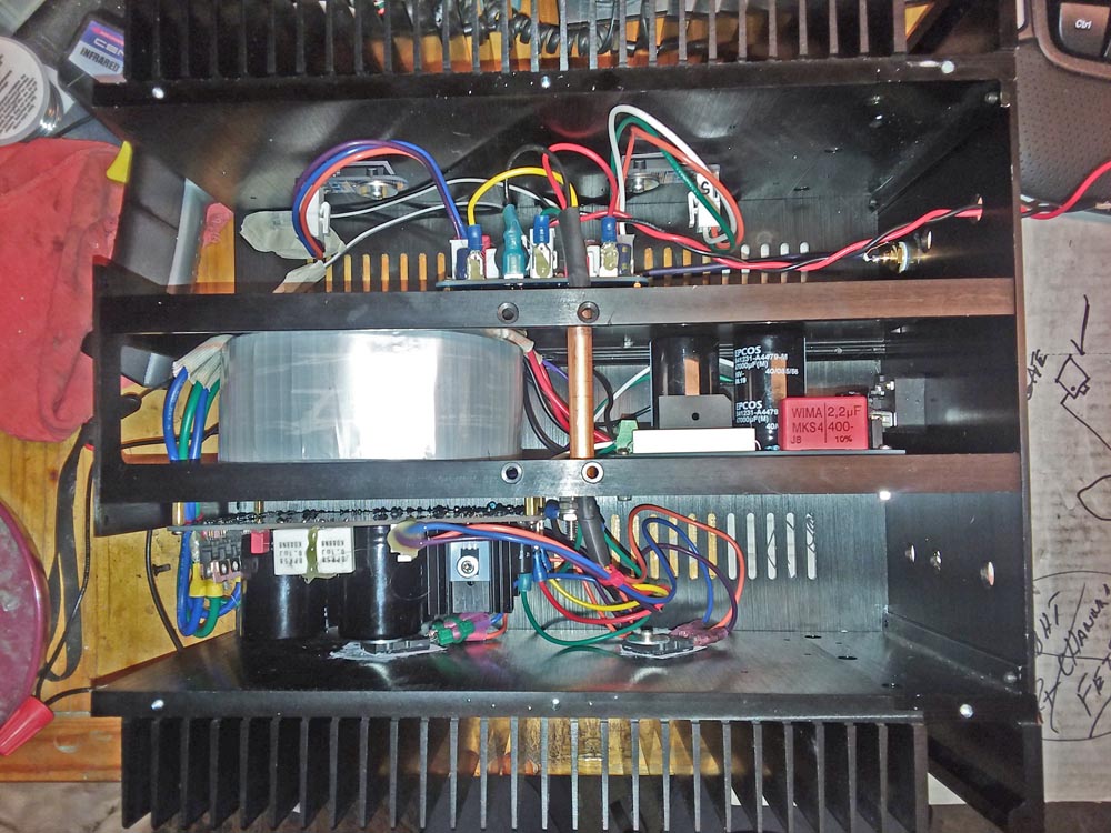

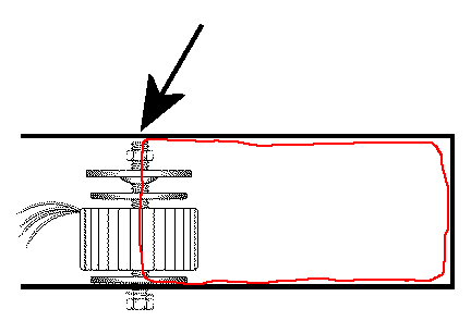

Hi JT,
How is your transformer mounted?
If it is bolted, it looks like it could make an additional single turn with the copper pipe.
This bolt, pipe and chassis becomes a shorted winding over the secondaries and will overload/overheat the primary,
until something melts, hopefully the fuse.

@ Danny , it's bonded to one side sitting off the metal, there is no bolt, but thanks for the concern, I would rather have you say something than not.

Chassis
Here ya go X

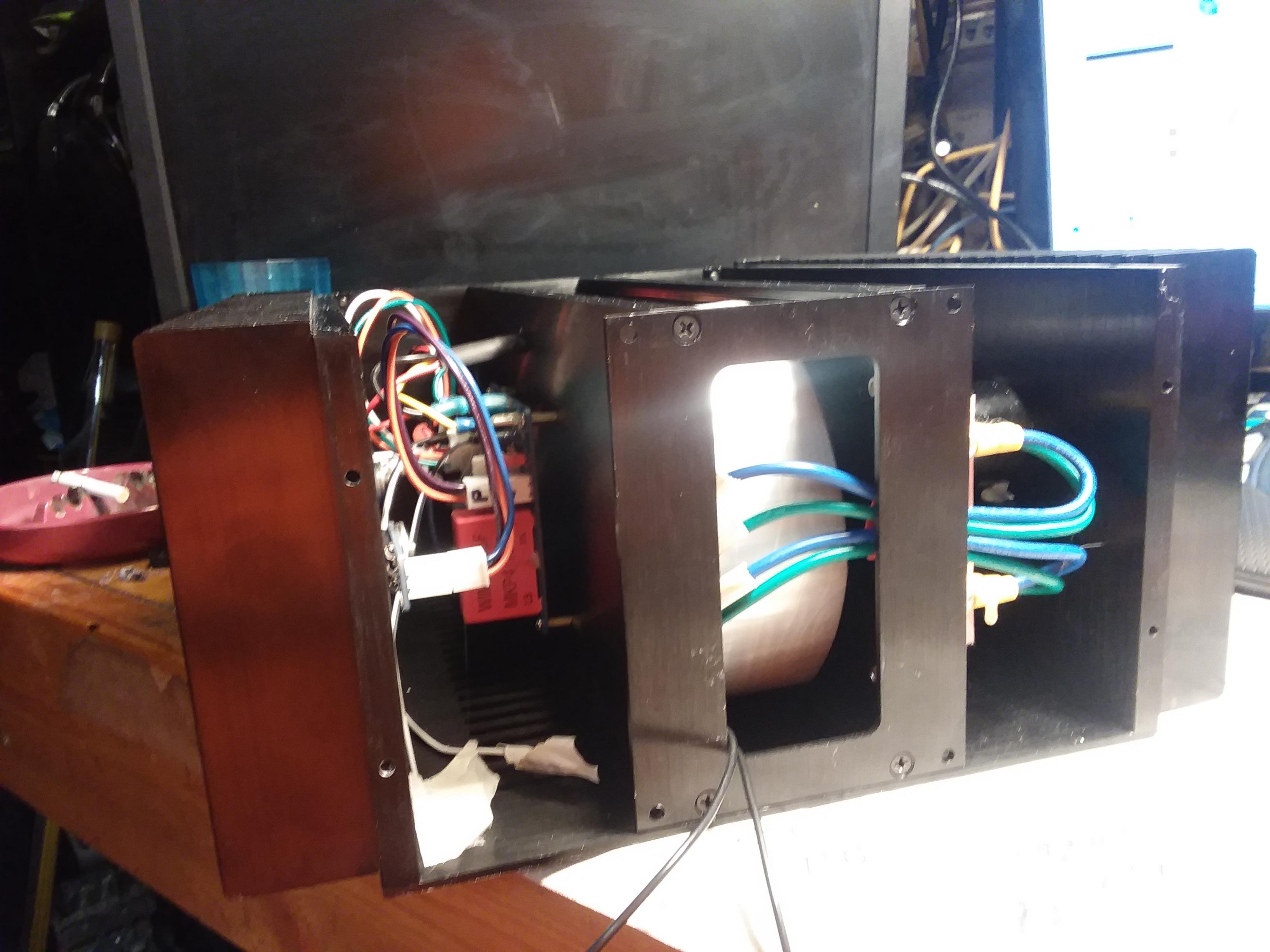

The middle section has no holes in it. I milled either end, and smoothed it down, so you can snake wires both front and back and then drilled a hole through both where you see the copper pipe. 3/8 hole and pipe worked perfect.

The sellers' store is closed, so no link is available. I'd be happy to provide one when they open again.

Slots
Here's a pic of the slots I milled on the two verticals both front and back side: You can see the tranny outputs go through one... there is a spacer place that is in place there and holds the wires in place nicely. There are also zip ties on both sides with isolate the wires and stand them off the metal of the metal in all directions.

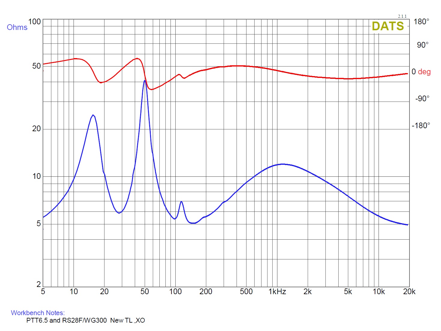

For grins I connected my 5ohm PTT6.5 and RS28F TL’s to my 8ohm Alpha Nirvana today. Not expecting it to work well, but surprised that it sounds glorious. Not a problem at all driving this load:

XO schematic:
With Matytinman’s special recommendation of Miflex but in 0.1uF value.
Here is the speaker:
