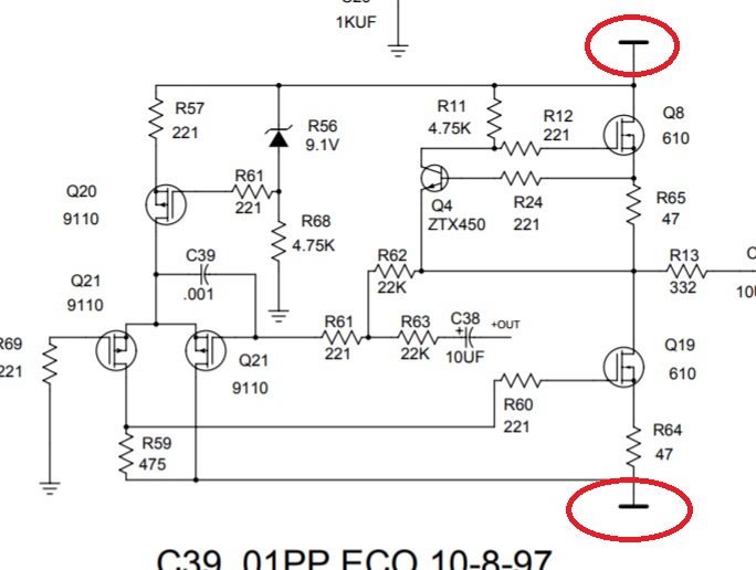

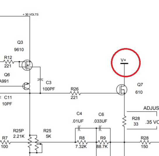

Could anybody confirm that all the power supply connections circled in red in this attachment (taken from Aleph ONO service manual) are actually connected to the same +30 volts which is connected to pin S of Q3 ?

In photo 2 it is not possible for the amp to work with Vcc connected to both rails. There has to be a potential difference.
Alephs with a single output device would typically use +/- 24V.
On photo #2, okay that should be +30 & -30V then. My bad.
For photo#1 i'm curious why it is not connected at S pin of Q7? Or should it be connected directly to the regulated +30V?
everything is fed from regulated 30V rails
