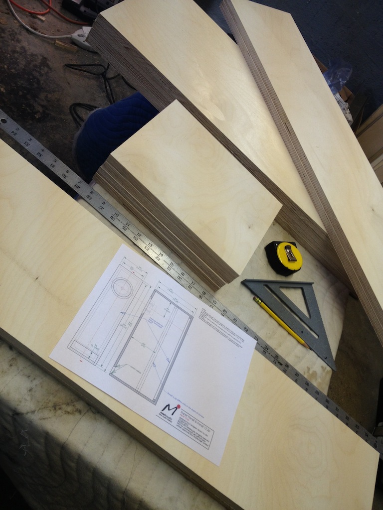

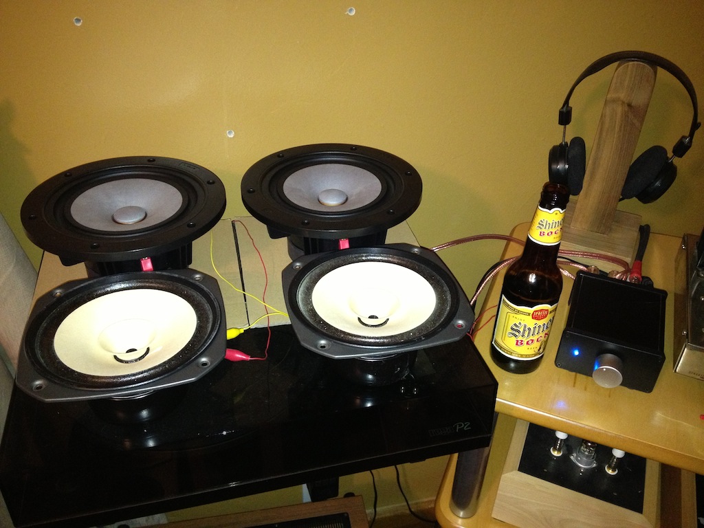

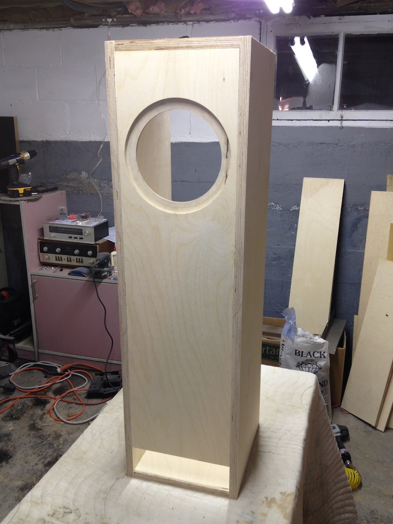

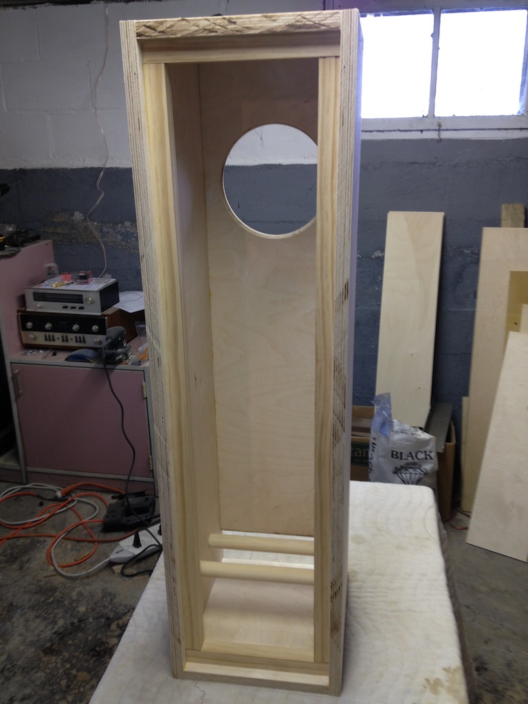

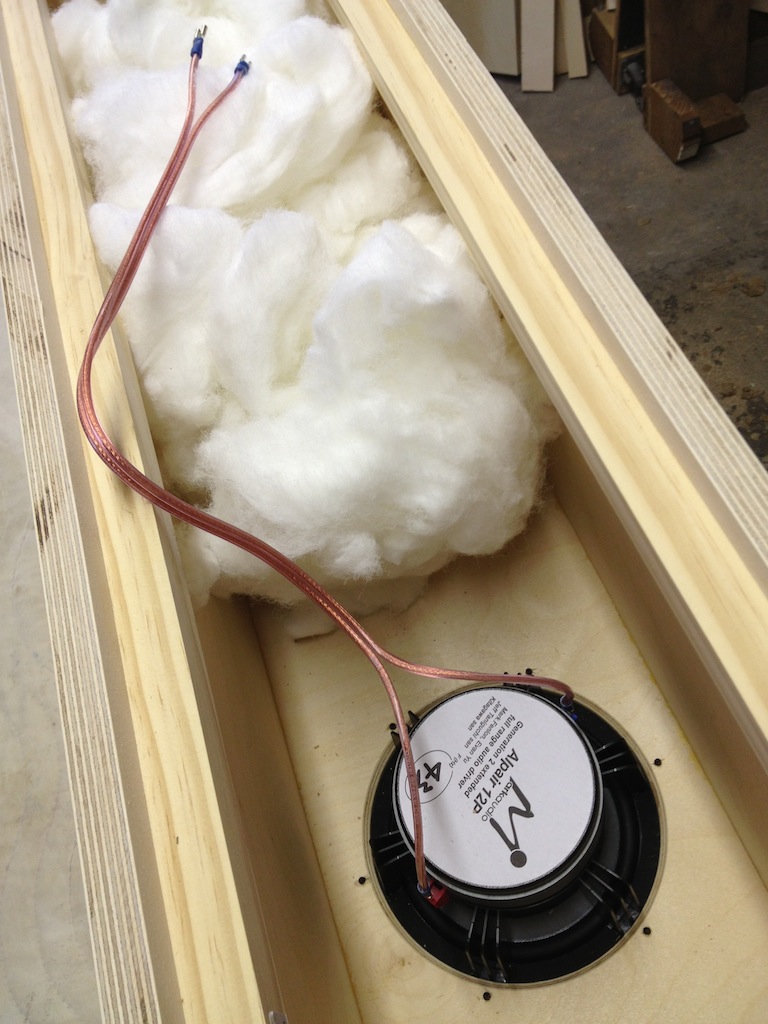

The Markaudio 12P drivers have about 150 hours on them, so it is time to build some boxes! I was originally going for the Super Pensil 12p box, but opted for the standard Pensil due to size and also I read that there is a slight mid-bass dip in the larger box. I prefer a flat response, so I am willing to sacrifice some low end for a better balanced cabinet.

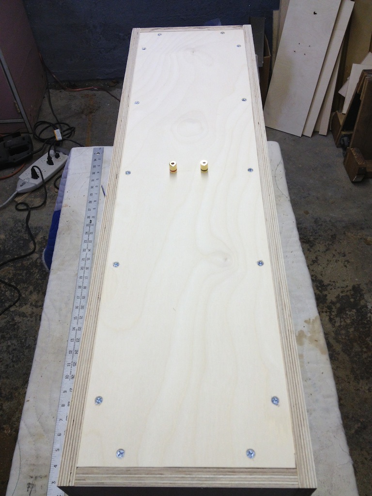

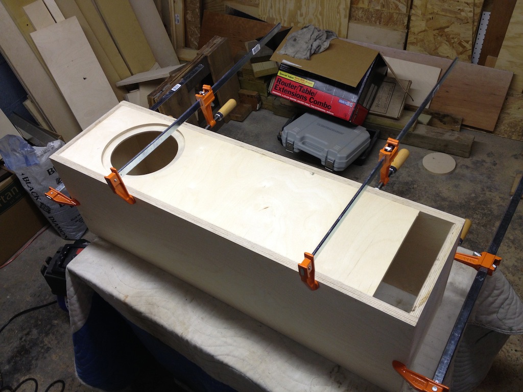

Pics attached were from last night about 11PM. I am headed to the hardware store for the rest of the parts to finish and should have final pics up this afternoon and then you won't see me for a while because I am pretty sure based off of what I heard with them running in free air that I will not be able to be pried away from them! 😀

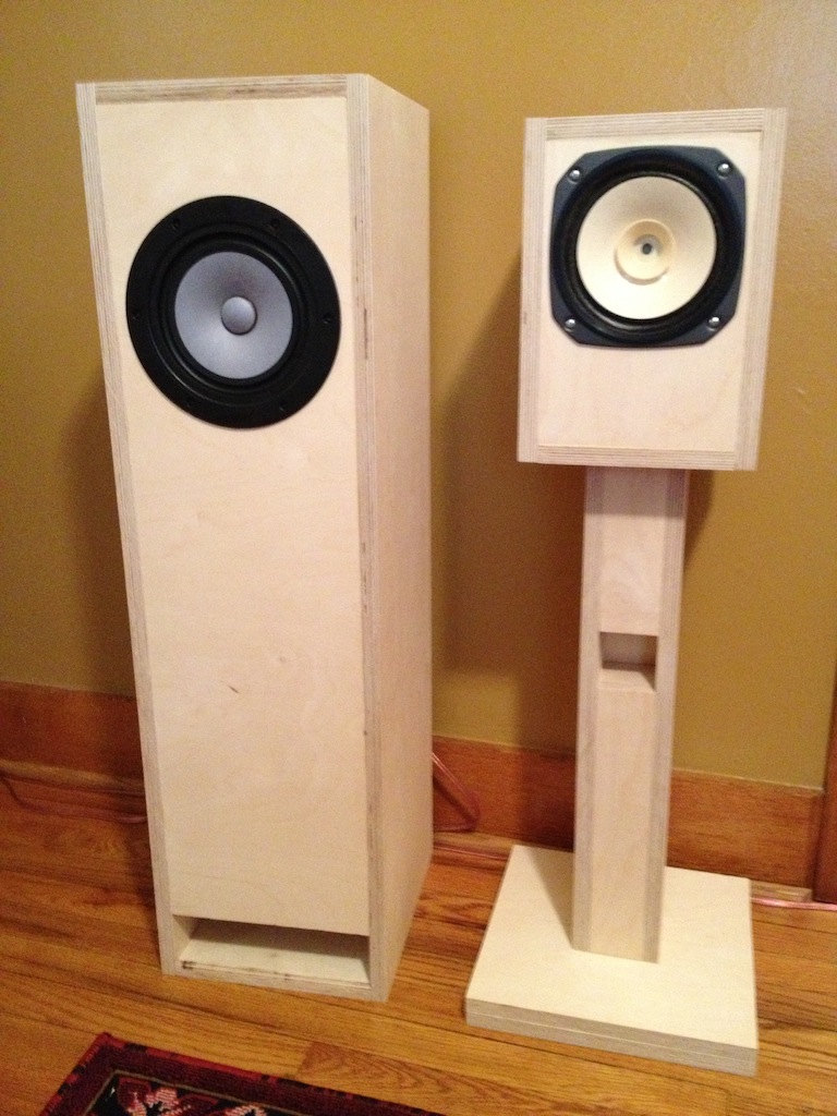

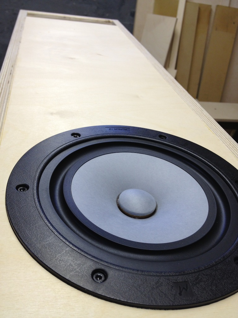

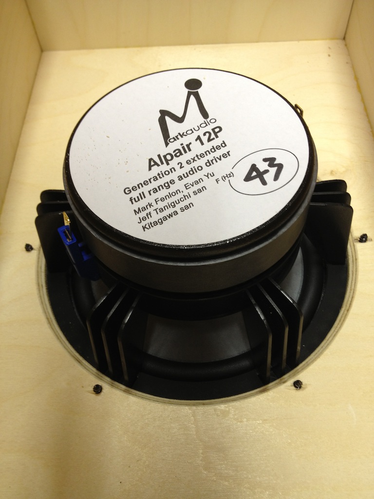

I got them finished about 2PM yesterday and as promised, I was too busy listening to update the post. Mind you my previous speakers were RF-7's with DeanG crossovers, so the 12P does not replace them per se. I do find it to be a very smooth, balanced speaker without any emphasis or forwardness at any frequency. I did notice a little harshness at certain frequencies, but it "sounds" like it is something that will smooth out as they break-in since I did not notice it again. I was surprised at their ability to reveal information that even my 102dB sensitivity RF7 horns were not able to. I also now have a noise problem that I never had before that I will need to start tracking down. It does not change with volume, so I am thinking it may just be electron flow through the tubes.
Overall I am VERY happy with the speakers. The bass extends quite low and a subwoofer is definitely not necessary for just listening to music. I am now glad I did not build the Super Pensil as I do not feel more bass is needed (at least in my small 11x14 room).

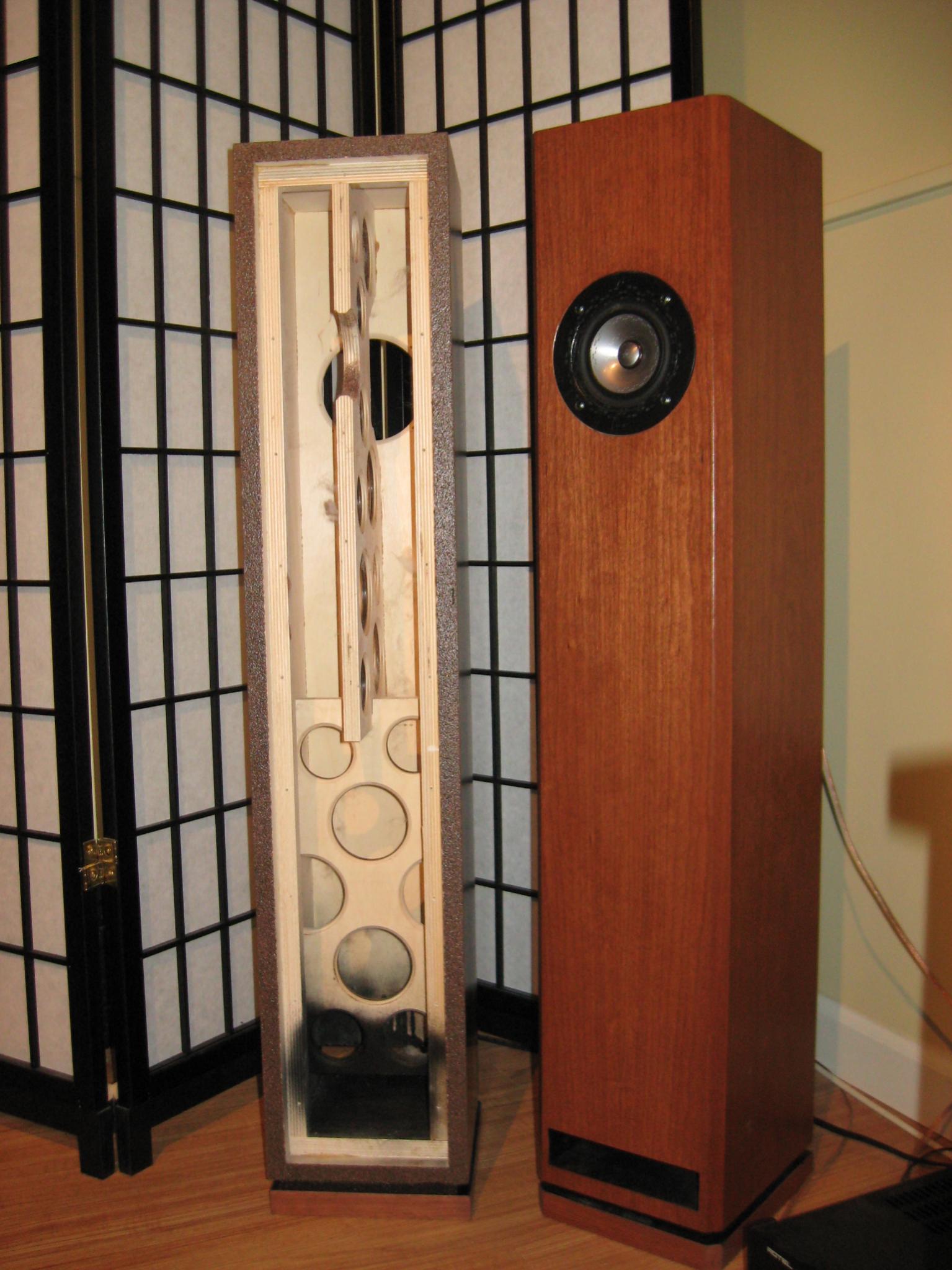

There's quite a few pics in the MA forum "post pics of your pensils" (or something like that) thread.
