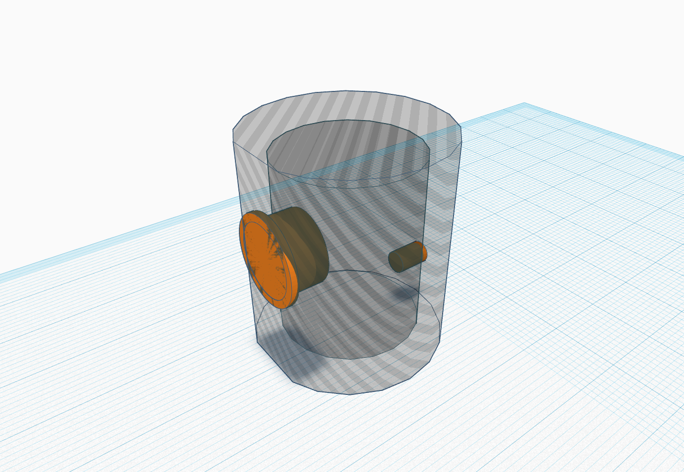

Below is a rough example of a cylindrical enclosure I think I might try to build instead, I already have some plastic buckets that are the perfect size for it, making the wooden boxes to cast the original square enclosures would have been a good portion of the work.
It would maintain the same volume and port dimensions as the other enclosure

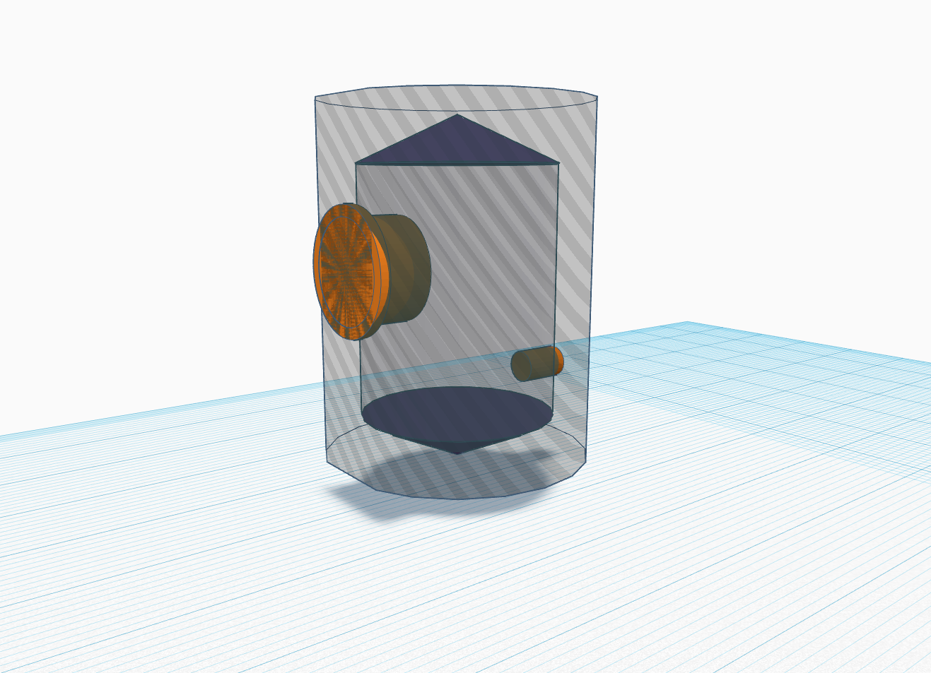

or better yet and no more difficult
Could be flipped on it's side with driver moved to the top, only you would go from near-ideal baffle to what is supposedly the worst

The internal shape will be pentagonal instead of cylindrical as that it will be much easier to cut.
It's all mostly guess work on my part but I suspect cylinders, while curved, might have a disadvantage since the diameter is the same at all angles, similar to a sphere but on 2 axes. A pentagon still fits inside a cylinder well and avoids parallel walls, a bottom slant was added for the remaining ones.
Structurally a tube would be strongest, but a pentagonal interior varies the wall thickness.
The port will be molded into the walls since they were already close to being thick enough, flares can be molded in aswell and I'm sure having a more structurally solid port is a good thing.
I've also been thinking about adding a secondly port, a high ratio resistive port like those found in CGR designs, to be used alternatively to the round port.
Is this a stupid idea?
I could design it to be identical as the normal port except for the shape, or increase the length and aim for similar port velocity to the CGRs.
I get the resistiveness will alter the tuning aswell, that doesn't matter too much.
It's already starting to get over-complicated but I feel like I would probably prefer the a CGR style port based on the sound of the A7p in a sealed but leaky enclosure.
