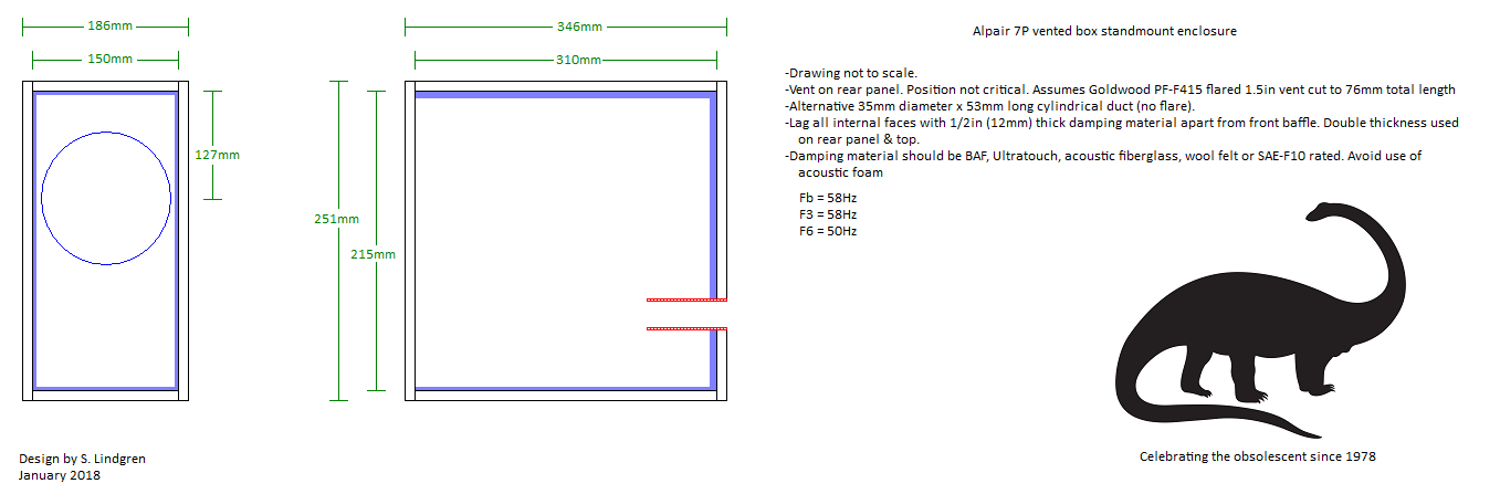

I did a vented standmount for the 7P some time ago (attached) but it tended to go under the radar a bit. Since the driver is now discontinued, I'm not planning on any new designs. It goes into FH3 & Maeshowe fine; I suspect that's where many ended up.
How specific are the dimension ratios for this enclosure?
I would like to increase width to 180mm and decrease depth to 260mm to compensate as it would make part of the building process slightly easier and the speaker slightly shallower.
