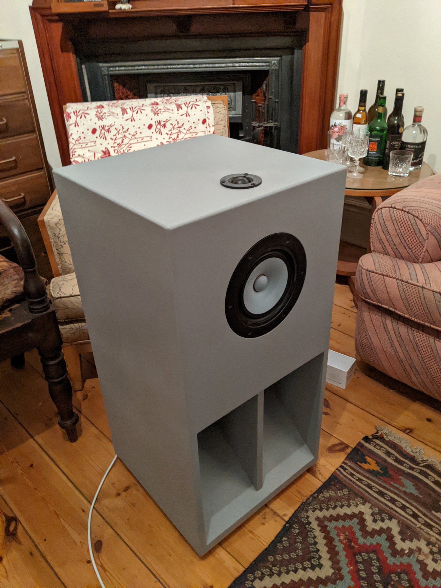

Hi there, and sorry to jump on the thread. Just hoping someone might be able to advise if this is a daft idea or worth pursuing. For projects I've meant to do but never found the time I have a pair of Alpair 12PWs and a pair of SB Acoustics Satori tweeters sitting around. Now I have a bit more time on my hands I'd like to do something with them and I'm wondering if they might play nicely together in something. In my head a Super Pensil cabinet kit from KJF (albeit with an extra hole routed out for the tweeters) with a low-order crossover at a fairly high point (7000hz?) would get the most out of the Alpairs and let the Satoris take over nice and smoothly at the top end.
However, I'm far from an expert here and from reading a lot of threads on the subject I suspect I might be walking into a world of trouble with phase issues, interference etc. and I may just be trying to reinvent the wheel, rather than doing the obvious thing of just sticking a decent full range driver in a well designed cabinet. Regardless, I would welcome any thoughts before I go too far down the rabbit hole...

It is an idea, adding a tweeter to A12pw, that i have rarely seen. But the recent build of Empress of India did just this. Th efellow ended up with this fter trying a forward firing horn tweeter.

Cheers Dave, really appreciate the response. Aye, it's not something I've seen many people doing on any of the various forums, which should probably tell me something. I've read on here, quite possibly from yourself, that the 12PW makes an excellent FR in its own right, just perhaps lacking a bit of sparkle at the higher end. Unfortunately I suspect it isn't going to be as simple as sticking an extra hole in a cabinet kit alongside a simple x-over and making something spectacular but, tbh, as a novice DIY'er having worked my way through turntable, phono, pre and (shortly) power amp I'm just itching to get into another project!

The A12pw has been under-appreciated. They are only starting to get some builds behind them.
...that the 12PW makes an excellent FR in its own right
It does. Particularily if you have limited HF hearing. What is does right below 10K puts it ahead of the A12p which goes all the way up.
Some playing will likely be needed, we will find out more as we see mre take this approach.Unfortunately I suspect it isn't going to be as simple as sticking an extra hole in a cabinet kit alongside a simple x-over and making something spectacular
The A12pw reaches to about 10k, but as the frequencies do up the relative centre-to-centre becomes significant and one gets a different amount of reinforcement or cancellation causing significant pertebations in the response thru the XO region just by moving your head. The castle arrangement show avoids that by purposely pushing the distance to a point where it fills in the topend sheen without the FR pertebations.
A lower XO point would allow more convential use. If one takes 2 ocatves doen from 10k, a 2.5k XO gives overlap on the A12pw. Usually measn faster than 1st order XO.

Be that as it may, I wouldn't personally cross the Satori tweeter (which I know well & have used in commercial products) at 7KHz: to me this is not using either driver to their best advantage. I'll have a look and see what I can suggest as I do have measured data for both drivers available.

That said, on the back of Dave's input I spent yesterday wedging the 12PWs into some old Castle Pembroke cabinets I had in the shed. Obviously absolutely miles away from ideal, but as an experiment will hopefully give me a feel for how they might go as FRs in their own right...
