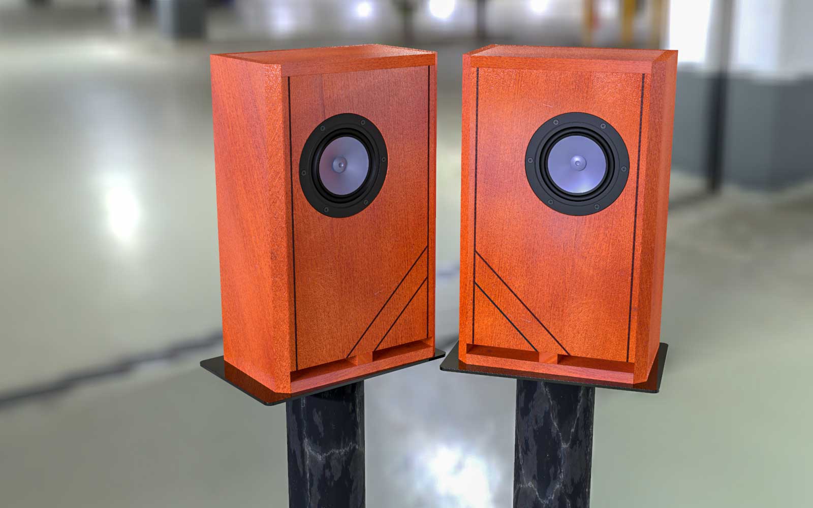

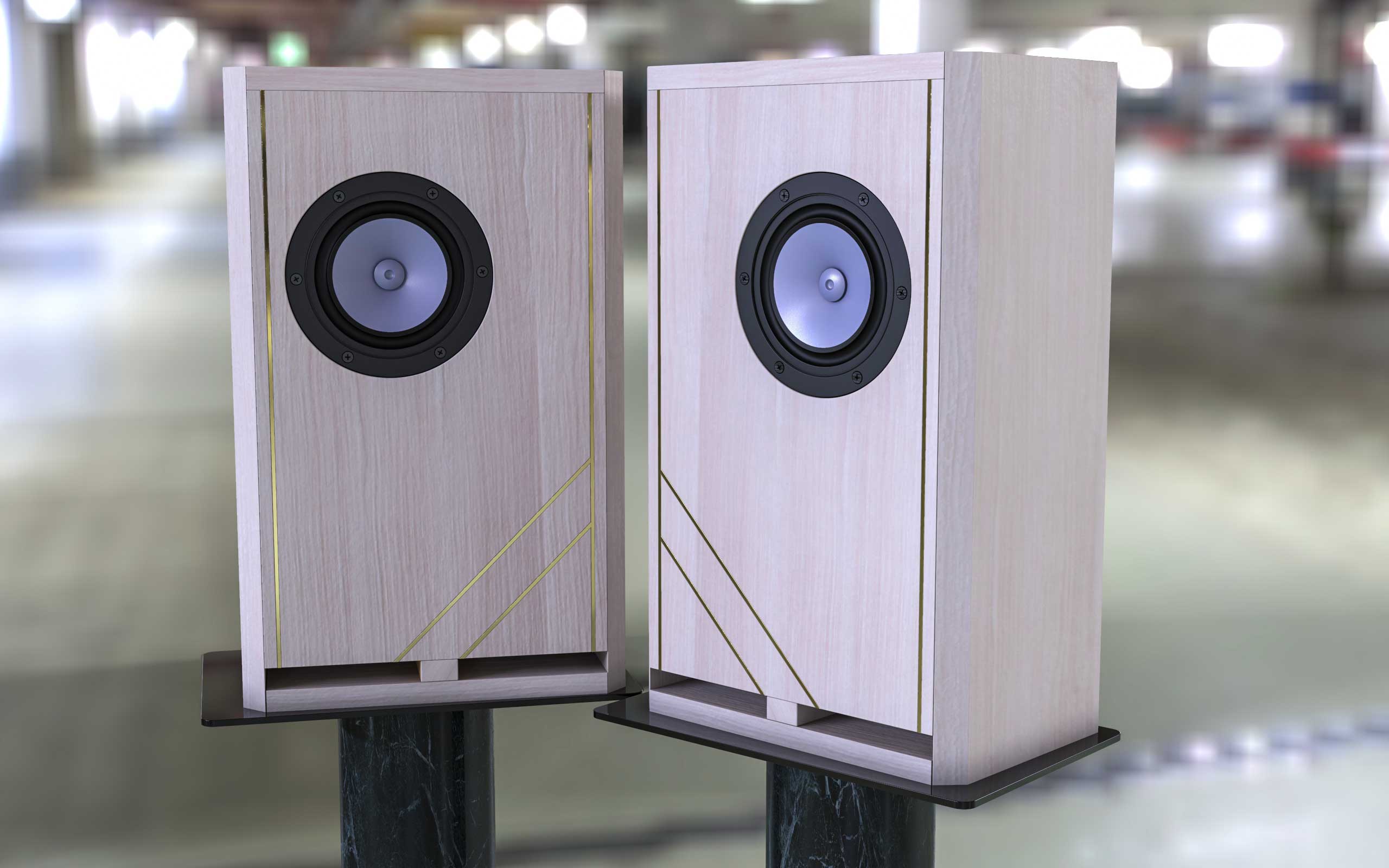

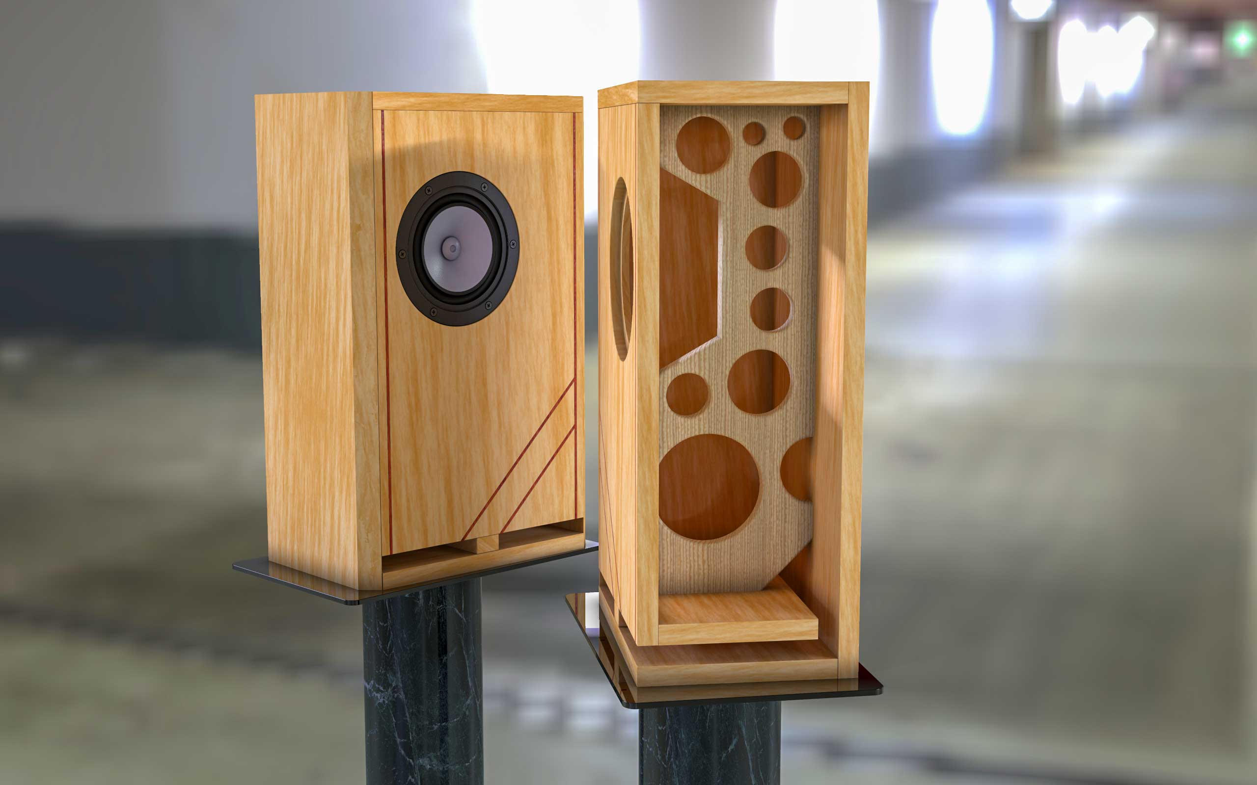

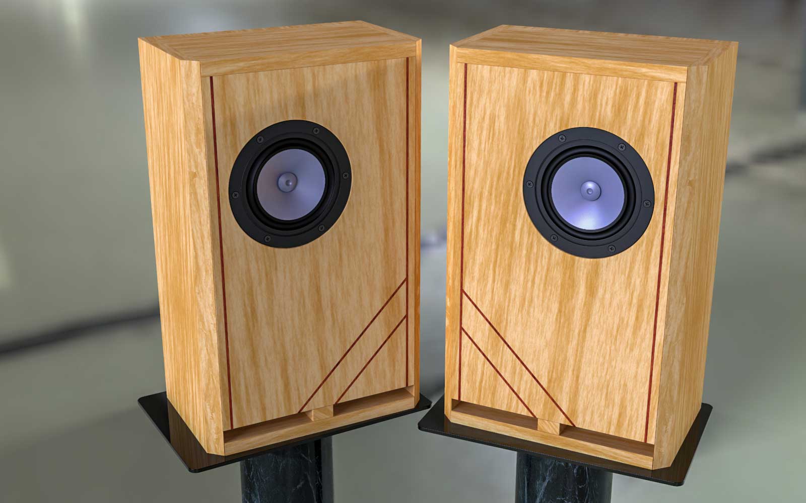

I am currently working on the A7ms miniOnken planset. The optimum volume i am using is 9 litres. It turns out that the volume the driver takes up is pretty close to exacty the extra box volume you get from chamfering the back of the driver cutout 45°.
6"x17”x9.4” with ¾” material yields 9.03 litres, just about perfect. I would suggest that with a box this large you may want a brace.
dave
I have done the 1st pass of A7/11ms boxes. Except for the millSize A7ms box all are 9 litres and the set does include CGR for both. While a larger box is not suitable for the A11ms, it may be possible to fit the A7ms in 13 litres althou the sim does not give quite as nice a shape it is very close to the Mar-Kel for the EL70 so i will do one if someone wants to build one. These 2 plansets are currently in beta so if you want to participate send me an email. This alignment also makes it suitable for the Compact FLoorStander.
The current beta testers plan on doing the full on trapezoid for the A11ms, and the milliSize for the A7ms. Be nice to get a couple other builds particualrily for the A7ms which has a wider range of boxes.
