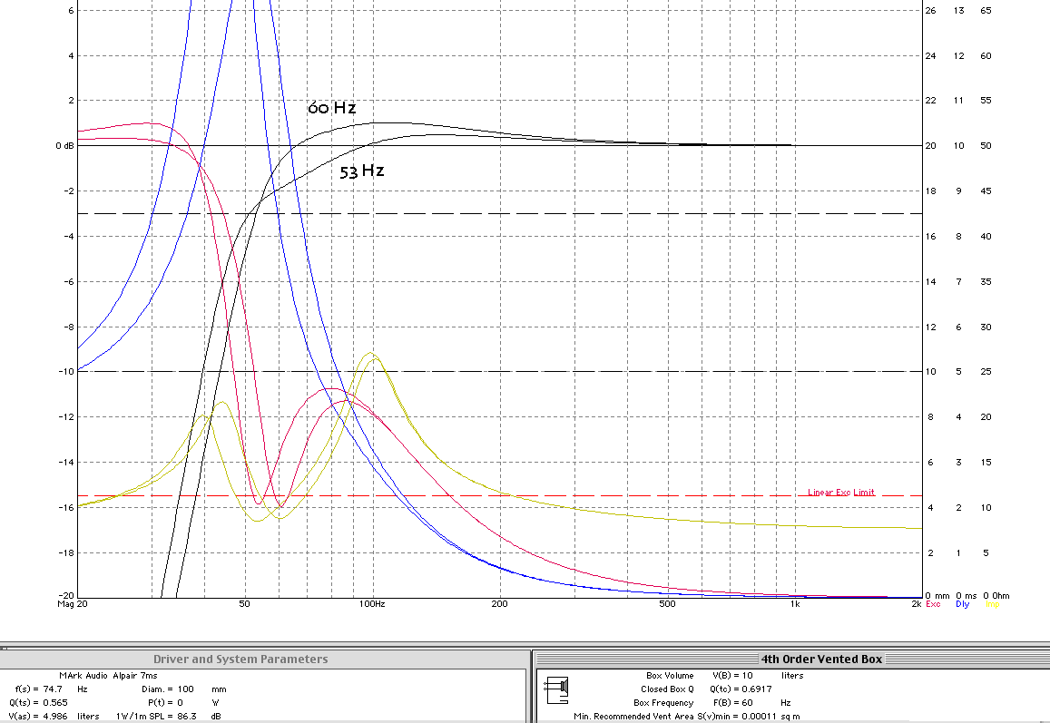

Speaker Cabinet Port Tube 1-1/2" ID x 4" L Flared
Guessing the radius of the roundover (at 12mm) i estimated a tuning of 53 Hz. I prefer a curve with only 1 inflection point (60 Hz) and then if needed i knock it down with a purposely high resistive vent (as on your Mar-Kens).
I estimate shortening it to about 80mm overall. A round port can be made more resistive using ganged soda straws (ala mission) or circles of open cel foam (stack them for more R)
