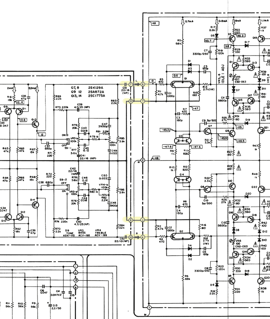

Might it be possible to access / modify the circuitry of the SA7800 to (temporarily) re-purpose at least one of the tape loops as pre-out / main in? That could give you a signal to drive an outboard amp for woofers, as well as a connection node for series HP filter to the internal amp section to drive the 7s. (or the other way around)

Thanks for the input Chris. I've not the know how to create a pre-out in the amp's circuitry. I'm planning on doing the removable back, flush mounted driver and chamfer on the inside lip of the mounting hole. I don't think I'll use any internal bracing, though. Now that you have me thinking, my options are really opened up when using the mini DSP. I could actually create a huge system from basically nothing with that. Oh the ideas are flowing!
Looks like Pioneer dropped the pre-out jumpers on the 7800, which would have been easy peezy for adding extra pre-outs.

And don't forget that along with rudimentary XO controls, most dedicated "plate / sub amps" have high impedance speaker level inputs that run in parallel with your main speakers. While their common ground inputs can cause havoc with some chip or T-maps, that shouldn't be a problem with the 30+ yr old Pioneer. This wouldn't eliminate the need for a speaker level HP filter on the Alpairs in a FAST or OB application, but could very much streamline the set up.

Pretty easy to do. Sacrifice a tape loop for jacks, and then just reroute the wires that connect the tone amp to power amp boards.
