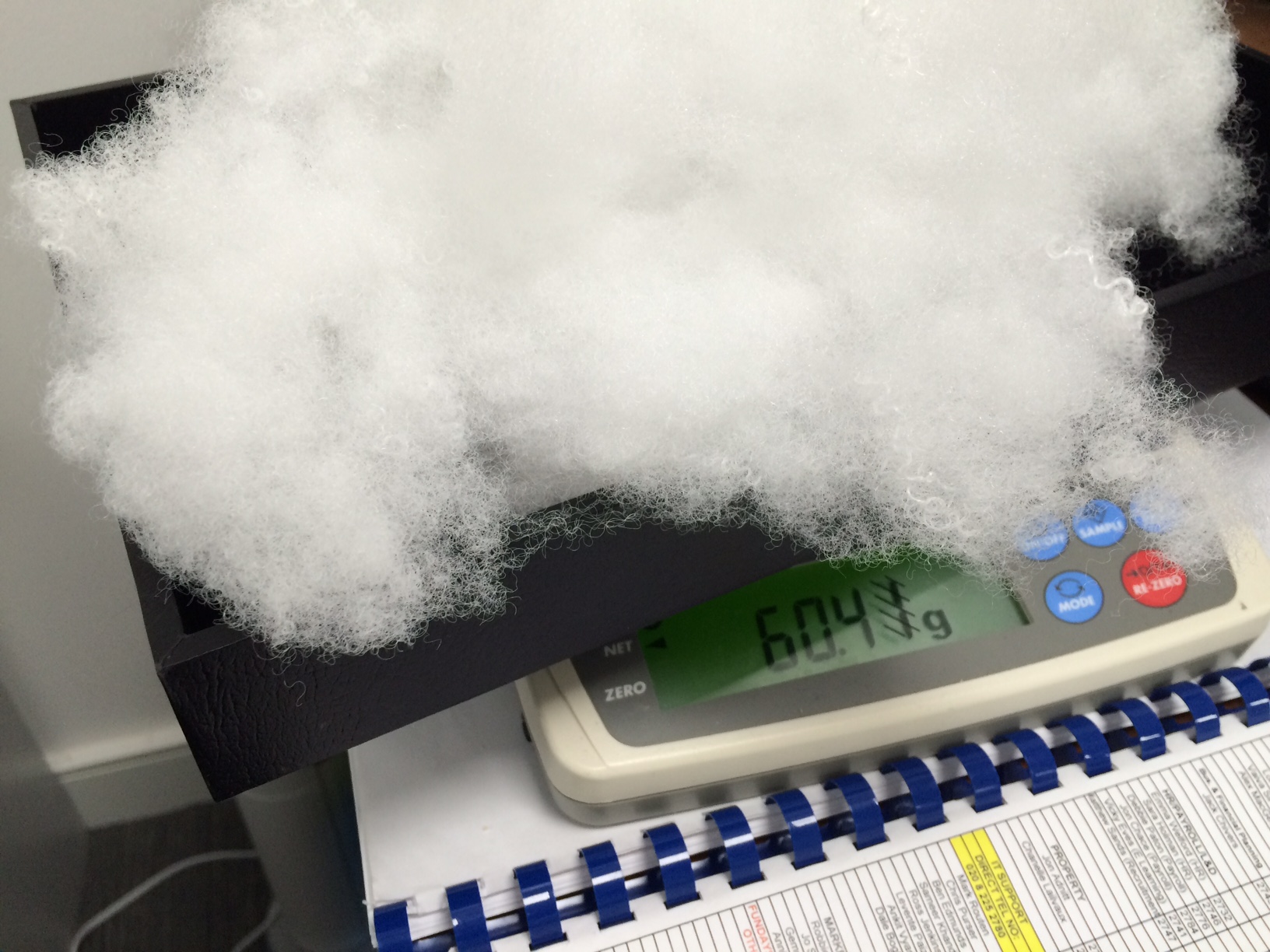

I like the sound of a big puffy mass...
OK, I will try on the weekend to remove the old wadding and insert newer fluffier masses. Tho, I wonder if it would be beneficial to start again with ply?
The structure you want is no structure… one big puffy mass.
Here is what 40g of acoustastuff looks packaged/teased

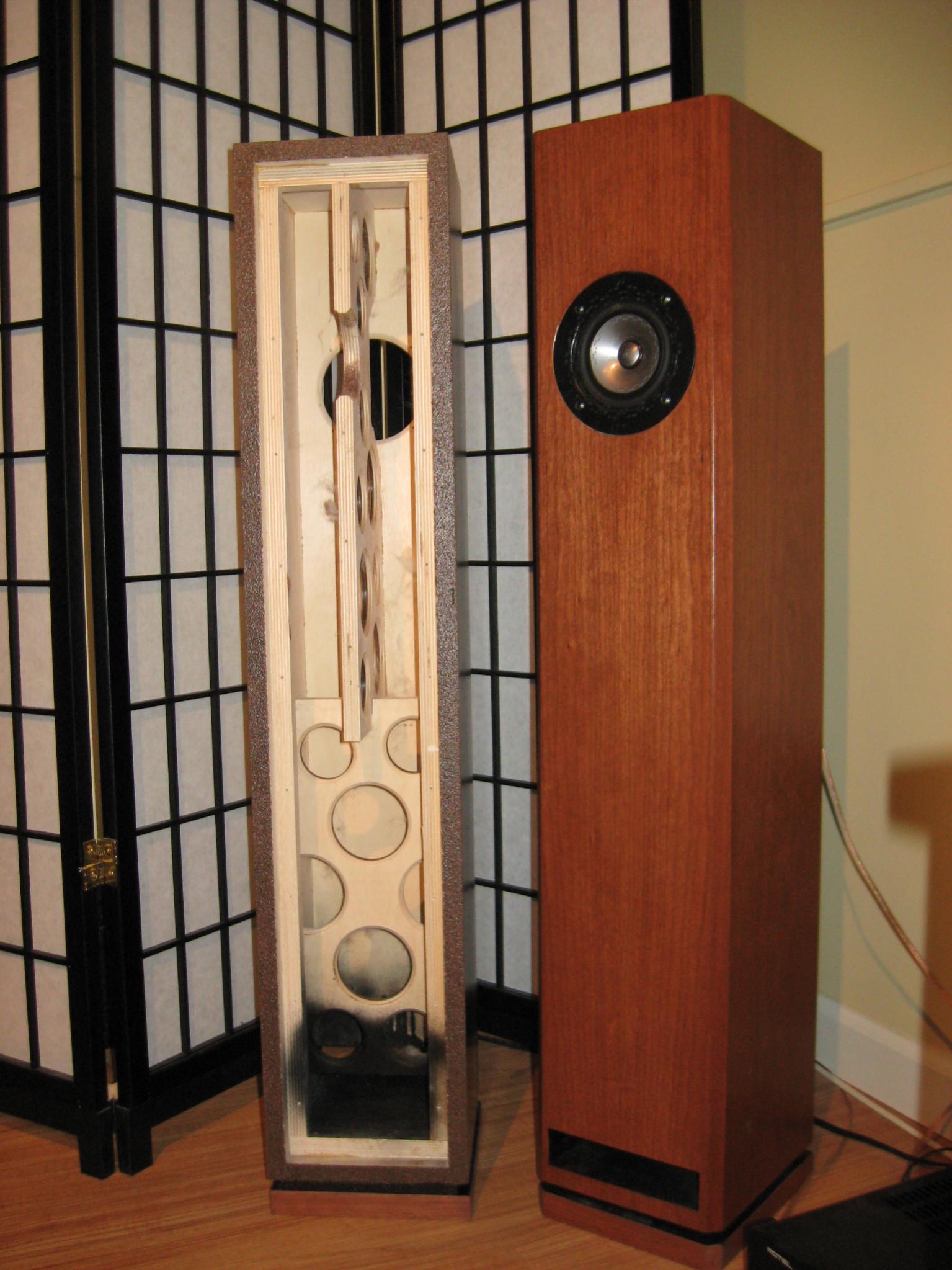

Don't look here for an argument against using decent Baltic Birch plywood. 😉 A trick of another designer of similarly configured enclosures - and I think Scott wouldn't mind saying one that's been around for decades - would be to make the rear panel removable on cleats to allow easy access to adjust amount & distribution of fill.
And even on something as compact as these, a little bracing never hurts

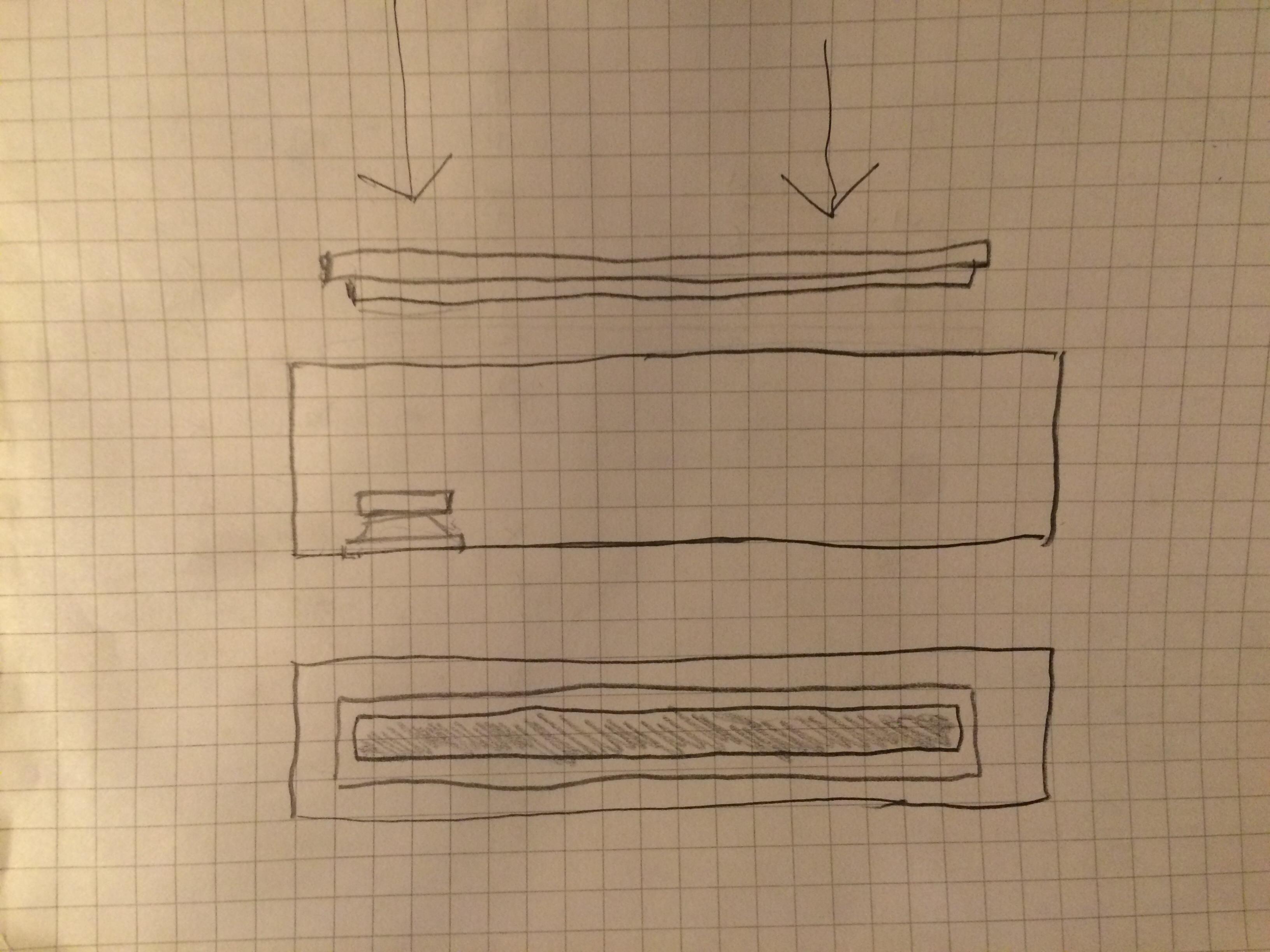

I just had a thought... (Danger zone)
If I jigsaw out a very straight rectangle from the rear I could use the cut out and mount it to another panel so it could fit back in being secured by screws around the edge. Poorly doodled image attached.
I could put foam tape on the seems.

I don't think the slight decrease in total CSA / volume from adding cleats wouldn't be significant enough, but if concerned, your idea could certainly work. The cleats on Pensils above were 18mm square, and they also incorporated closed cell foam weatherstripping tape - not shown in the photo.

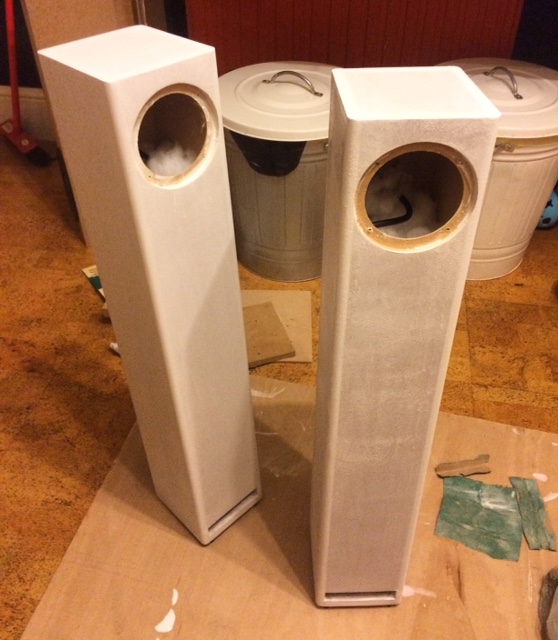

I have reassessed the fluffy mass and plumped for a fluffier filler. Hopefully once I have this in the issues will be solved.
I listened to the port very carefully with my ear to it and I could hear clear vocals. I guessing that once I get the stuffing right it will have a knock on effect to the other frequencies?
When listening to TV with them voices are very boxy and resonant with a dip somewhere in the upper mid (?).

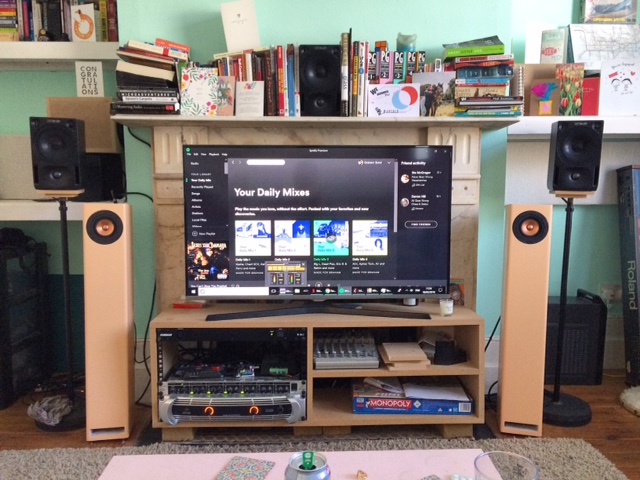

Right!
I have semi finished them! I rounded over the vertical corners, installed proper stuffing and painted them. A lovely peach colour to match our pastel front room.
The stuffing was the issue, they sound completely different and tonnes better. Though, I can still hear a little bit of mid frequency coming through the vent. I added 10-15g of stuffing to see if it would help but it is the same. I don't know if this is actually an issue as I have them crossed over at around 100hz with two sealed Tang Band 6.5" subs using a Minidsp balanced unit and they sound great with this sub reinforncement. I alter the crossover frequency a fair bit and I have set them as low as 80hz with no issues.

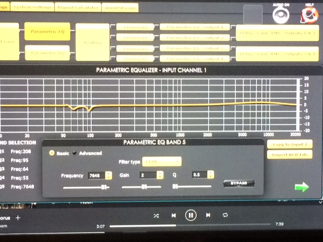

I have a question regarding the top end of the FR. Somethign was missing from the sound so I tinkered with Minidsp and ended up boosting at around 7.5khz at 2db with a Q of 0.5. I've attached a wonky shot of the EQ. Ignore the low end, I'm taming room modes. Is this common for this driver? Do others have experience with boost treble to make it sound right?
The drivers are 1mm proud of the recess, is this an issue? Also, does the slim cabinet and roundover edges have any impact on FR?
I am jolly pleased with the outcome so far, thanks to Scott and Dave for this design, very happy.

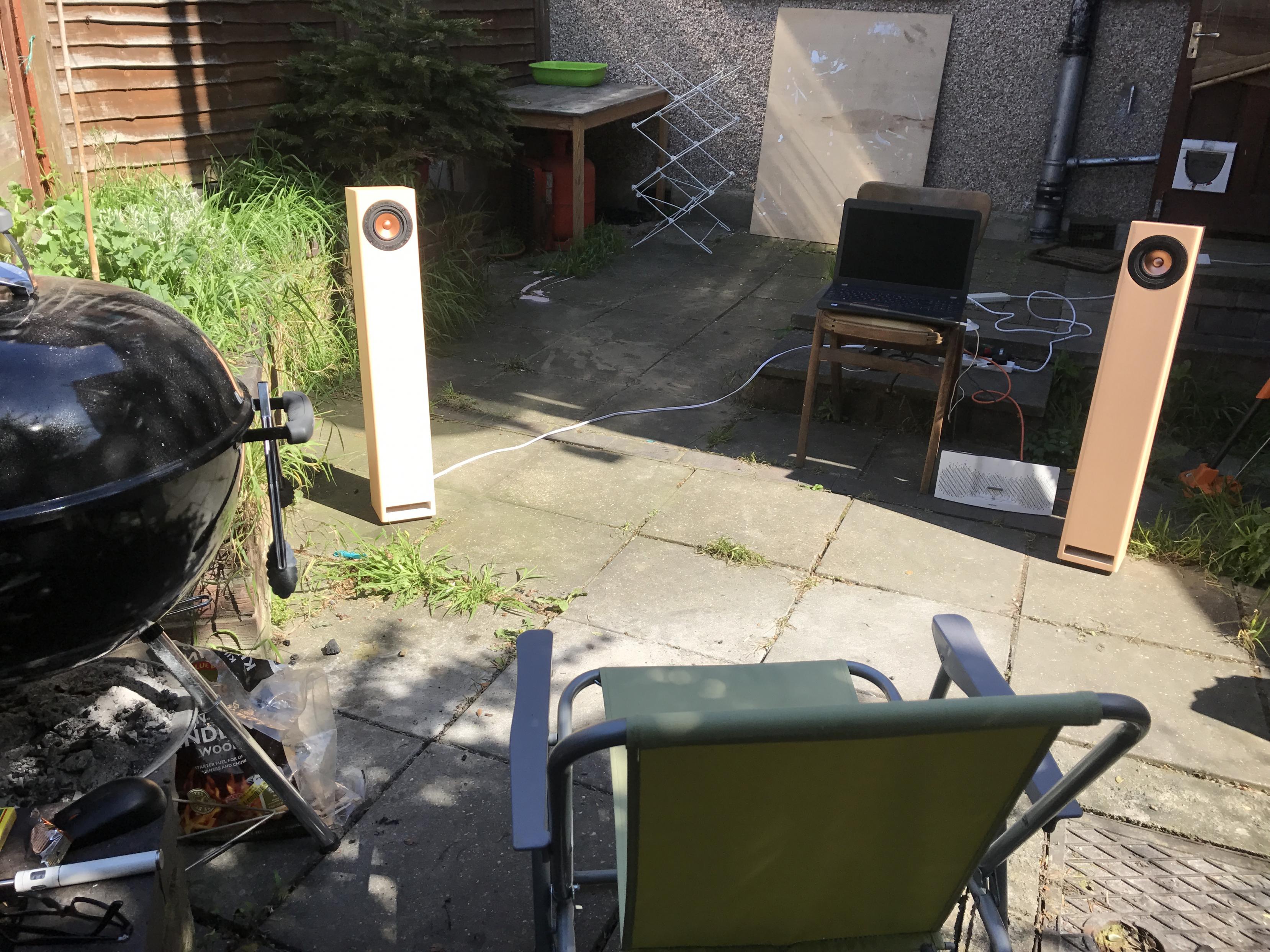

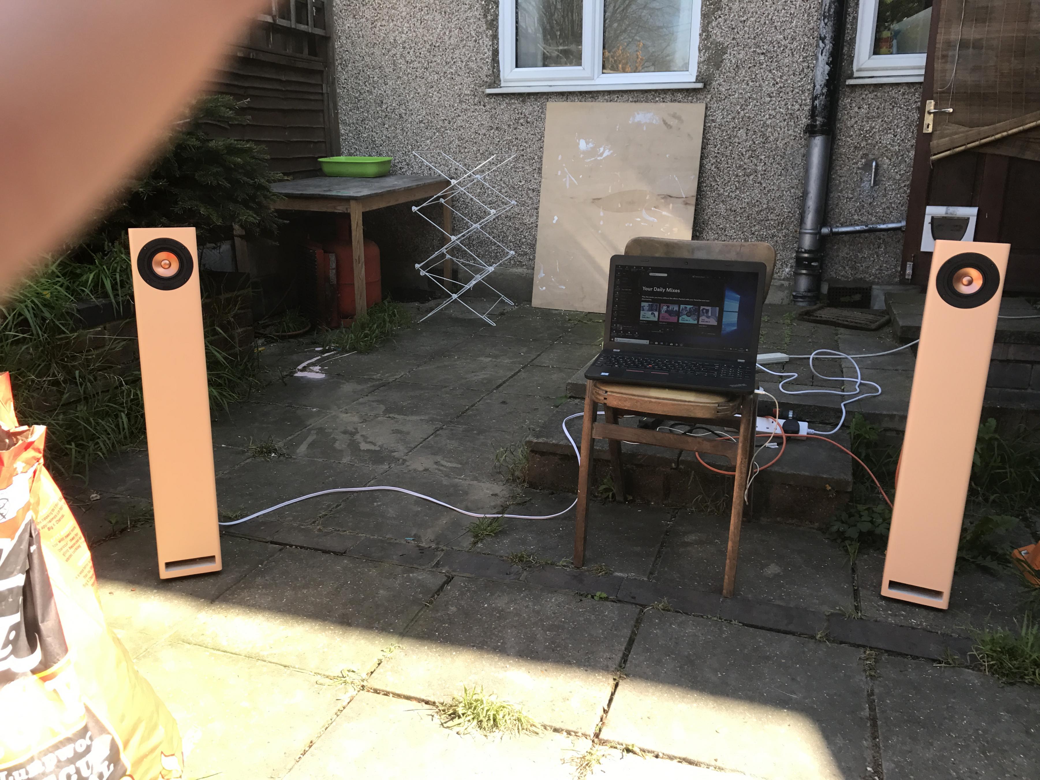

Finally I have had the chance to get these going outside. Wow, very very nice and so glad I don't have to deal with room modes.
They can't reach very high volume out here, the low end gets a little confuse when pushed but what a treat!
Impressively articulate and so low.
Apologies for the garden, this is the first I have had the weather to get out since the winter and the garden went wild!
