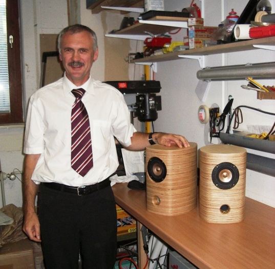

Just handed off ourA6 to Chris. He is almost done the mFonken sized BR (4.7 litre) for these.

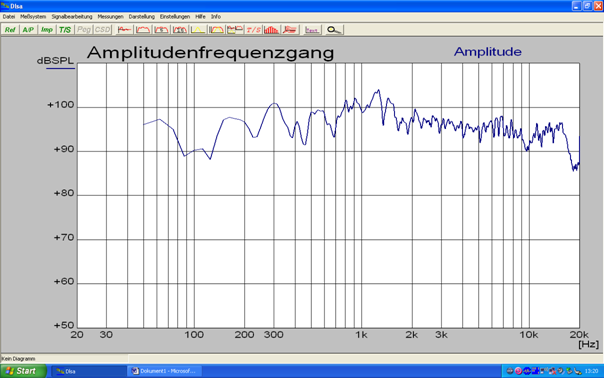

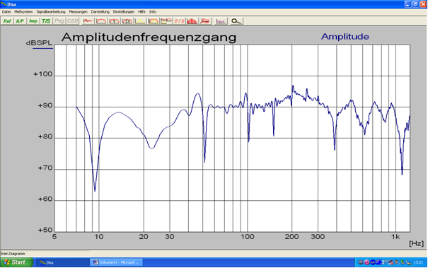

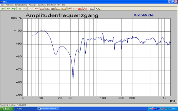

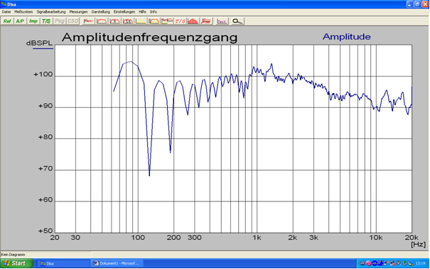

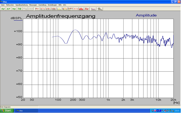

We finally got some measurement. The SPL level is not calibrated, so please ignore the absolute value. Data are raw and not filtered. Measurement is done outdoors. The setup is probably not perfect, but it will do for now, as we just want to check pipe length and filter values.
Attached is the SPL plot with notch filter at HF. Filter is 3R9 // 0.39mH // 28.8uF. Pipe is 36mm diameter and 113mm long.
Distance from chassis to microphone about 1m.
Patrick
Patrick
I posted at the Needle thread our Ap6 Needle.
http://www.diyaudio.com/forums/showthread.php?postid=1883414#post1883414

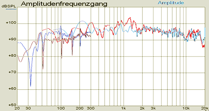

Here are the measurements for the Needle for comparison. The notch filter is as per Henkjan's suggestion, namely 0.33mH, 1.8R, 22uF.
Patrick
Patrick
Listening impressions
Comparing the Needle to the Bass Reflex, the former can go deeper in bass, and the difference is audible. But I personally like the tighter bass of the Bass Reflex more. The Needle sounded a touch too floffy for me. After the measurement, we have packed the damping material quite a bit tighter, but have not tested again due to time limitations.
Without the filters both speakers have a lot more presence, but probably too much. It is a matter of taste, so one can play with the notch to get the preferred balanced.
We are happy that we pretty much got everything first time right, and have just ordered 24 sets of Mundorf cross over parts. (Yes, we are already up to number 24 in our pilot production.)

well... that's up to the listner, but (I can only speak for the needle) I can understand your remark, the first try of the notch for the needle measured (almost) completely flat but the final notch just sounded a lot better. main differense was the value of the resistor, if you want a completely neutral sound choose a slightly higher value for the resistor
I had really good luck with a digital notch filter, meaning no filter parts after the amp and none before either. An active notch is probably also better than the passive notch.

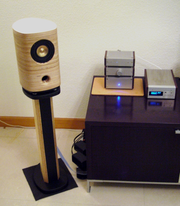

Firstly a few words about the mini system. It is basically a copy of Peter Daniels GC Patek, but I was using the LM3886 from Brian GT, and have extended it to include matching PSU, volume control with LDRs driven by CCS, Daniels DAC clone with logic driven source selector, and a CR Rom based transport with the controller kit from Huang. Speakers are AP6 BR, in two favours (bookshelf and on sand-filled stands). It sounded good enough as a mini system. The requirement was not audiophile, but simple and reliable.
