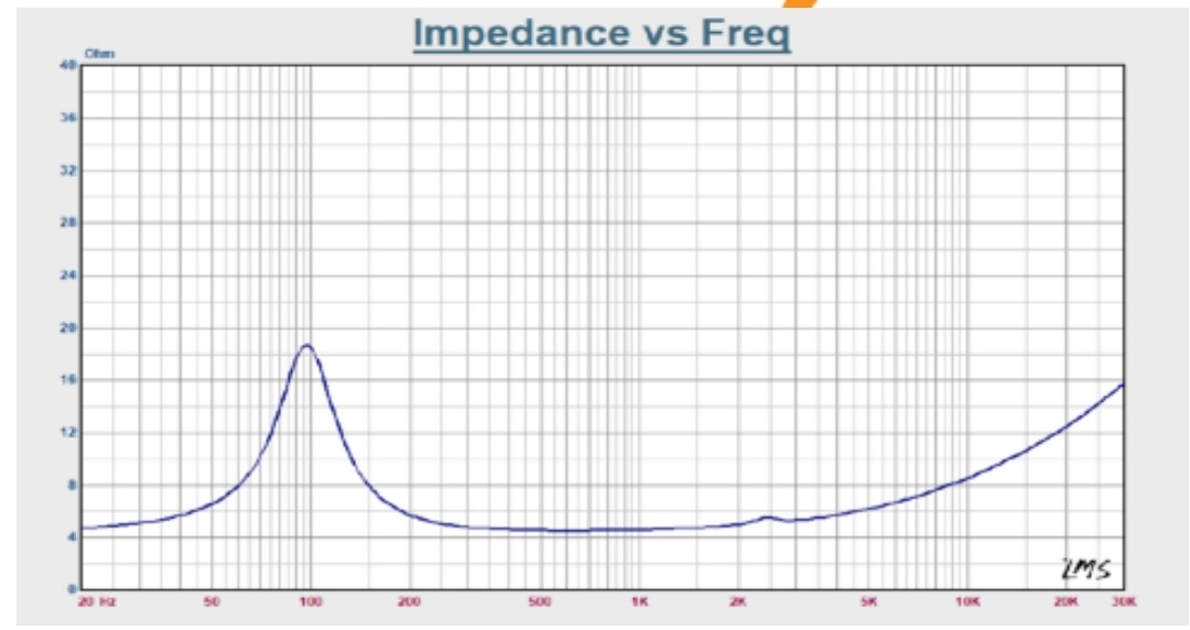

Right going to order the drivers today, but need some advice regarding the crossover parts. From the Snell Freq specs , woofer in blue and the Markaudio specs it looks like I have a wide crossover point options 250 to 1000, what audible difference would I hear between a higher or lower crossover?
1st order? 2nd order. Thanks

Lower XO moves the XO out of teh critical range — if you can keep the centre-to-centre of the 2 drivers to less than a quarter wavelength at the XO point.
Often in a WAW one chooses an XO just below the bafflestep — 0.707 to 1 time Fbs(-3). This allows for baffle step just by adjusting midTweeter level.
Lower XO means more of the range is covered by a single driver. Half-energy point is about 300 Hz.
Higher XO, in theory, allows you to play louder.
I’d tend towards 300-450 Hz.

Right thanks for the reply , so if I was to go with a crossover at 400Hz parts I would need are 2.25mH coil and 70uf cap for the bass unit, could I then just use a single 100uf cap for the alpair 5.3?

Again, per post #7, you have to look back (and forward) to how it's going to be impacted by both driver's in-box impedance and inductance, so no simple answers for best performance, though thankfully one can get close with modern XO designers without historically needing a significant time, parts investment to experiment with.
