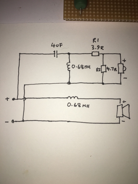

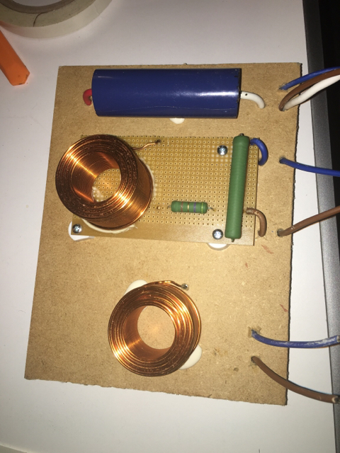

They sound very good. The XO is benign, the bass digs down. After a 1000 Hrs of so the HF issues of the A7p seem to be much more in control. They did get better with A7.3eN installed.
We are working thru some iterations of passive XOs.
