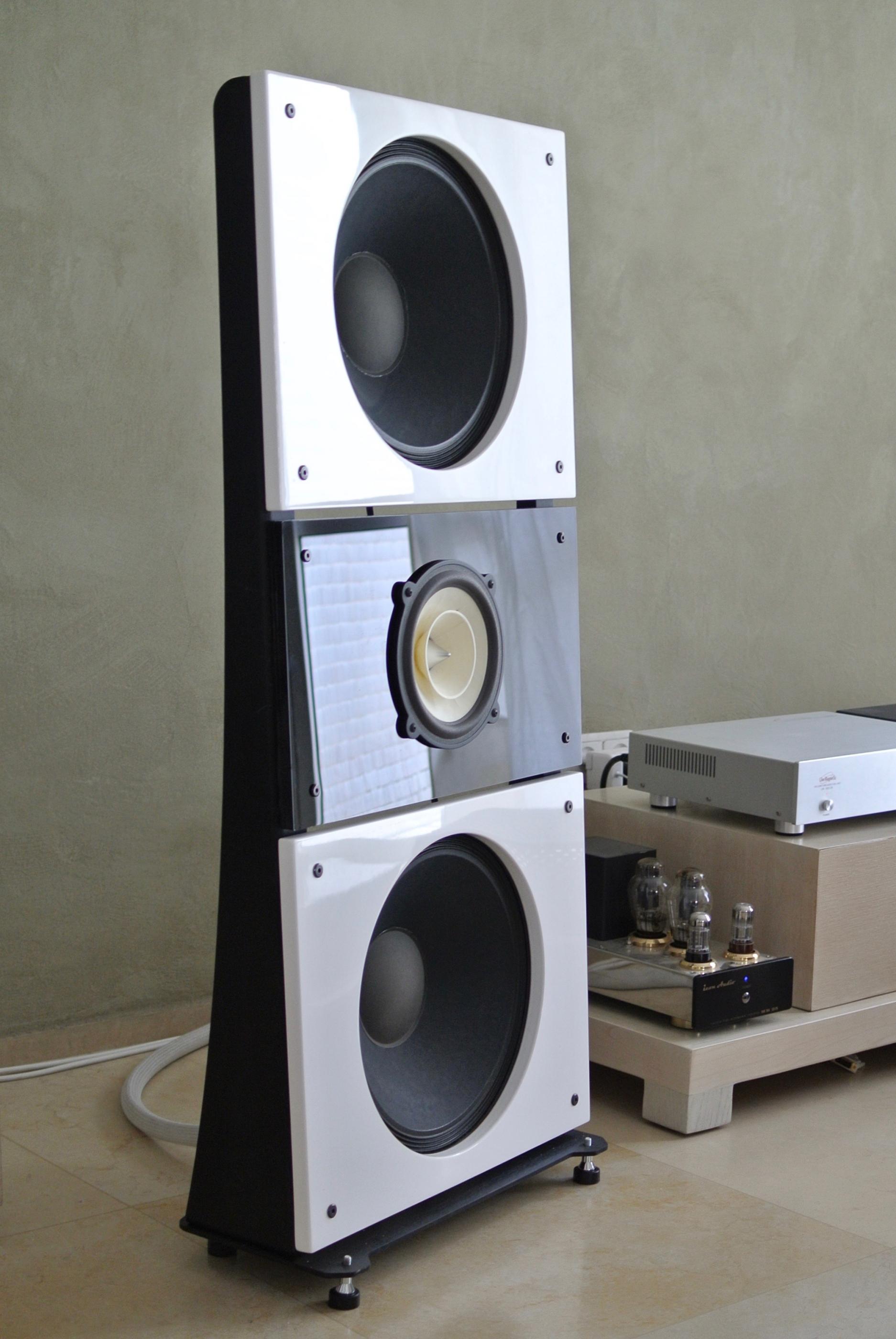

How about mounting the Alpair you have over one 15", offset a bit, and placing the second 15" behind, firing through a slot at the bottom, like in this design that would halve the whole speaker baffle.... Would that still be too big?
Interesting idea. Regarding my design, I was in a similar position as G. A. Briggs back then. I liked the ESL, but couldn't afford them. 😉 So I replaced each bass panels with a 15" and the mid-high panel with the Alpair. Only did some basic simulation in Edge and that was it. In fact, I hardly ever see the cones moving, so even a single 15" would probably do just fine. So ...

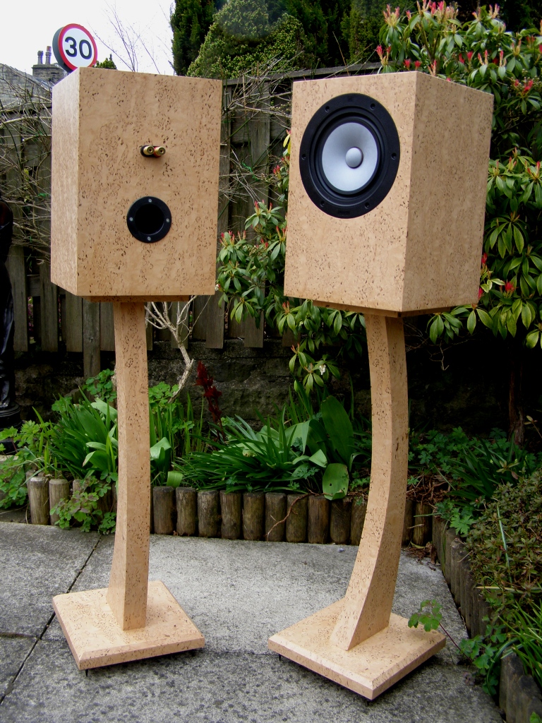

I heard the cabinets Scott posted a photo of.
Nice little boxes. IMO, not the last word in bass extension, but the rest of the range is very good. I liked the slightly laid-back top end, but I can understand why some people add supertweeters.

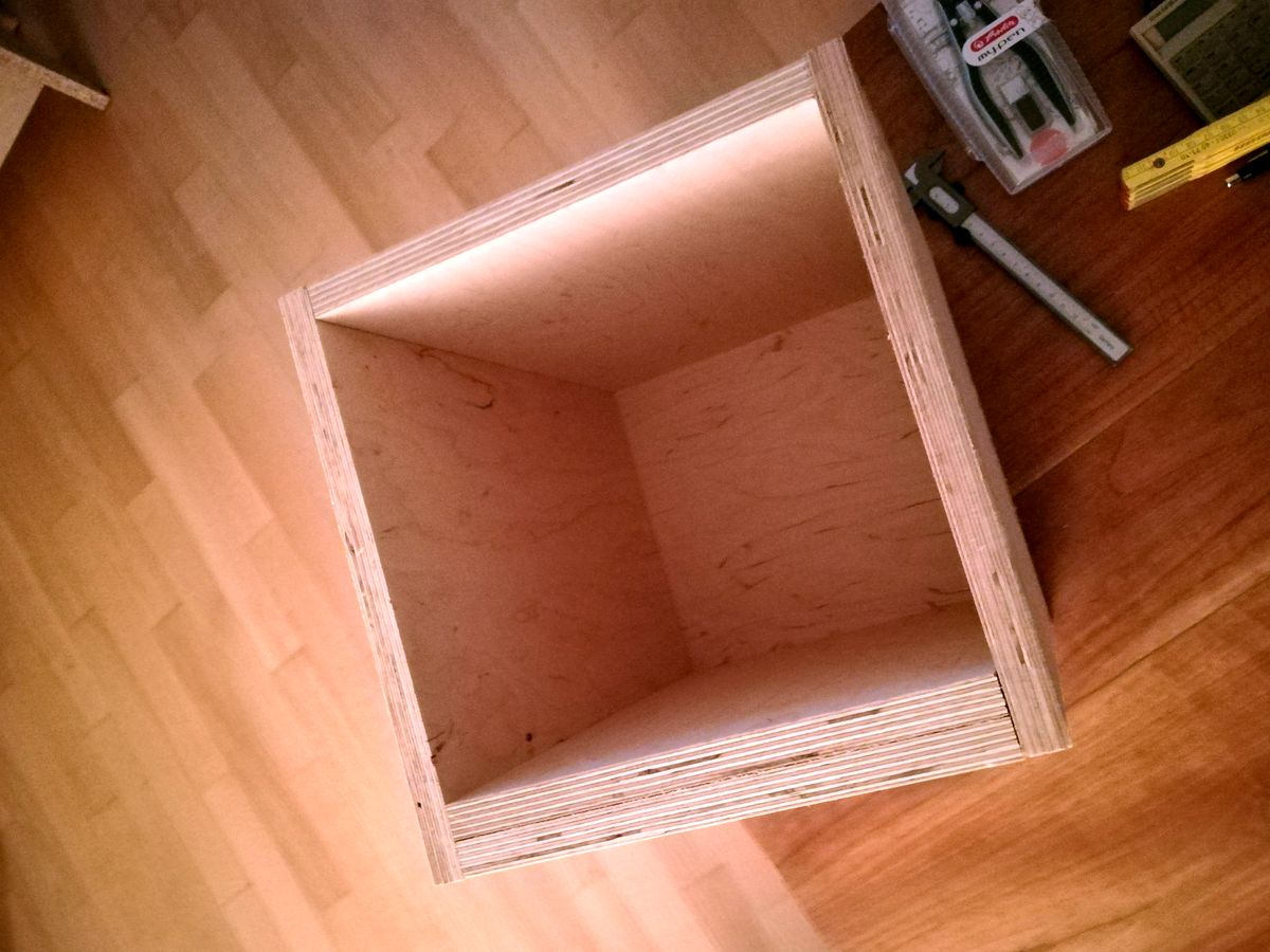

Finally made up my mind and I'm going to give Scott's original small reflex box a go (surprise!). Just minor adjustments to material thickness and bracing (see below).

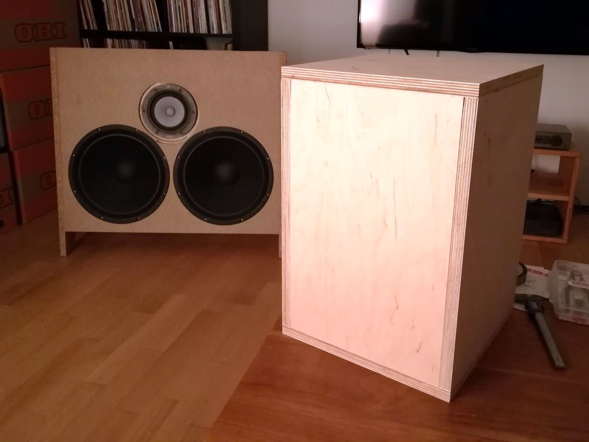

Background: OpenBaffles to be replaced. Foreground: Raw sheets stacked up to mimic the new box.
attachment.php

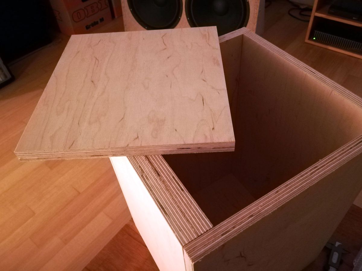

Material of choice is 15mm birch plywood all round. Baffle thickness doubled to 30mm. Certainly not the best quality plywood, as you can see. But it should be sufficient for a proof of concept.
attachment.php
For now I'll be implementing just one horizontal brace right behind the driver with no vertical brace. This stiffens up the "largest" panels (obviously), but - probably even more importantly - supports the magnet and spreads driver induced vibrations.
attachment.php
No cutouts yet, whatsoever. But of course they are going to come.
Why didn't I follow my original plan of using 12mm plywood with more extensive bracing? For one I lost a bit of my courage after reading too much about bracing right her in this forum. Plus I wanted a thicker baffle to ensure rigid driver mounting.
Highly braced, stiff cabinets are for subwoofers only, not for fullrange speakers. Bracing reduces the coincidence frequency. Shifting resonances up is always evil (except for subwoofers again), because this makes them more audible. This is what some obviously knowledgeable people seem to imply. After thinking about this for some time, I still think that there is a lot of wrongly applied science circulating. Light and stiff and heavily braced and damped cabinets are after all still what I consider to be the best possible solution. But right now I will go a more conservative way with my prototype speakers. Will be adding some damping to the cabinet walls as well. Let's see how this will turn out.

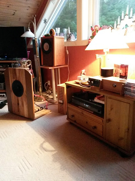

Hi everyone,

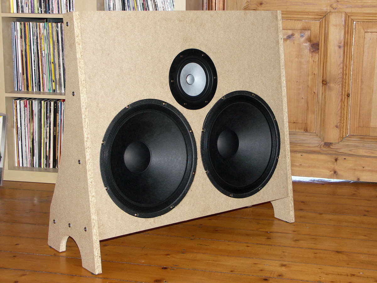

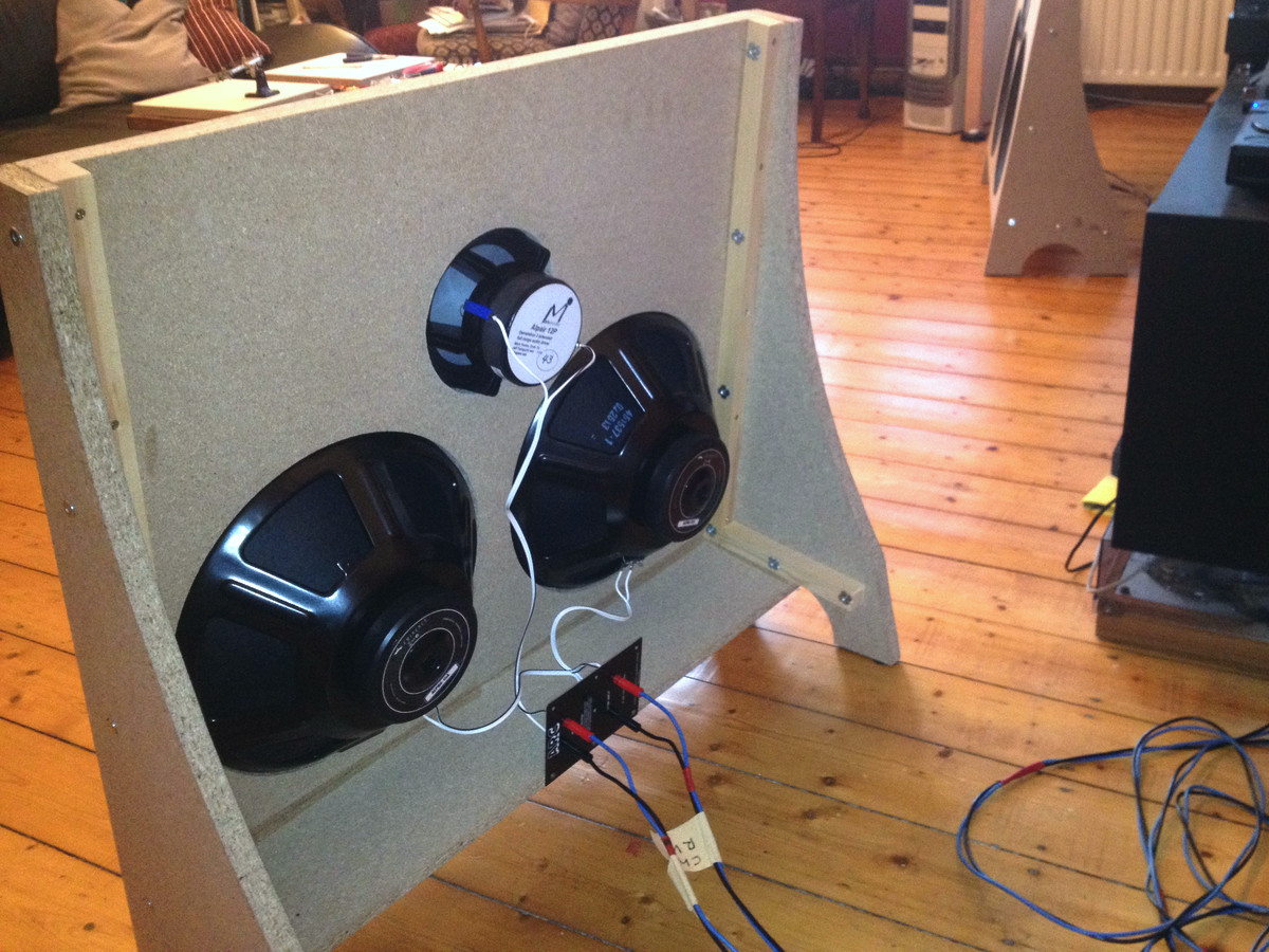

I'm currently using open baffles with 1 MarkAudio Alpair 12P and 2 Eminence Alpha 15a per side. The chipboard (these "prototypes" ended up serving me well for more than 2 years) was cut to closely mimic the dimensions of the Quad ESL. Add a MiniDSP and a pair of Quad 306: I like what I hear. Problem is depicted in image no. 3: They take up way too much space in my new, much smaller living room. 🙁

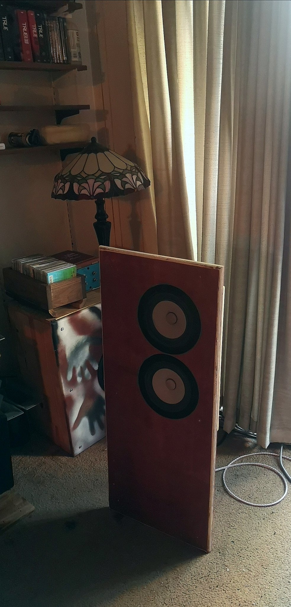

Today I finished the second baffle, guesstimated from a higher QTS 12 inch full range driver on a folded open baffle, sized for the baffle to act as a highpass.
For these baffles, I eventually cut down to 16 inches wide by 36
inches high.
3/4" plywood thickened to 1.5" thick where the drivers are.
Not sure if this is small enough for you, but it works mint for me, and using different wiring options, gives me some rudimentary tone control for various sources, 12P by itself, 12P in series with a 12PW, or 12PW by itself.
Any of these sound more natural to me than my original idea of a 12P wired in parallel with a 12PW wired in reverse polarity with a second order passive filter with using a 1.22 ohm air core inductor for added resistance .
About 350 Hz and down added to the output of the unfiltered 12P for a mild boost. This proved unecessary as the baffle size worked as hoped as a simple passive highpass for the satellites to meet a couple of subs I've had for a long time in distributed bass, 4th order lowpassed at about 70 hertz.
They sound better by far than the minimal effort in making them, after a couple of false start prototypes, and even satisfy my inner space cadet by mimicking 2 of 3 of the 2001: A Space Odyssey monolith dimensions of the 1-4-9 ratio.
