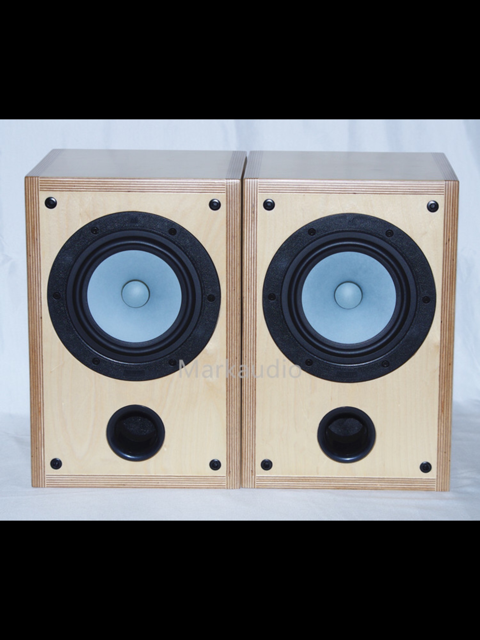

The MarkAudio store in Taobao (Chinese eBay) also sells finished speakers, or I assume they are at least affiliated with MarkAudio. The external dimension is given as 380*255*260mm. It claims bass response down to 27Hz. I’ve read that the 12P really needs a big enclosure.

With wall thickness of 18mm, a box of those external dimensions would give an internal volume of just under 17 liters. The port and bracing (if any) will take up a little volume also, leaving the net volume slightly lower.
I've listened to the Alpair 12P in a bookshelf of ~16 liters. With the Super Pensil, the bass extension and weight both are greater. If I am not wrong the Super Pensil for the Alpair 12P has a tuning of around 45 Hz?
My guess would be that for small cabinet, a Pluvia 7 can be tuned to around 45 Hz? Maybe Dave or Dr. Lindgren (Scottmoose) will be able to confirm?

The A12p fits optimally in a 17 litre enclosure. It has an estimated F10 of 50 Hz anechoic.

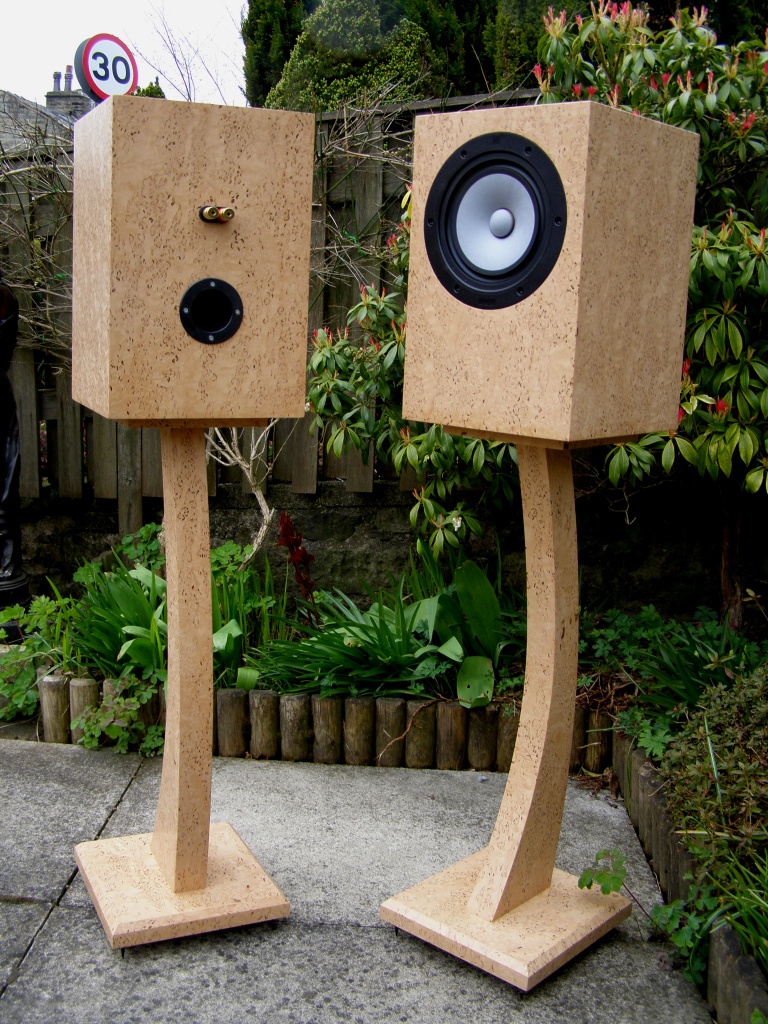

Joan should get near an octave lower. Pensils just a bit higher.
You have to be careful, Mark has released some OK, but not great reflexes. For a standard style, Dr Scott’s work is where i would start.
27 Hz is gonna need something like Joan and help from the room (a given).
But getting a decently built box with the right rebate is a start. You can start by trying it and then making it better. The ones pictured look to use decent plywood, from the external dimensions, just under 17 litres less braces (if any), and the vent. The back side of the cutout would need checking, chamfering that creats just about the same volume as the back of the driver takes up in the cabinet. Then one would make sure damping & tuning are appropriate.

Brace isn’t in the orientation i’d place it, and the back of the cutout needs chamfering (you can see that people have found this critical). A nit i would pick is the non-standard post spacing and that they would behard to remove.
Otherwise looks to be a solid build, and pretty.

I suspect it's a minor modification on the compact vented box I / we did when the driver first came out, with the vent shifted to the front (which partly misses the point of the alignment, but could be worse 😉 ). I still quite like this box; it's nothing fancy but takes off like a rat up a drainpipe.
http://www.madisound.com/pdf/SmallReflexA122p-191012.pdf
