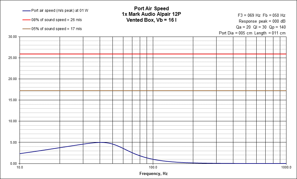

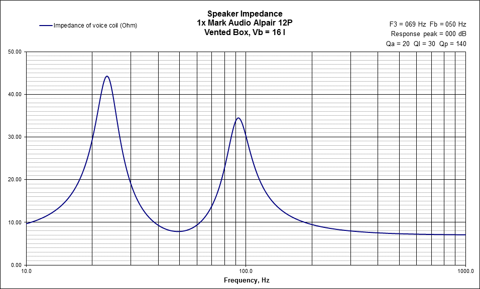

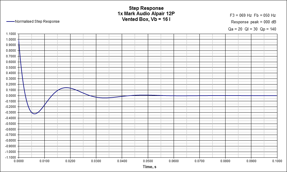

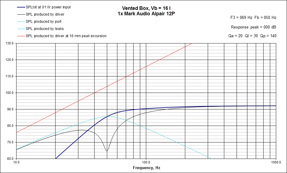

I'm not having any luck entering the driver parameters in my version of WIN ISD, was wondering if somebody could shoot some quick numbers for me.
Alpair 12.2P, Vented Cab, ~15L, single 6 sq in vent 1/2" long. Outside dimensions of the box are 9 1/2" W X 8 1/2" D X 15 3/4" H and 1/2" thick.
I was breaking in a pair of 12.2Ps and decided I'l mount them in a pair of old cabs I had, 2-way bookshelfs. I pulled the tweeter, that's the 6 sq in X 1/2" vent now.
Anyway, the things sound surprisingly awesome. A lot more bass than I would have imagined, and I don't run them very hard, I just want to see what the sim says about this.

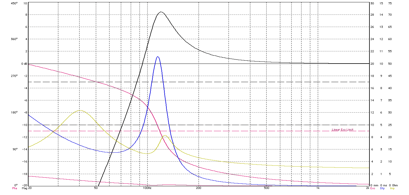

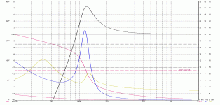

I suppose that I am going to confuse you more but....
I just got my pair of A12P's yesterday and it may be a while until they are in cabinets , but I did some modeling anyway. 15L is the QB3 answer, but I think that a 20-30L EBS alignment might better utilize the driver's potential. It will get another 10Hz of bass. I am looking at a proper MLTL with an F3 ~ 40Hz.

For BR duties I quite like ~16 litres tuned to 50Hz - 55Hz. Works quite nicely with gain from a typical moderate sized British room, or a higher output impedance amp.
.......but I think that a 20-30L EBS alignment might better utilize the driver's potential.
Agreed, a ~standard pre-T/S formula design routine from when tuning to Fs was the norm works particularly well overall with low Qts drivers, so 'cheating' with T/S I get 29.86 L/42.14 Hz Fb
