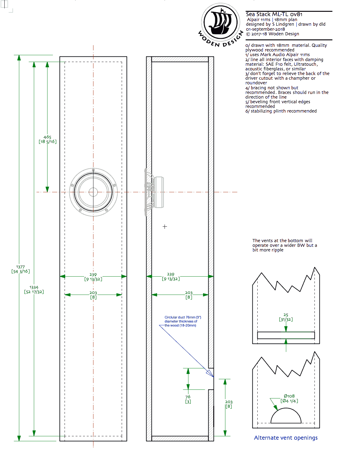

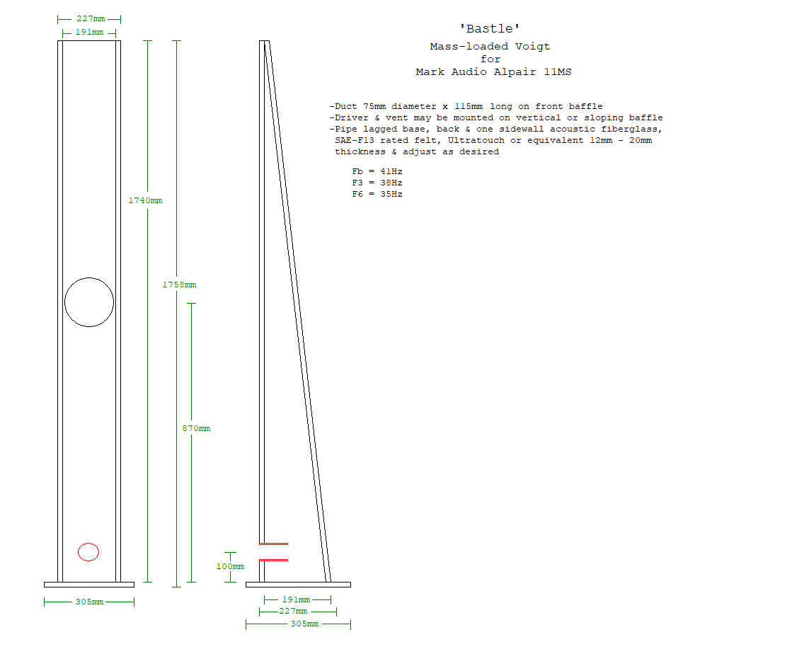

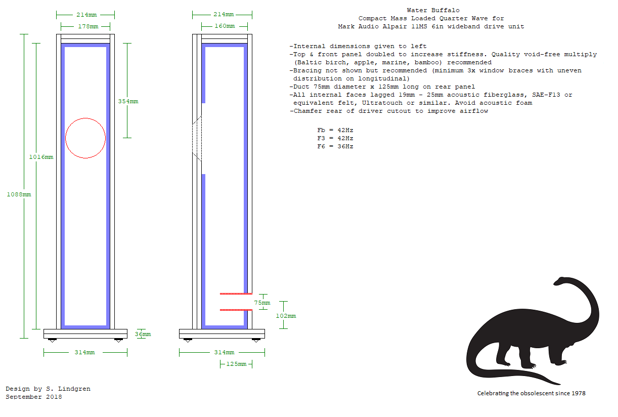

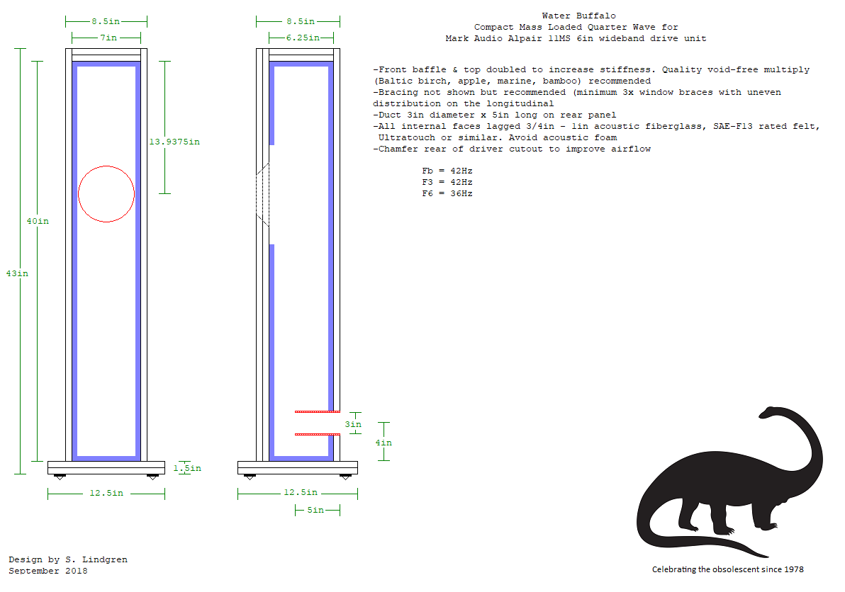

FWIW, a handful that I've done. They all get below 50Hz, with the smallest version of Nostromo (intended for high output impedance amplifiers) having the least extension, with an anechoic F6 of about 48Hz. The others get lower.

I see that 11MS has low Qtot. Best suited for bass reflex and MLTL.
Scottmoose has presented these as examples.
Pencil is probably also a type of bass reflex.
Pensil is a Mass Loaded TL.
The A11ms wants to be in a small reflex box, to get low bass out of them requires something like a horn or transmission line.
dave
dave

Ok pencil is a MLTL. Thanks Dave.
