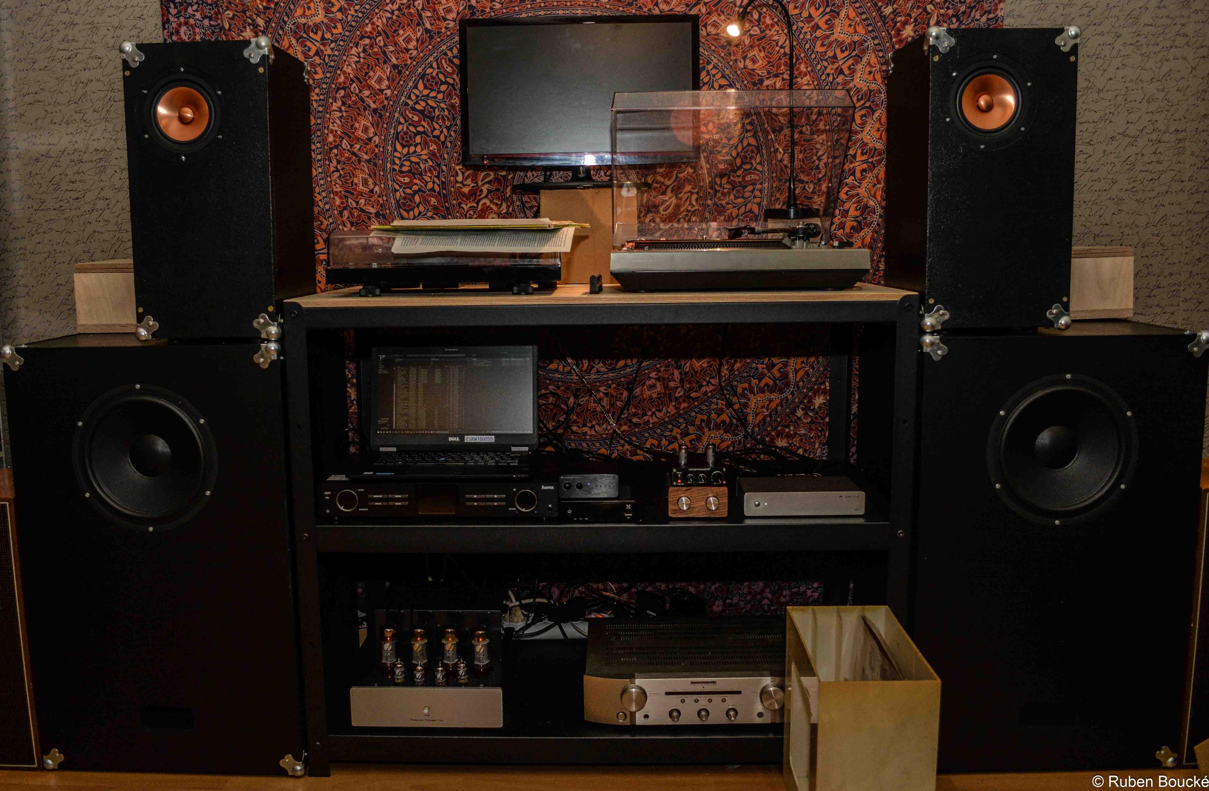

i use 10M gen 3 in a ported enclosure for years and it's a very good speaker with decent, but a bit vague bass. Half a year ago i build a pair of subs with an 10" Scanspeak driver tuned to about 25Hz with a passive 1st order crossover at 180Hz and this is a magical setup. I power it with an Prima Luna Prologue 4 (35w PP amp with EL34 powertubes).
I would also go for a Alpair 10, and i like the metal way more than the paper one. I've build copies of the tops with the 10P for a friend (who tought it would be better), but had to change them to 10M after halve a year because he liked them also more. I will redo my tops but more fit to the sub (lower and wider and front ported, but the same volume).
