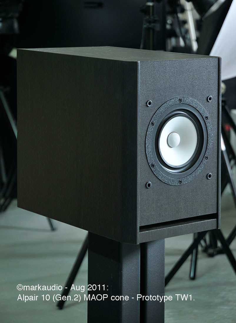

As a beginner in DIY, i'm planning to build a bookshelf fullrange monitor with Alpair 12P or 10P.
The front-end is an Audio Note DIY DAC, the amp is an DIY Altmann BYOB.
The room is 22 sq meters, most often listened music genres are classical musik, jazz, opera, occassionally some "tougher" music (e.g. Depeche Mode, Synkro, RATM, Everlast etc.).
The LF will be supported with my REL T5 subwoofer and my intention to get a tube amp in the near future.
Which would be the better choice?
THX in advance!
(sorry for my english)

I used the 10P 3 yrs ago and pretty happy with the results. The top end was a little soft to begin with but they opened up nicely.
I'd certainly second the recommendation for the 10 over the 12 - although I now tend to favor the metal over paper for its extra detail and extension at the top end. Of course, my hearing is damaged by years of industrial tool noise, and I need all the help I can get in that last octave above approx 10K.
Then there's the question of enclosure. Even if using a powered sub and high-passing the Alpairs,I've always preferred them in a floor stander as opposed to bookshelf / stand mounter - find they deliver "more authoritative mid-bass" dynamics. Sorry - that's my audiophool tweak speak escaping - try to avoid it, but sometimes is leaks out around the seams.

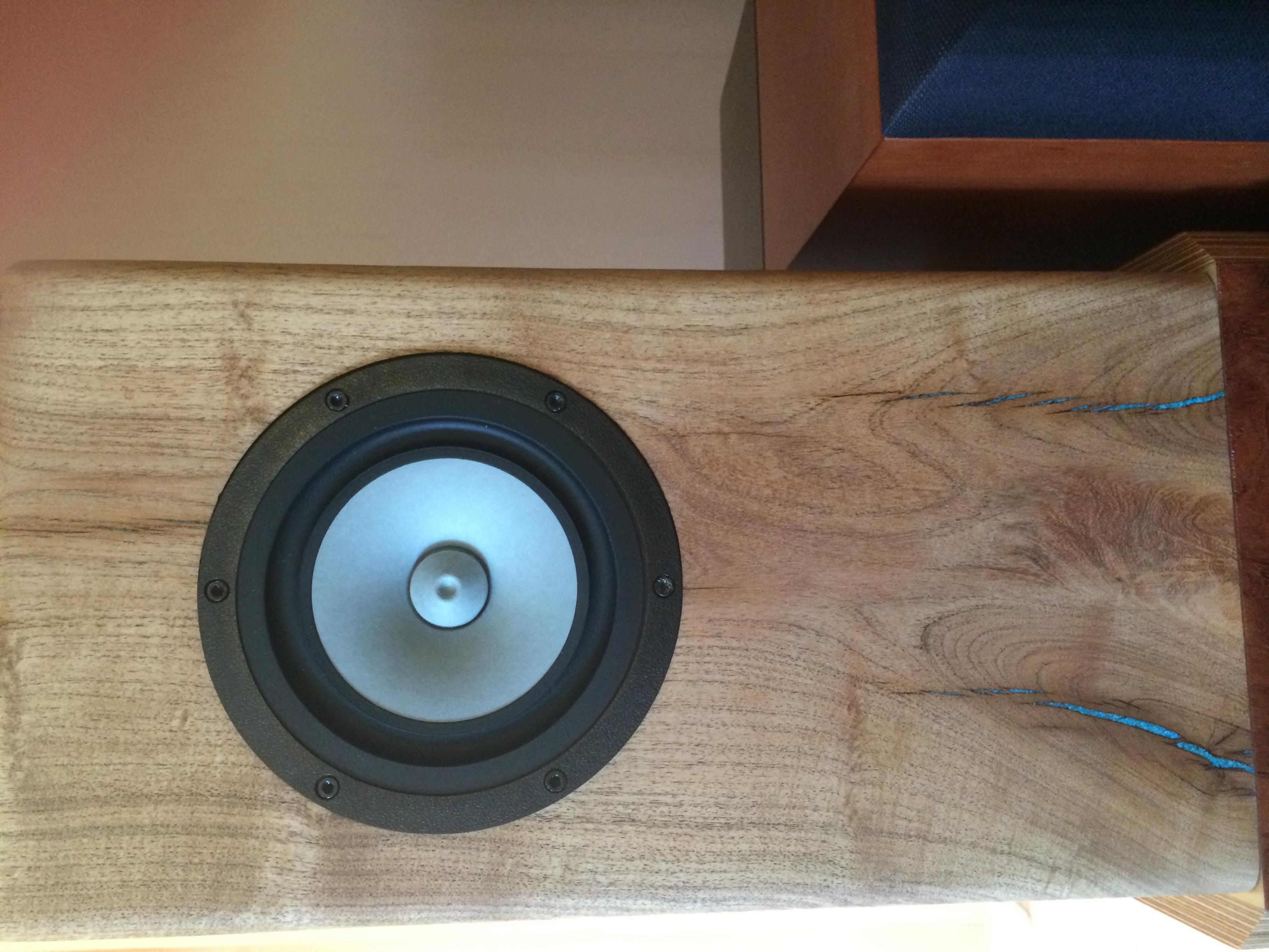

I was using 10.2M for several years and just shift to 12P. It goes with my 2A3 SET very well without any harsh or detail-missing. No experience with 10P.
While paying a bit of a penalty of sensitivity over the 12P, I personally prefer the 10P . I find it delivers deeper extension in much more manageable sized enclosures, and my choice of amplifiers has changed over the past decade, and I'm hardly ever using any of my tube amps - certainly not the flea-watt varieties for which the 12Ps in fridge-sized enclosures can absolutely be captivating/ seductive - so the sensitivity is not really an issue.
Most enclosure-master here prefer the 10P in terms of performance. I think they are right if not using low-power tube gear. Personally, I kept away from SS amp when possible. A tube PP amp may serve 10P well with SW help.

Both are very well done, congratulations!For a bookshelf I'd go for the 10P....they sound wonderful and don't seem to require the internal volume to bring out the lows like the 12P....I do quite like the 12P in the regular pencil...
I'd recommend the 10p as you mentioned using a subwoofer in your setup. The 10p delivers a better top end (to my ears) and should perform better off axis.
The 12p is a nice driver and probably worth considering if you could deal with a larger enclosure and did not have a subwoofer to supplement the bottom end.

As for the 12P /vs 10P, I’ll reiterate myself - I found the latter much easier to worth with in terms of enclosure size.
