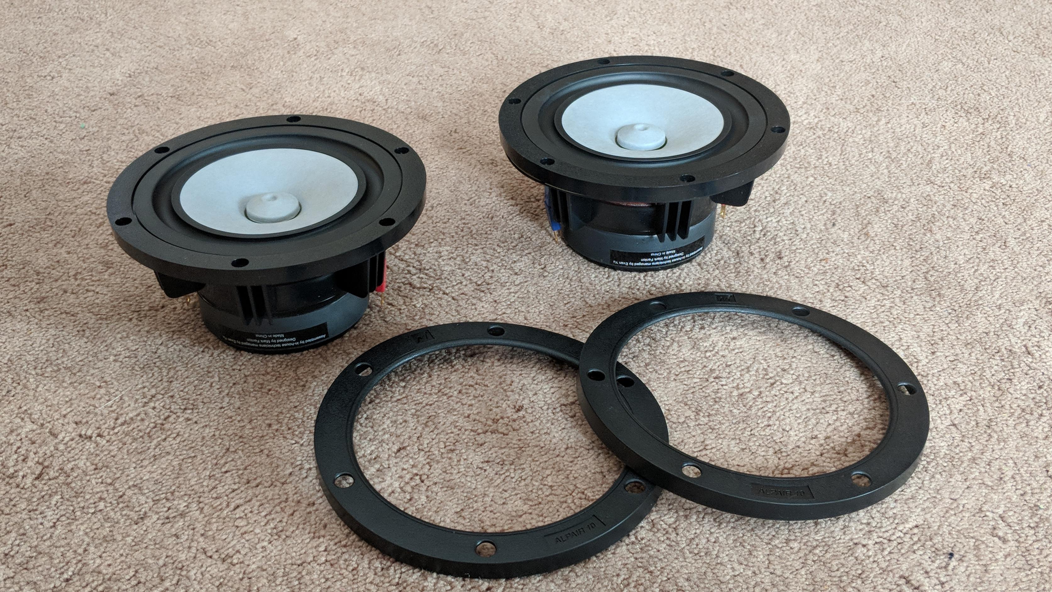

ok just got the Alpair 10p!!!
nice looking speaker. very well built. there is a plastic ring that seems to go on the front of the driver... is this optional?
… a plastic ring that seems to go on the front of the driver... is this optional?
Yes, the cosmetic bezel cover. It is optional, we do not use them.

ok sounds good. just noticed they come with its own mounting screws... should i use an t-nuts for these or just screw them directly to front panel?

The provided wood screws work fine, especially if you build with plywood. Bolts & threaded fasteners (after the 1st time you have a t-nut failure you will be unlikely to use them again).
Brass, stainless steel, or plastic would take things a step up (non-magnetic).
When tightening screws or bolts do not over tighten. They should only be tight enuff to hold a real or imaginary washer from spinning.
dace
dace
I quite like the supplied mounting screws, and the only suggestion I’d make - particularly when using either Baltic Birch plywood or harder solids for the baffle- is to drill a carefully sized pilot hole, and pre-tap the screws before installing the drivers. If you don’t already have one in your tool kit, I’d recommend a T-handled hex driver - 3mm if I recall correctly.
