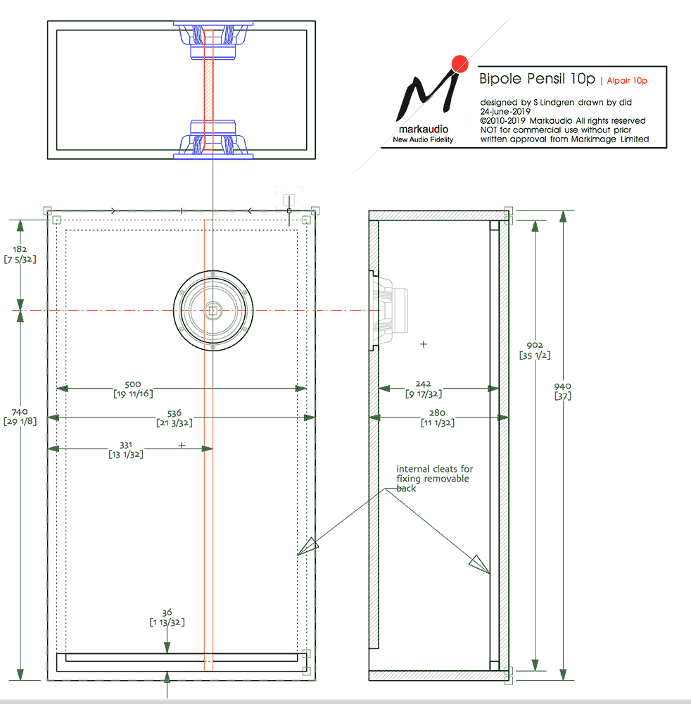

For the A10p in a bipole one’s 1st thots go to a Pensil derivative. But i expect it might be too large. Here a quick sketch:
Probably more practical to double Jim’s A10p ML-TL. As thorough as the TLb artcle is it did not reveal the bipole dip. Making the box wider than deep helps minimize this.

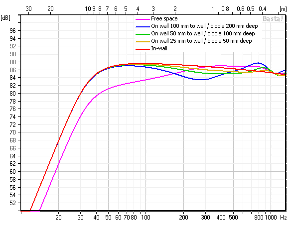

OK here goes, the dummy in the house is going to ask: is the bipole dip the flip side of the dipole peak the OB crowd is on about?
No. The bipole dip is the decrease in response caused by the phase difference at a frequency related to th edistance between the back driver, the front driver, and the shape of the box. It decreases as one moves off-axis such that when one is “looking” at the side, the dip goes away completely and the 2π>4π transition is perfectly dealt with (ignoring the room).
A sim (not mine)… IIRC the box x-setion is square.
Box dimensions can often be juggled to push the dip down into the region where room effects swamp.
