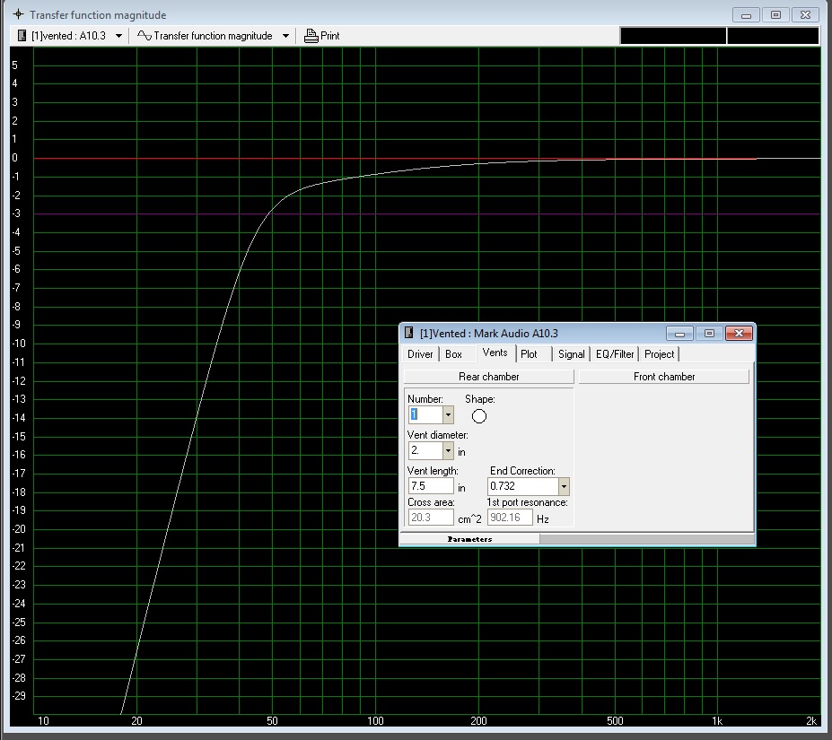

Hi there,
Did not know where to ask, this thread seems to have something in common with the issue that I have.
I built a BR box for Alpair 10.3. (In fact, I used some "Technics" two-way boxes. )
The recommended port size is, if I got it correctly, 50mm diameter and 160mm length.
But, the existing box already had a port on front, albeit 40mm diameter. As it was initially too short, I added a pipe and made it around 160mm long.
Now I realized that I have mistuned the box. If the BR port diameter is smaller, the port would have to get shorter in order to keep the same tuning frequency.
But, the question is, how much shorter?
Maybe around 100mm lenth (or, more, or less, I have no clue). Any idea?

In order to guesstimate a decent alignment, could you tell us the enclosure volume? If I just ignore volume, and plug your 40mm port in, I end up with a stab in the dark of 133mm length, for a QB3 alignment in a 10.7l enclosure.Hi there,

Unless you are going to really dig into this, my advice would be to figure a way to add 10mm sections of pipe, and just listen to it with as many lengths as you want to try. Taping the lengths would probably work just fine for testing purposes. Main thing is try to avoid any gaps where you'd lose some air pressure.
Hello,In order to guesstimate a decent alignment, could you tell us the enclosure volume? If I just ignore volume, and plug your 40mm port in, I end up with a stab in the dark of 133mm length, for a QB3 alignment in a 10.7l enclosure.
Enclosure volume is close to 15 L. A bit less if we account the volume taken by the driver. So, between 14 and 15 L, we could say...
Trying different lengths would be best, but it is a bit tedious.
I will try to cut it to 130mm and see what happens...

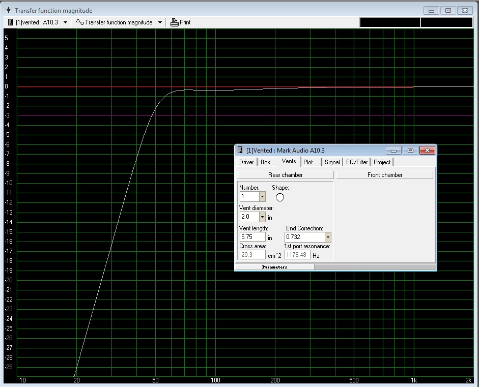

Calling it 13.5L, allowing for driver and vent vol., here's a quick sim with a 100mm long vent. Series resistance is .5R. Looks ok.
