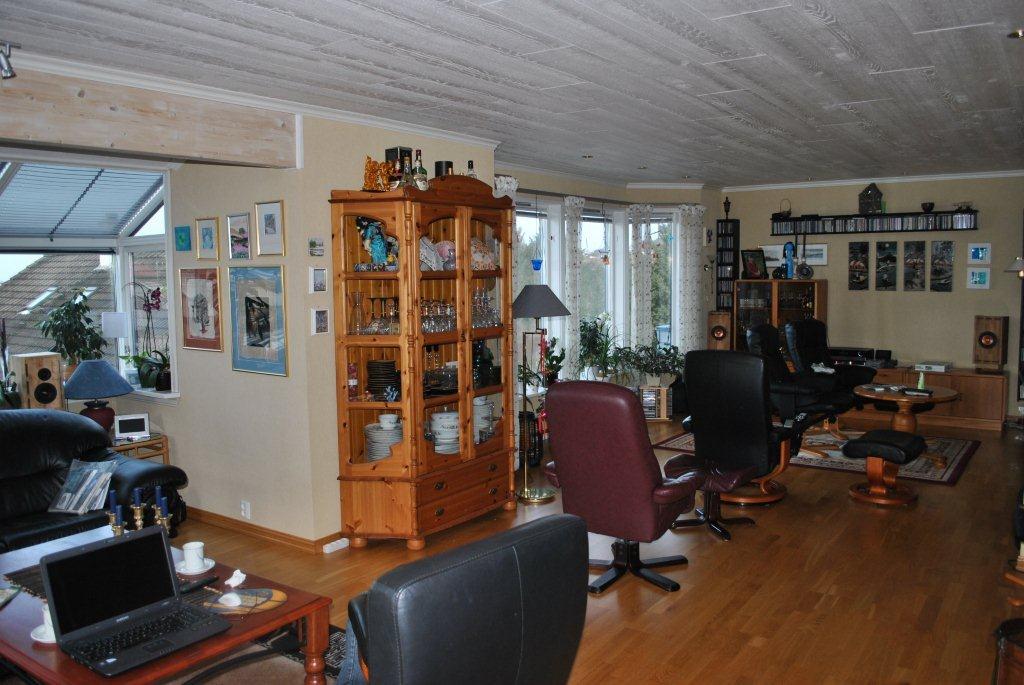

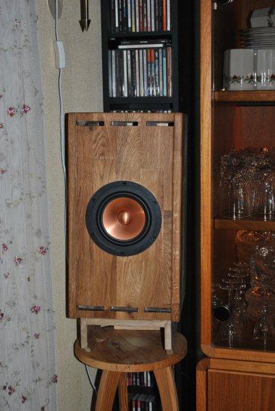

Almost finished with Alpair 10.2 in 17liter ported box. I have to make som small adjustment on the outer finish!
This very revealing couple has been running with low volume for 5-6 days now. Have tried some (carefully) higher volumes - and it is a thrill to experience the openness and involvment that this couple gives!

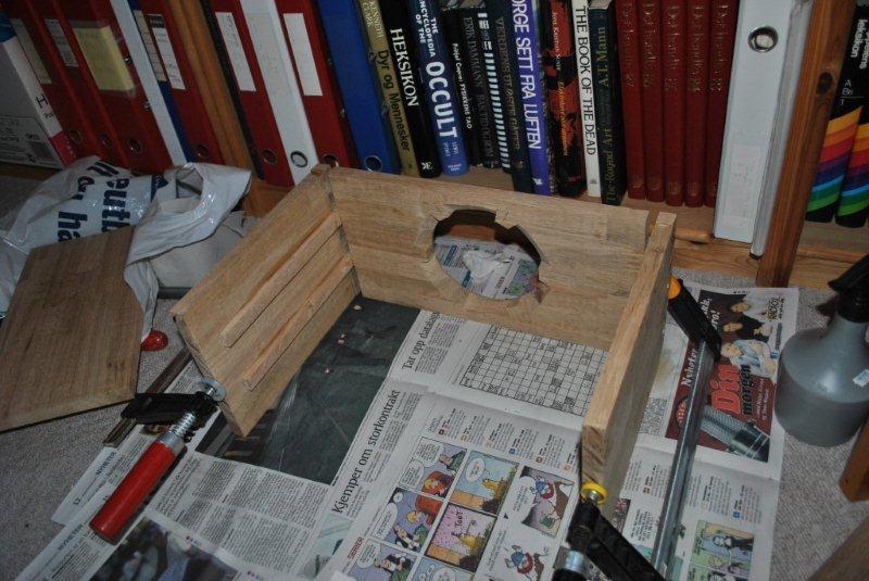

I have made the back of the boxès removable and I have made ports in a way that it can be adjusted. My photos will demonstrate this - if you`re interrested?
Got a 10-12 fairly good photos. I will include 2 now - and I have a schetch of my building/design!
I was never expecting the Alp10.2 was to make a major leap in sound from my Fonken w/fr125sr and ERT26 - but they are making great advancement toward just that goal.
So Cowboy Junkies is just here in room when the Alp10.2 is making them stunningly alive1
Thanks again Mark!!
Olav

Yea - as wanted!
Hi!
They are made from Oak - 18 mm. In Norway they are called HobbyPlates. I think they are laminated and glued. Very stiff - and somewhat harder than birch!
Gives a very sturdy "think" sound when you knock on it! Birch is softer and a bit darker in respons!
But the sound from Alp10.2 in Oak is magnificent!

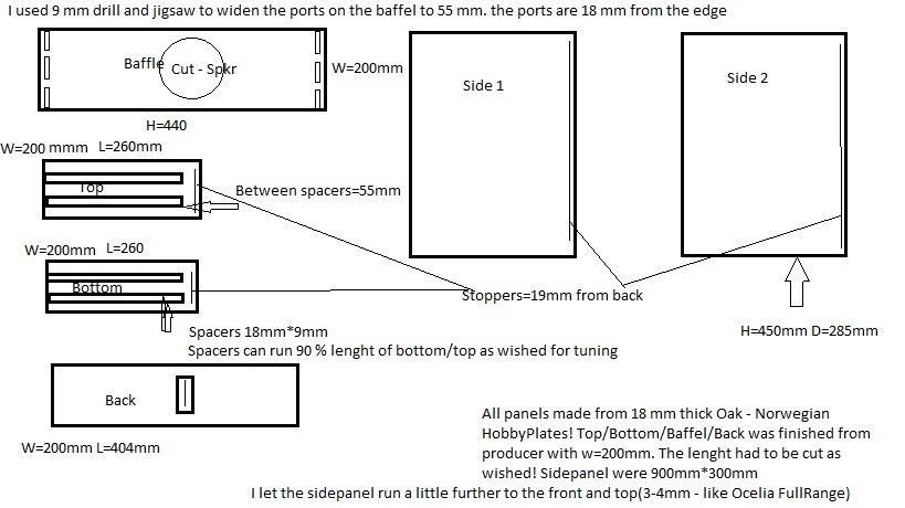

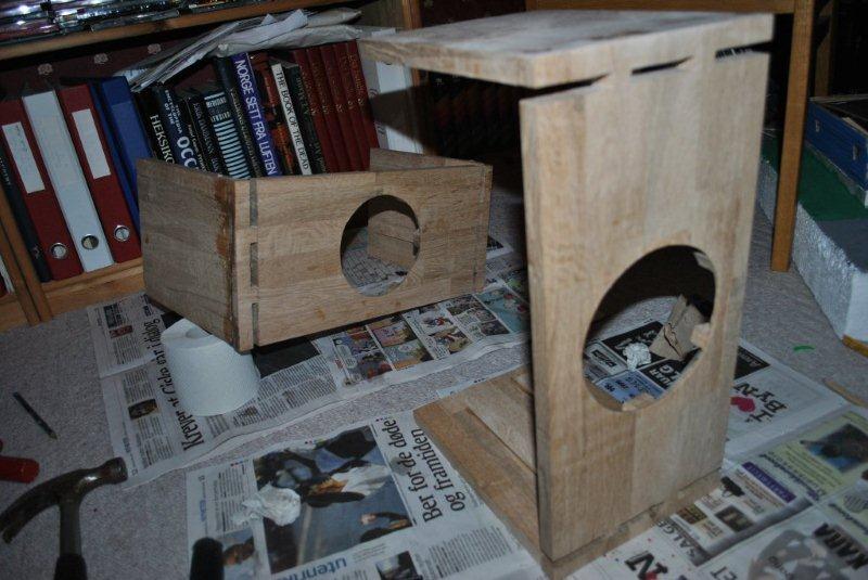

Plans & pics
Hi to all!
Here are some more pics + the plans I made. I made the ports in 1 lenght and can tune it if I want - by adding short plates further back against the wall. The bracer on the driver is glued to the sidewalls and with additional bracers against the fasteners that the removable back is schrewed into.
Got som ideas from T.Gee`s Solo103 and the Fonken for sr125 and MarKen to Dave(Planet10). Thanks Dave!
In my living room(9 m long and 5-6 m width) the volume and dynamic is VERY good. I still don`t play very loud - family and else is some reason - but these pleasant-sounding devices fills my room like I never imagined!
One little question remains: My HarmanKardon HK980 is very dynamic(2*80W and 80 Amp) - but if I want to build an amplifier - what would that be: Tube, D, T or a hybrid?
If someone know about a brand that isn`t to expensive or to diificult - I would be very grateful!
I looked at Elekit - but the easiest to build is not for 230 V. And I don`t know if it is wise to use a converter from 230-110V? Because maybe the transformer need 110V.
All the best to everyone.
Olav

a little more...
Thanks Mark!
Will try your suggestions when it is convenient.

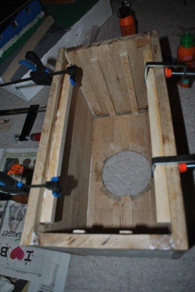

And I have added some more pics to show how I fastened the side-panels to the baffel! With small woodsticks(like the ones that come with furnitures) - drilled holes and used strong glue, so it feels like it has more hold.
And as you can see from the other photo The Alpair is so small(maybe a Pensil next time - if we don`t move to a smaller appartment) - but the sound fills the room at 45 sqmeter even at moderate volum. Just now Golden Heart with Mark Knofler fills the space. The HK980, squeezbox touch, dacmagic is positioned in the middle!
In the other part-corner you see the Fonken(wFr125srErt26)- which is secondary today. But also very good!
Been a very nice experience - building sound thats so good!
Best to all

sorry - wrong info
Hi all!
Some misinformation: It is the Bottom and Top-panel that is glued to the baffel with woodsticks!! The sidepanel is glued to top/bottom/baffel after those three is fastened! And without woodsticks(more difficult to keep the holes aligned to each other)
Best to all
Olav

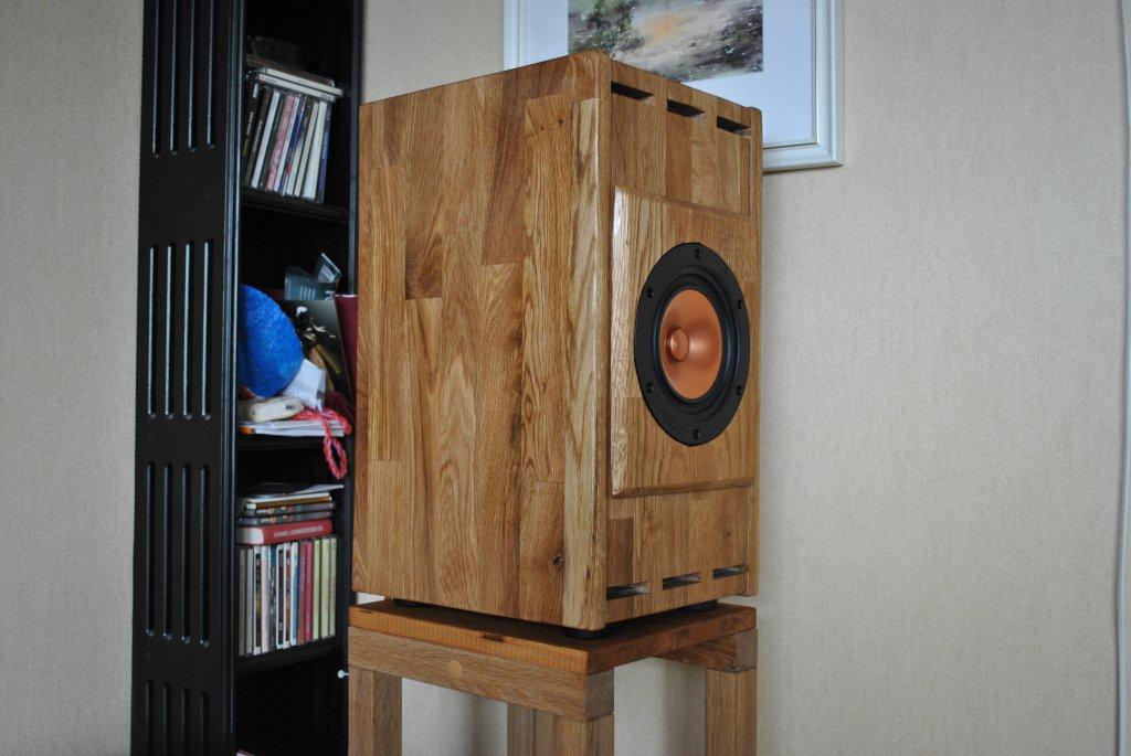

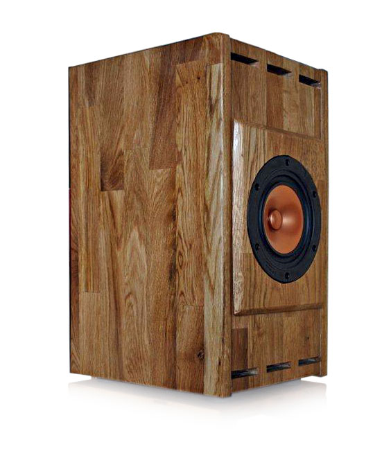

Flush driver & tuning
Hi there all!
Have now tuned my speakers to 43Hz, and when I`m using Stereophile TestCD I can hear relative strong output at 50Hz - and a little weaker at 40Hz. No output at 30(as expected). And the 3-dimensionality is much more improved after I made the flushmounted baffle. Like the picture show! And I made some stands from a cheap IKEA support(it costed 12 dollar). Gives a better and more distinct sound!
Now they are nearly finished - need to get a new upper plate on my stand. Oak to keep everything more even!
And the sound is very fullfilling - SingleDriver is king. (Wonder if Alp10.2 in FrugelHorn MK3 is more revealing than this?)
Maybe at a later time......
Greetings to all.
Olav

Tnx Dave and Mark(for editing)
Hi again!
Thanks Dave for info. Will see then when and if the Frugel for 6" driver materialises! And thanks to Mark for editing(could have done it myself - even without Photoshop - have Picasa and PhotoFiltre) - but wanted to show the stand with speaker!
Even my wife think they look good now - earlier she fancied my Fonken with FR125sr w/ERT26 MORE than she did with my last build.
But luckily - now both Style & Sound in my 10.2 is in a special class, the flushbaffle gives it a more refined look, and it made the sound more tranparent in the room. Satisfied with the look at last!!
Best to all!
Olav

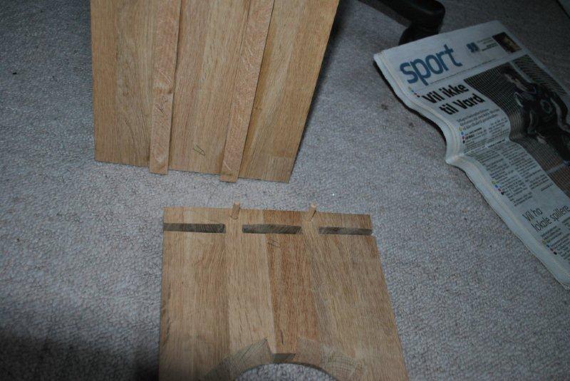

Question about the ports
Olav -- very inspiring, to me epitomizes what FR can be about. I have a question about the design of the ports.
Is there an interior baffle on the top and bottom, across the top of the sticks, that creates 3 long, narrow onken-style" tubes", top and bottom?
Thanks, John
Ports....
Hi John!
Yea - there is some kinda baffel(or a plate 200mmx150 mm - 150 is about) over the wooden sticks. So one gets 6 150 mm long and 55 mm wide ports. 3 on top over the the driver and 3 under!
I used the same oak as I used on the baffle, back and top - but I saw off some so it got 3-4mm thick.
I have photos from this also. I am offshore (Telecom in the Nothsea till next thursday) - but then I`m home for 4 week - so I can post or send more tips if some is interrested.
And I tuned it to around 43Hz cutoff - but I can hear somewhat weak output at 40Hz - so there is possibilities with making the ports longer if you take short 200mm wide plates and lay over the wooden sticks. The wooden sticks is nearly reaching the back of the box.
I`ll show you in a weeks time.
Greatings to all!
Olav
