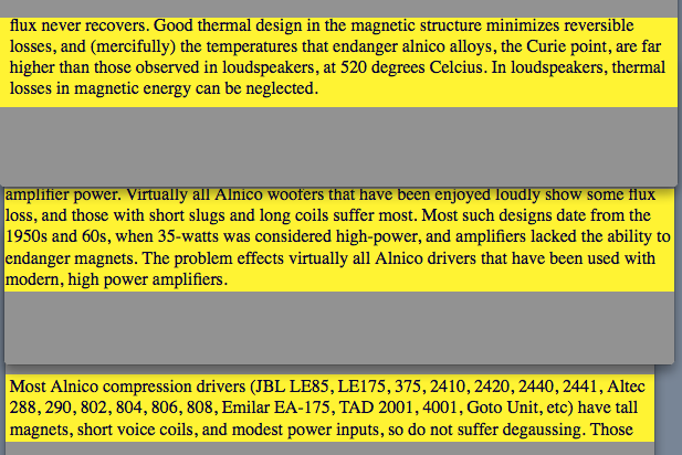

Not a thermal thing but more to do with its resistance to demagnetization related to its operating point. It was a bit random because you don't know where the signal would end up with your short blast, positive or negative.
I distinctly remember both Greg's approach, and seeing the curve difference. I thought this was a well known phenomenon and that people offered remagnetizing services? <snip>
I use JBL alnico drivers in my system and can confirm all of the above from direct experience. Alnico woofers are quite likely to partially demagnetize if driven really hard.. Not so likely with well treated vintage home hifi gear, but if you are planning on buying and refurbishing JBL pro drivers you should plan for the contingency that they need to be remagged.

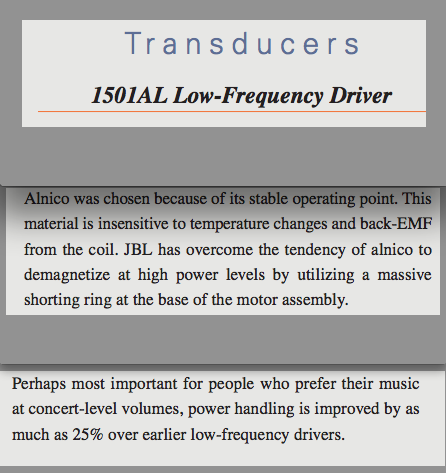

The references would explain why I had not experienced the demagnitization in Alnico units I used:
"Alnico was chosen because of its stable operating point. This material is insensitive to temperature changes and back-EMF from the coil. JBL has overcome the tendency of alnico to demagnetize at high power levels by utilizing a massive shorting ring at the base of the motor assembly."

The "back EMF from the coil" would be a reference to flux modulaton distortion, as cured by the aluminum ring. Alnico is inherently imune to that and apparently better with regard to Curie effects (hot).

According to GT overpowering of Alnico magnets happens when back emf created by high current in the voice coil pushes the field "below the knee" from which it does not bounce back. Overhung voicecoils driven hard by a high current amp can create this condition. Underhung coils in woofers and the voice coils in compression drivers and horn tweeters do not. Smaller woofers with overhung 3-inch voice coils like the LE10A family are particularly susceptible.
The JBL 1500AL family; 2220/130A,B,C (barely), LE8T, LE15/2215, and 1400ND (neo) are underhung. Altec 406, 414, 416, 515B are underhung. JBL 2230, 2231, 2205 Alnico's are overhung. Some of the special measures in the 1500AL were taken to deal with the swayback character of Alnico woofer FR, not demagnetization.
