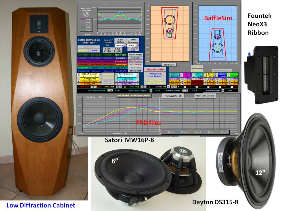

Vortex, I tried to meet your stated goals.
BUT.... Read Geddes paper on controlled directivity, and share a look at designs which reduce room interaction with your Dad like Fusion-12 EconoWave and the larger Tweek Geeks BMF-1
*Avalon style low diffraction vertical baffle cabinet. Google: Avalon diy speaker images
*Tweeter Ribbon = Fountek Neo X3 (Rock&Roll durable, $110)
---(LR4 electrical at 1900Hz)
---(time delay Xover circuit)
*Midrange = 6" Satori MW16P-8 in sealed 0.5cuft volume ($130)
---(LR2 electrical at 190Hz since sealed alignment and baffle step will also attenuate)
*Woofer = 12" Dayton DS315-8 in sealed 2cuft volume ($80)
---(BW3 electrical at 190Hz to attenuate any midrange grunge(reverse polarity))
---(include 20Hz Qtc=0.7 LinkWitz Transform bass boost crossover circuit)
---(include baffle step compensation Xover circuit)
---(explore room compensation circuit)
*Active crossovers cannot correct lobing from large Center-to-Center driver separations or baffle diffraction effects. This Avalon style cabinet is optimized for diffraction control. There are several diy-copy drawings on the web which you can give to the cabinet shop.

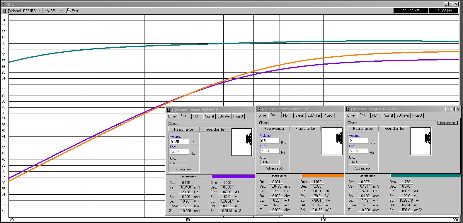

*WinISD plot for sealed Mid, and sealed Woof with 20Hz LinkWitz Transform provided to show good efficiency match.

Made some calculations for the most critical part - bass. The small increase in SPL peaking at ~130Hz is the "Simulate voice coil inductance"-effect of WinISD. True or not, that's it for now.
I played around with the parameters and I'll probably go with the red line version - 600 liter box, tuned at 24Hz. It's also ideal, somewhere around an almost 1 meter long cylinder with a 18" diameter (like the speaker itself). I might correct the bass section with gain on the filter side - or even leave it as is.
You want the FR of the enclosure flat. In this design you loose 3dB of bass output.
Ideally you want to look at the datasheet of the speaker where the speaker rolls off like 3 to 6 db and then tune the box so it will have a 3 db boost a little lower where the speaker rolls off and the port will make a flat curve in the end and extend bass range for free and flat.
