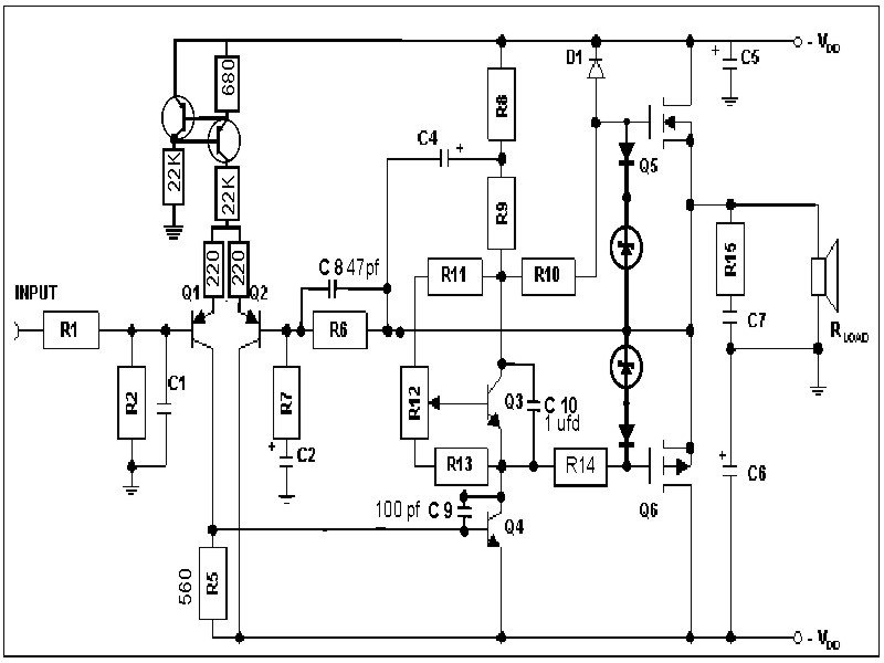

Dear DIY friends,
I have tried to incorporate all the changes and additions to AM 948 mosfet amp as suggested. It is recommended for 40W/8ohm & 60W/4ohm. I think this is final. Kindly suggest if there are anymore suggestions or modifications for happy DIY project.
