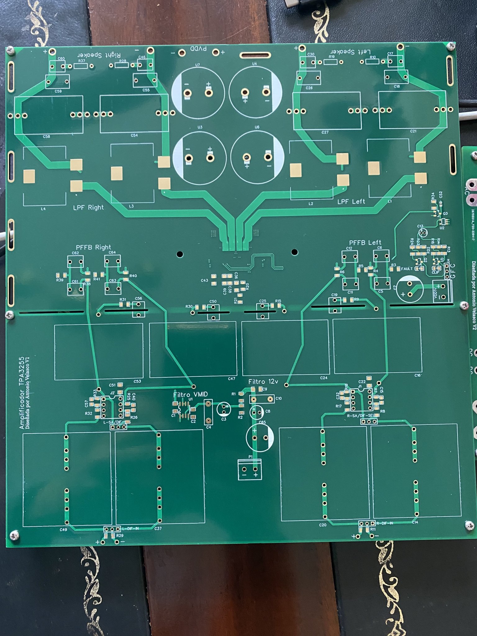

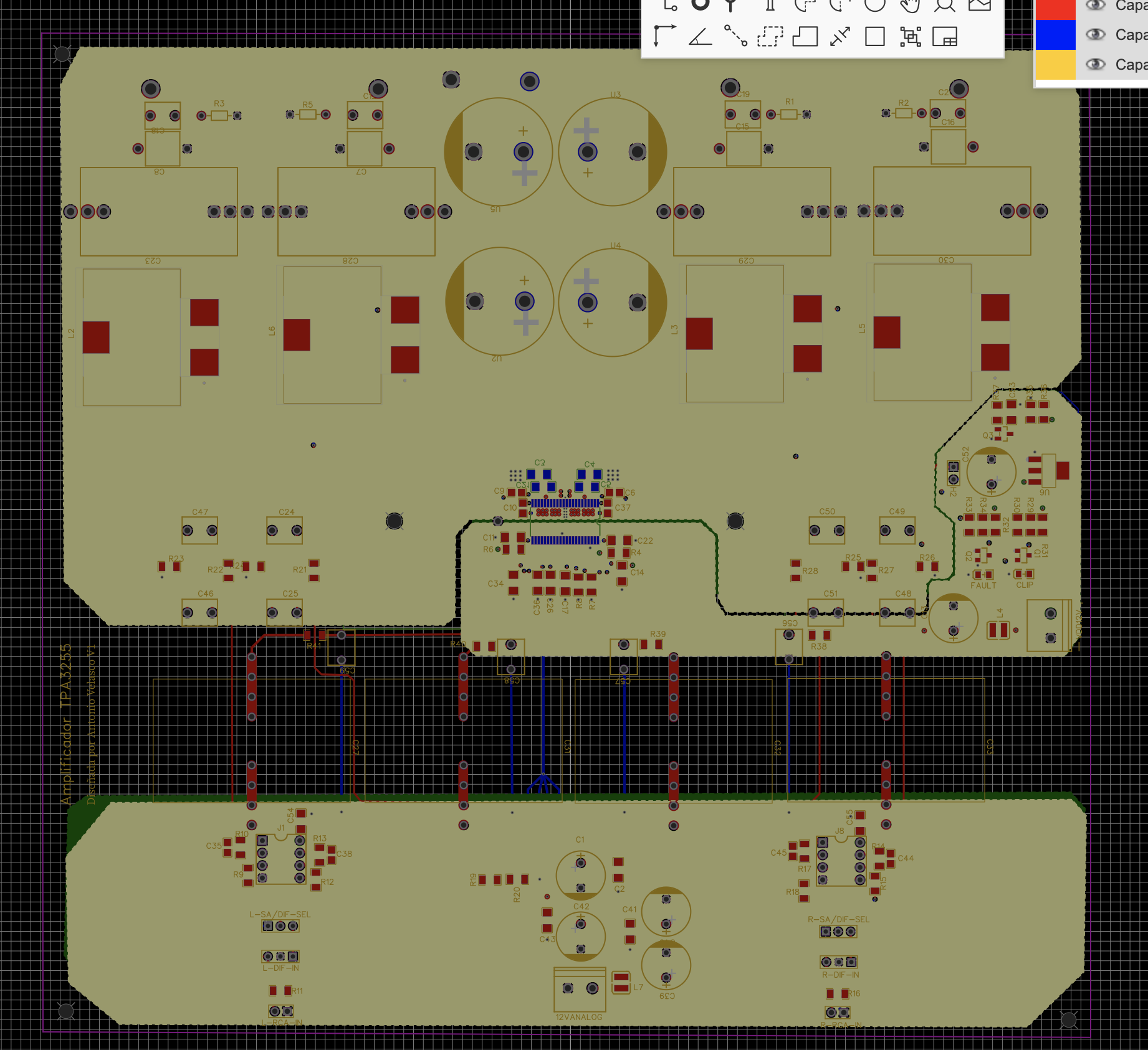

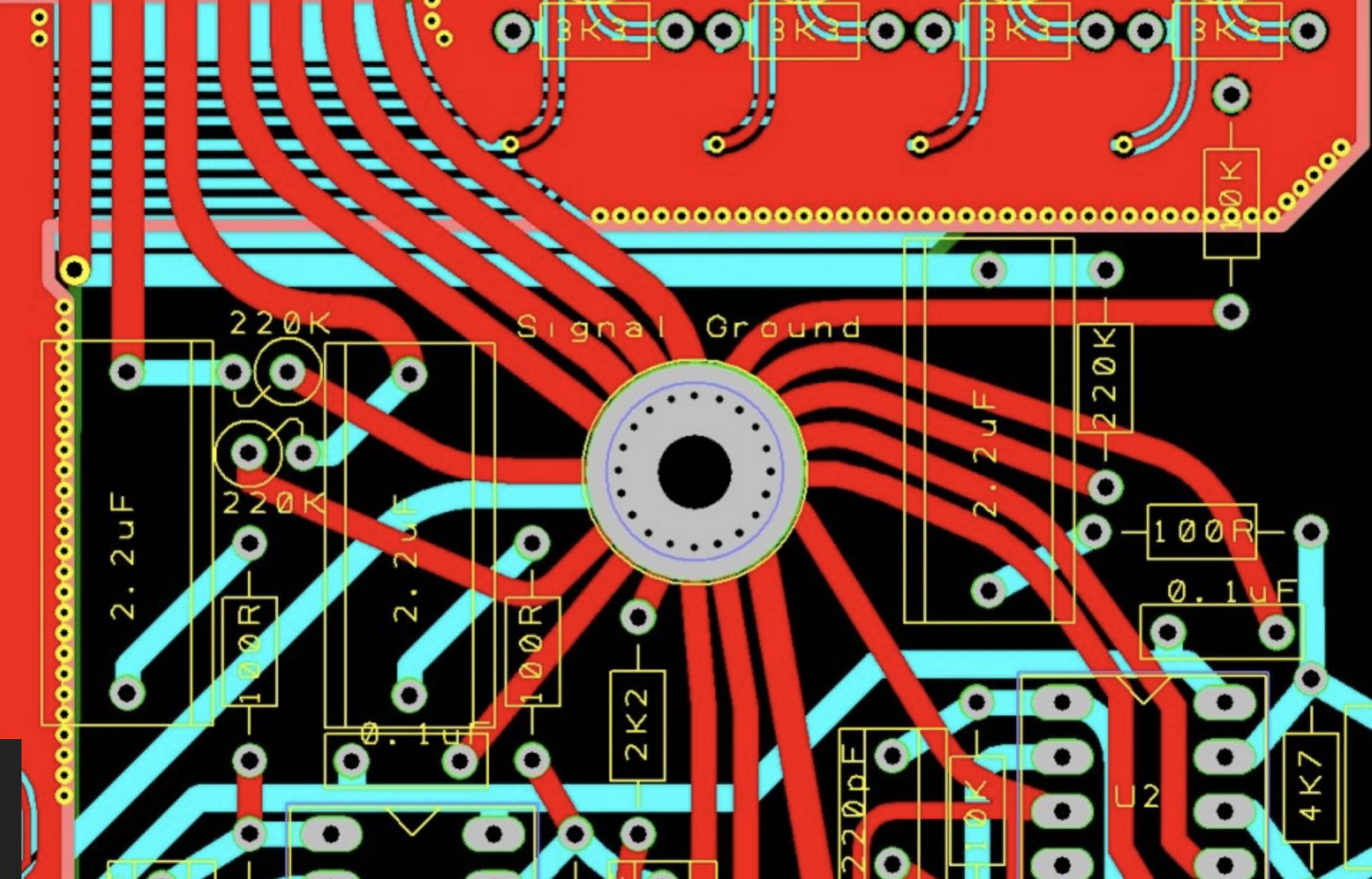

This project is a step by step process
2 months to buy all the parts
4 months to design and improve the PCB
This is the latest advance

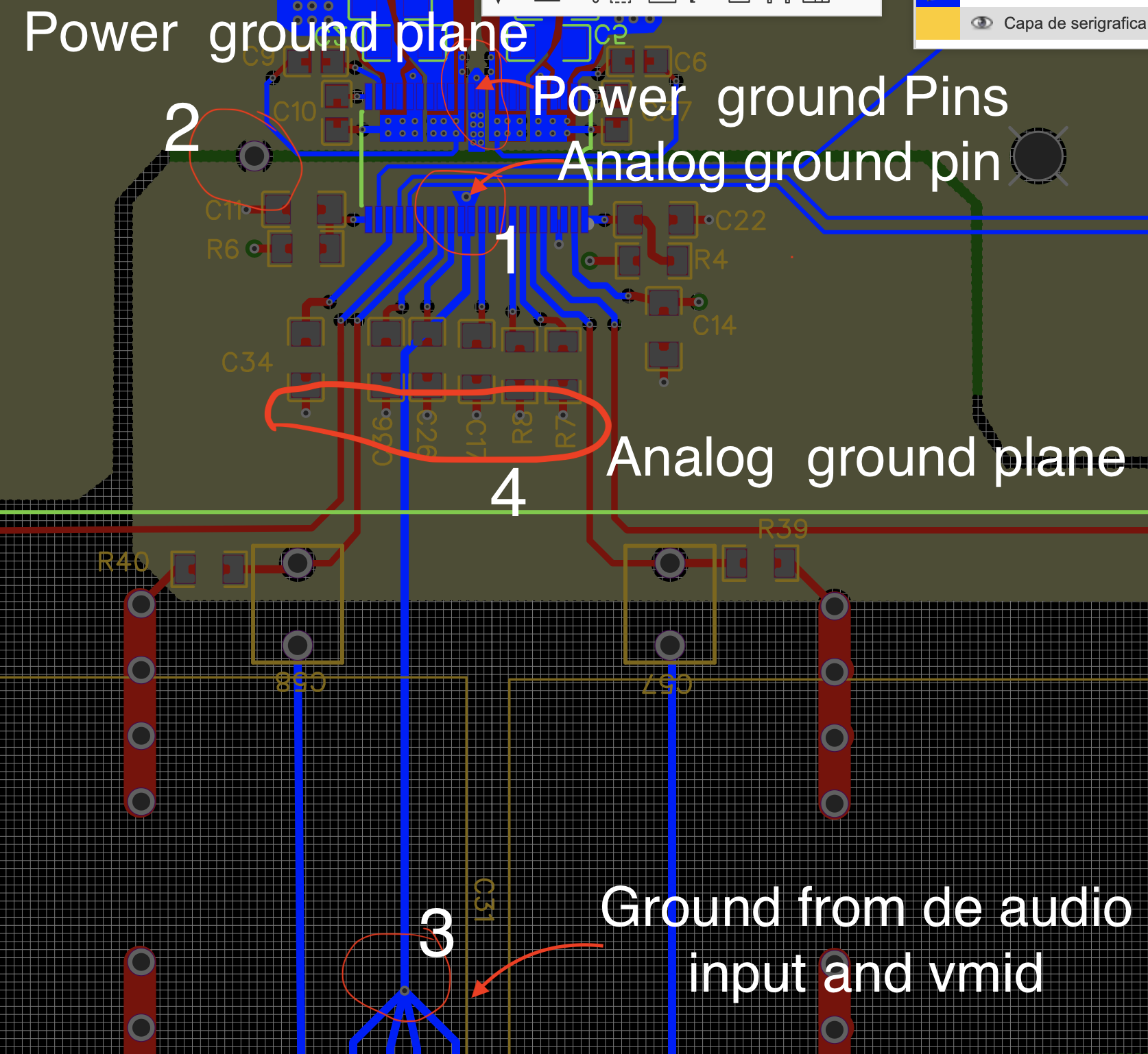

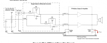

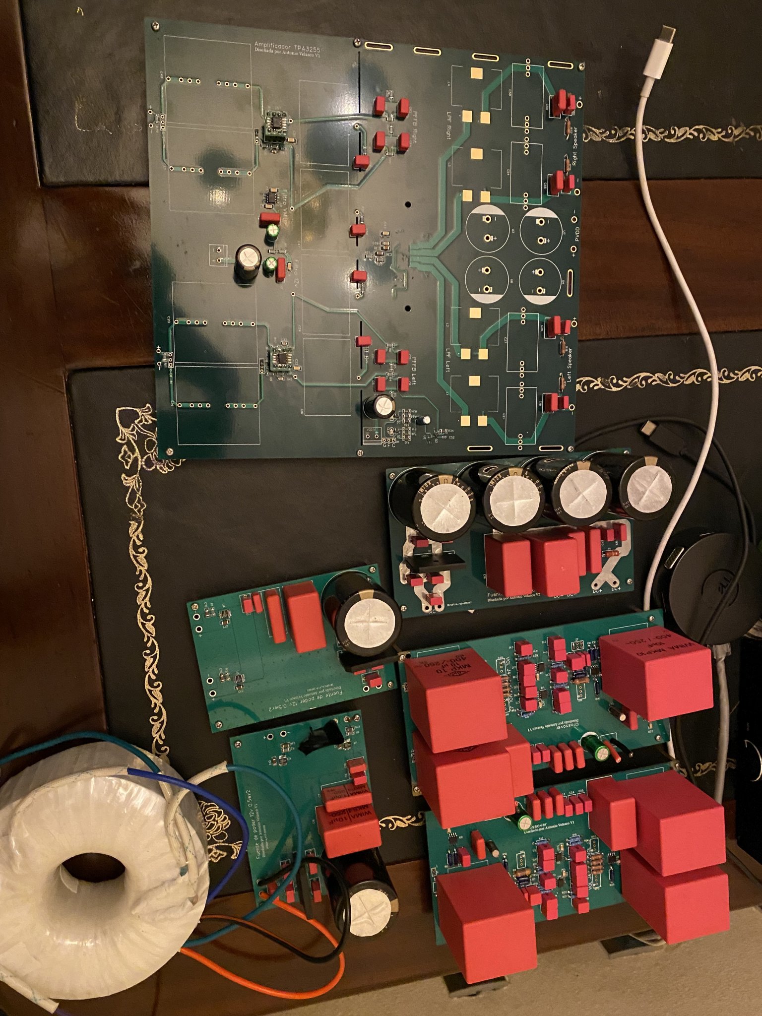

I just started to test the SE to DIF section, the timer section, and power section, it appears that everything is ok
now I will solder the TPS3255 Chip
Reactions: ricyuyc

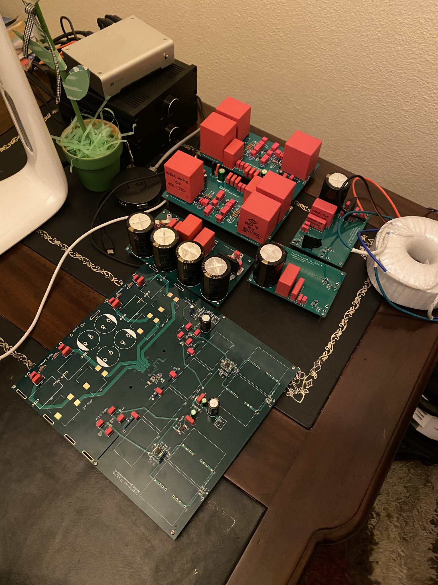

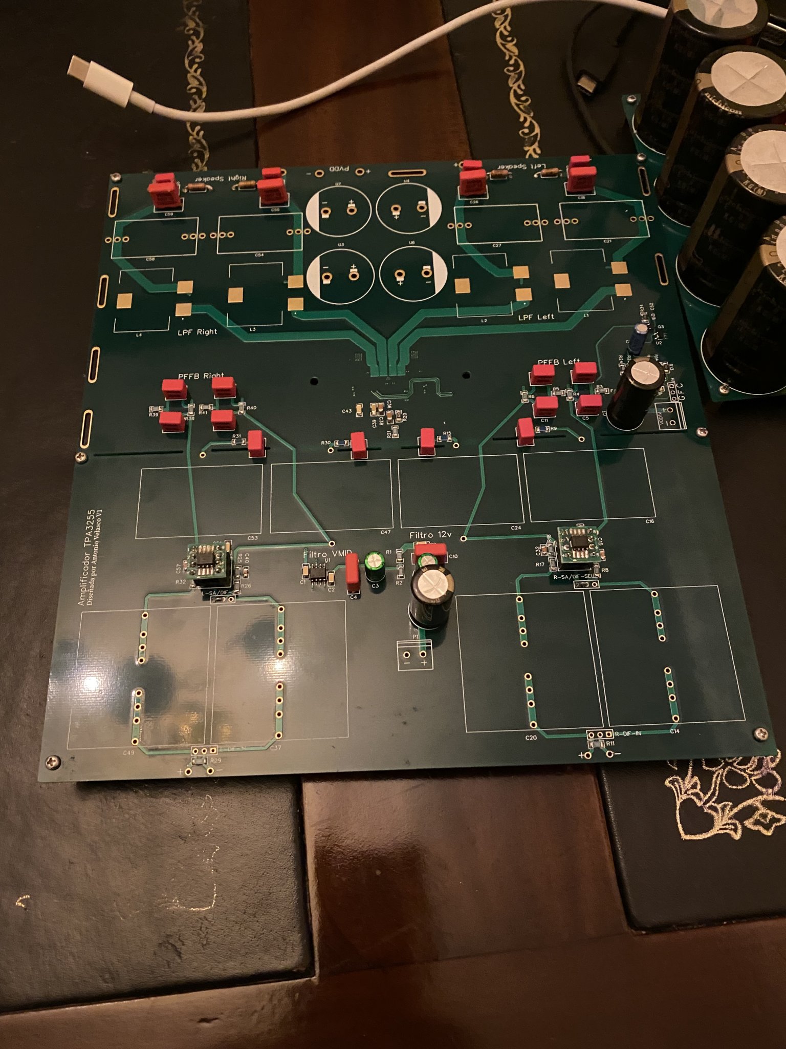

Hi all
The board is complete and I just finish testing the power supply, Now I have all the parts to do some integration testing
In order to test the amp, I ordered a Motu m4 and a Akitika 1khz sine wave generator, the kit is easy to assemble and I the results are excellent, I tested de sine wave generator and the Motu, the THD is 0.00028% and the THD+N is 0.00073%
If I test only the Motu in a close loop the results are THD 0.00030% and THD+N 0.00092%, this device is excellent to
