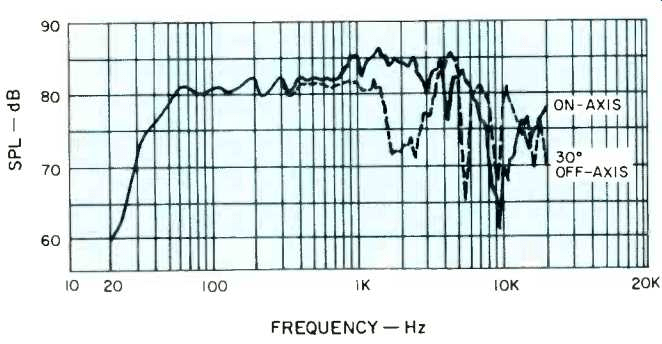

But while playing with the tweeter response, I would also attempt to tame that gigantic 5 db peak from 800 Hz to 6khz, but now we're also playing in the midrange. And this is also where a microphone to measure response would be handy- My understanding is, that peak is there because these were measured out in the room, rather than against the wall where they're intended to go (I could be wrong?). And putting them against the wall will bump the response in the lower region (I would want to measure these against the wall to see if that's actually true). But that still doesn't explain what would then be a dip starting at 5khz, it's almost like these beg for a super-tweeter. But again, I would definitely want a mic for measuring before I tackled this.

I think the best way to optimize it is to get the response as flat as possible on each face (so 45°) and allow the on axis measurement (0°) to be what it is. The large peak from 800-6kHz is caused mostly by the Tweeter's response and the midwoofers zobal network. The result is the sound is too heavy or thick, almost like an overly dramatic Hollywood traitor.

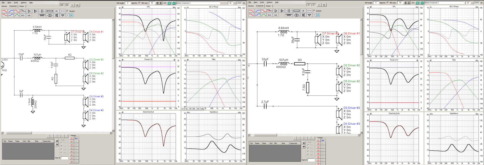

Look at the electrical crossover for the midwoofer. The zobal is skewing the midwoofers response to the right.

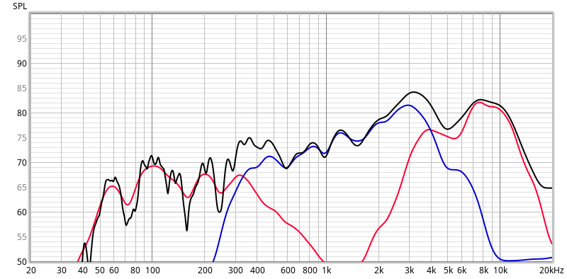

Also look at the SPL chart. the Zobal is causing a dip around 4kHz and you can see that in this measurement. On axis measures about 76 db at 4kHz.
I'll try adding a 2nd order to the tweeter but I think that won't work as well as a notch filter and a 1st order XO. I think the midwoofer's circuit must be adjusted to flatten out the response.
I measured the speakers today. I measured the speaker 45° off axis, so on axis with the dipole, and with a towel covering the other dipole. My room isn't acoustically the best so below 300hz isn't accurate. But I did use a calibration file with my microphone and my response matches that anechoic measurement above from 600hz to 5kHz. So my measurement probably is accurate.
