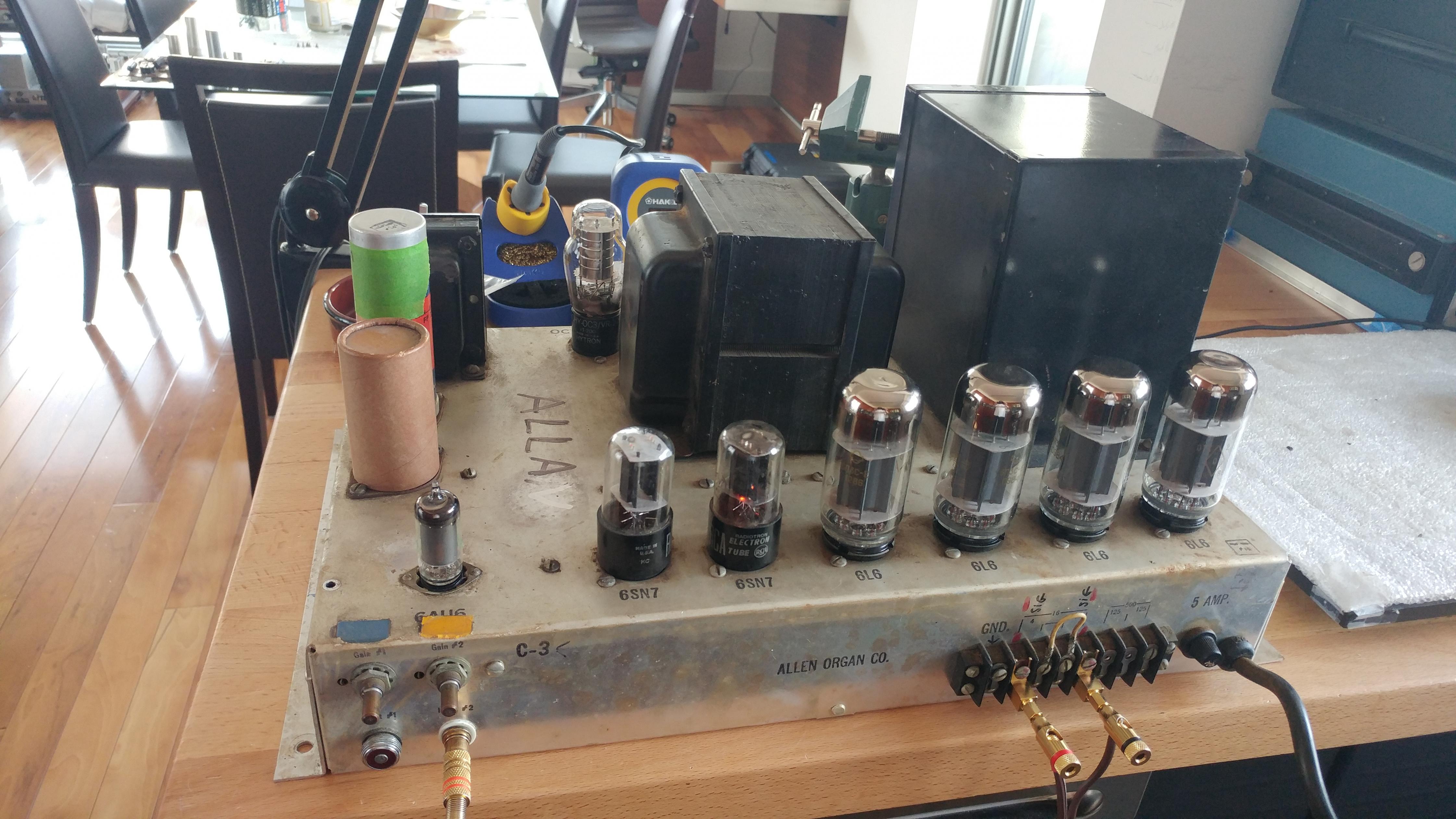

And to add to the confusion, I discovered the Allen Organ C-3, aka Allen Organ 60.
This is a parallel 6L6 design, with 2 tubes on each leg, so 4 power tubes. Each tube has it's own dedicated primary winding. It is too a regulated screen voltage design, with fixed bias with it's own dedicated supply PT. The interesting piece is the feedback. It has a separate winding acting as the cathode resistor on the driver stage. No classic RC GNFB. It has 2 tube rectifiers with a 1000 VCT supply.
That thing was design for robustness as it can run with only 2 tubes, or more. I have to try if it can run with only 1 tube. No bias adjustment, no balance, no AC balance, nothing. Plug the tubes and play. But it does play well 🙂. Sometimes there is to say for simplicity... All the transformers are made by AirDesign, which was big during after WWII for high quality professional equipment, located is PA. It closed down early 50's.
The OT is even bigger than the AO90, with dual 4 ohm winding secondary only. So you can parallel the 4 ohm or serial for 16 ohm speaker. No 8 ohm unfortunately.
There is very little data on that amp. I bench tested one and was getting 40 watts out, with quite some distorsion but this was with original components, most of then out of specs.
I am listening to it as we speak, just for fun.

Interesting. Maybe my C-3 was a previous model then.
Here it is
