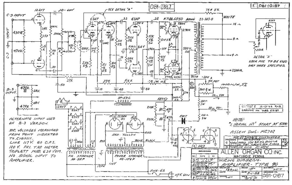

The model 75's big brother the 90 seems to be quite different. I've never seen one up close only in pictures. None of the pictures I've seen have showed a bias control. I believe they do show two test points. Are the test points to balance the output tubes like the model 75? How do you set the bias on the 90?

Low C on the pedals, a commonly used organ note, is going to consist largely of a 32Hz fundamental component for a 16' principal and diapason stops; it is often used close to full power. The engineers that designed this equipment, if it is purpose designed, would have known this as organ applications tend to be more demanding (and less ambiguous) as to the requirements for an intermodulation free bottom end. IM is very easy to detect and quite objectionable in organ music due to the duration and sustained nature bass notes. The screen regulation certainly speaks to this. I would expect core saturation to be high on the list of concerns. Many organs of the era were bi-amped, I don't know if that applies to this unit as well. What we don't know is how the top end was treated or will perform (e.g., transformer coupling and leakage inductance specs, etc.). It is a pentode amp and I would expect decent high end performance--even if it's not perfect. I would think these units are going to be capable of good performance, perhaps with some adaptation. The circuit looks decent and reasonably robust; a good starting point for an interesting project IMO.
It looks like the last schematic that I found has some modifications. The input tube and cathode resistors have been changed to a lower gain tube.
In 1958 they would call the repair man who'd pull the service literature, come out and ask you why you want to set the bias. Then after the discusion and he says, OK, you're payin' the bill, he flips her over and puts the meter on the point where the -35v is designated and then he turns the pot that's only accessable to a tech or the brave and curious, 'till he sees -35v.

The underside picture of a 90 that I was looking at doesn't seem the have the bias pot shown in the schematic. I found what must be a newer version and it does have a control mounted underside. I was somewhat amazed that it doesn't have the balance circuit that the 75 does.
