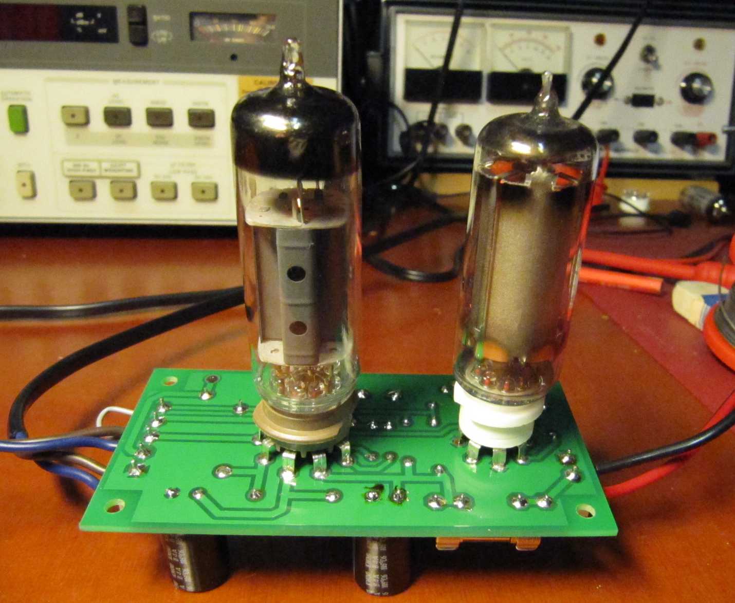

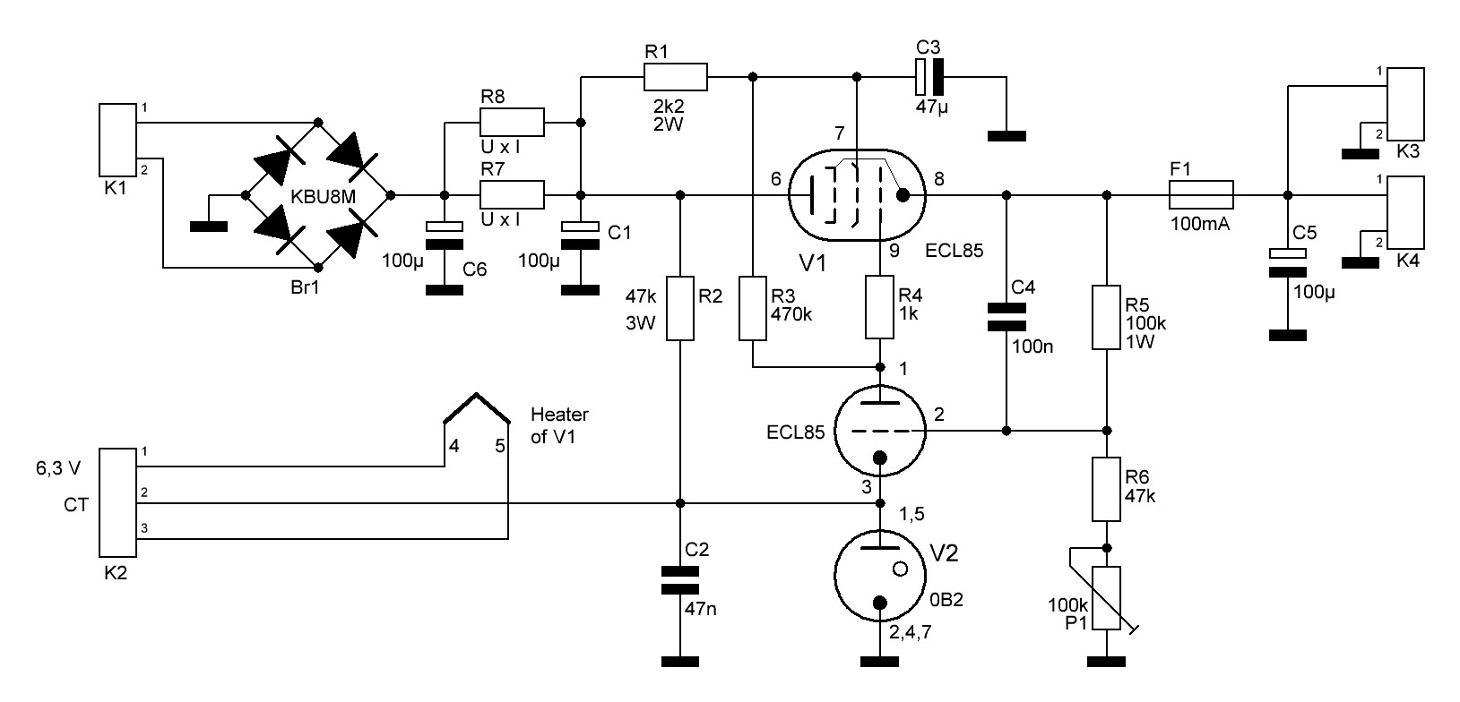

ECL85 would be sufficient. I have built several power supplies with this tube.
What determines the power rating of the supply?
Pass tube. Mainly it's Ik (max.) and Pa (max.)
Does the heater of the pass tube have to be isolated from other heater supplies?
Yes, it requires own heater winding. This must also be biased so that max. heater-cathode voltage will not be exceeded. For ECL85 this is 100 Vdc.

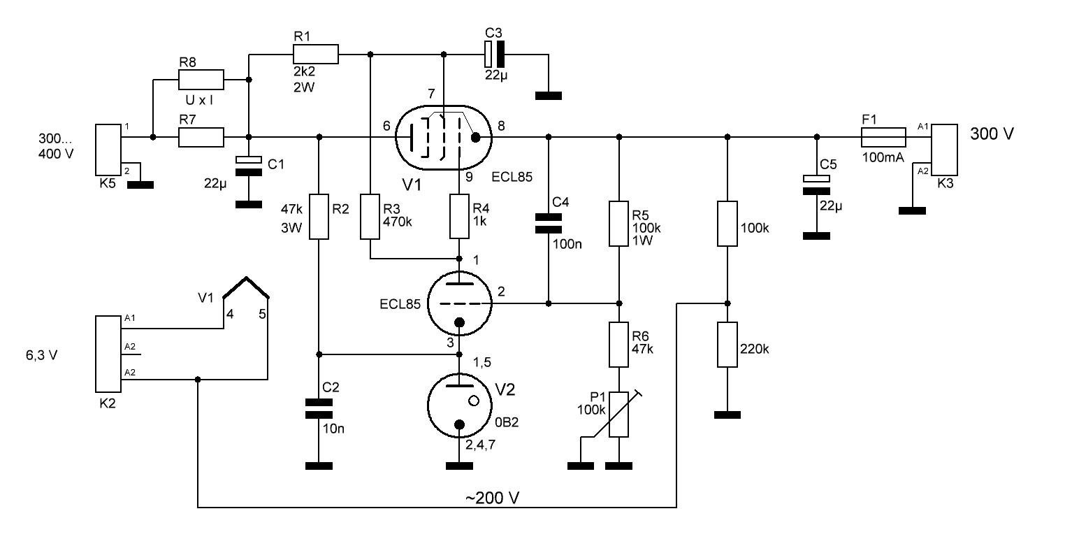

Here is modified schematic. Now the heater transformer does not have CT, only single 6,3 V winding.
The output voltage of the regulator is 300 Vdc and we want to bias the ECL85 heater to some 200 Vdc.
We get this voltage with two resistor voltage divider (100k and 220k) and feed it to either one heater pin.
The voltage divider can also be before the pass tube.

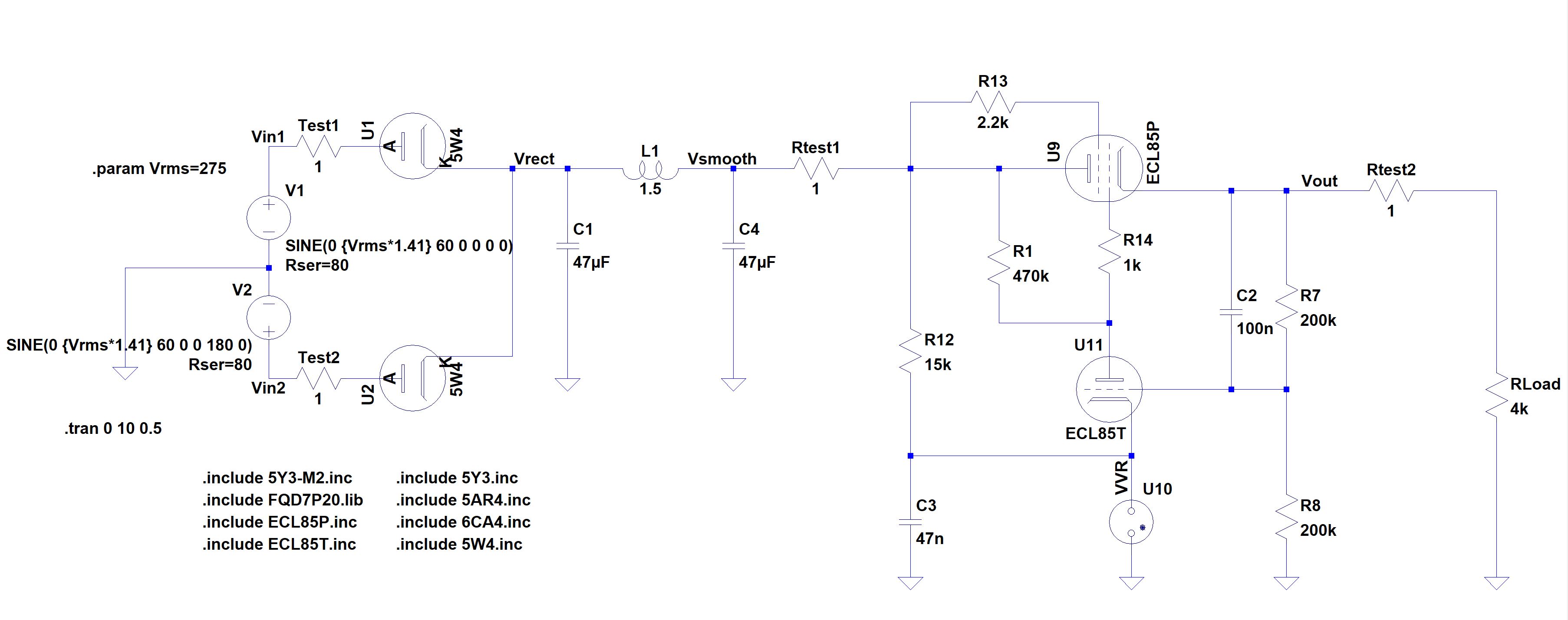

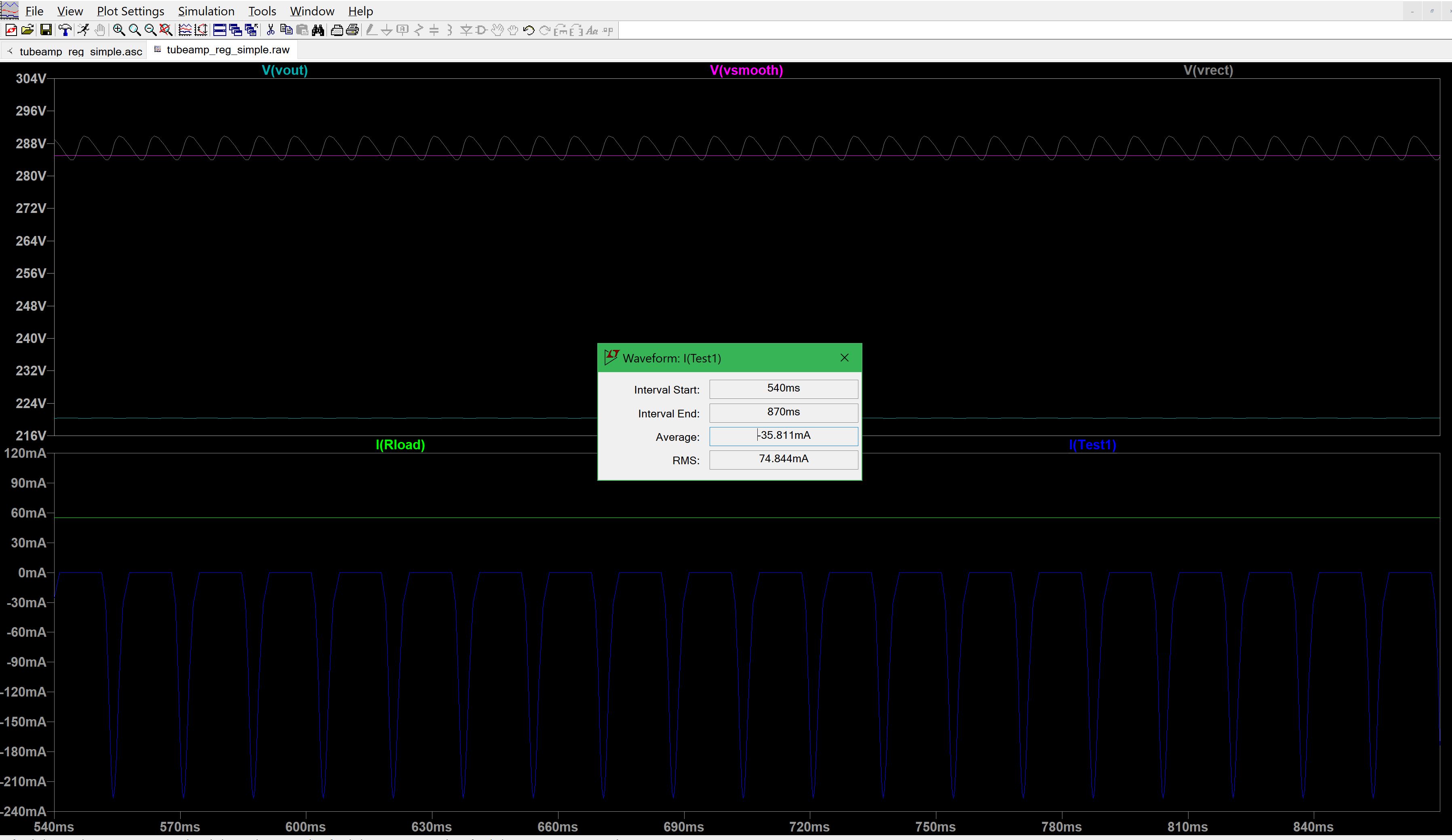

I've been simulating the power supply in LTSpice using the Ayumi tube models, and I am concerned about the current being drawn through the transformer. I was planning on using a transformer rated for 100ms or 144ms, however the peak current shown by LTSpice is around 224mA (actually -224mA, why is that?). The RMS current is 75mA. I've attached the circuit and a run of that circuit.
Would either of the transformers be OK with this peak current draw?

As far as I know, it's the RMS current that matters for a transformer. The windings should not overheat, which depends on the RMS current. (Besides the transformer core shouldn't saturate, but that's usually only an issue with half-wave rectification.)
