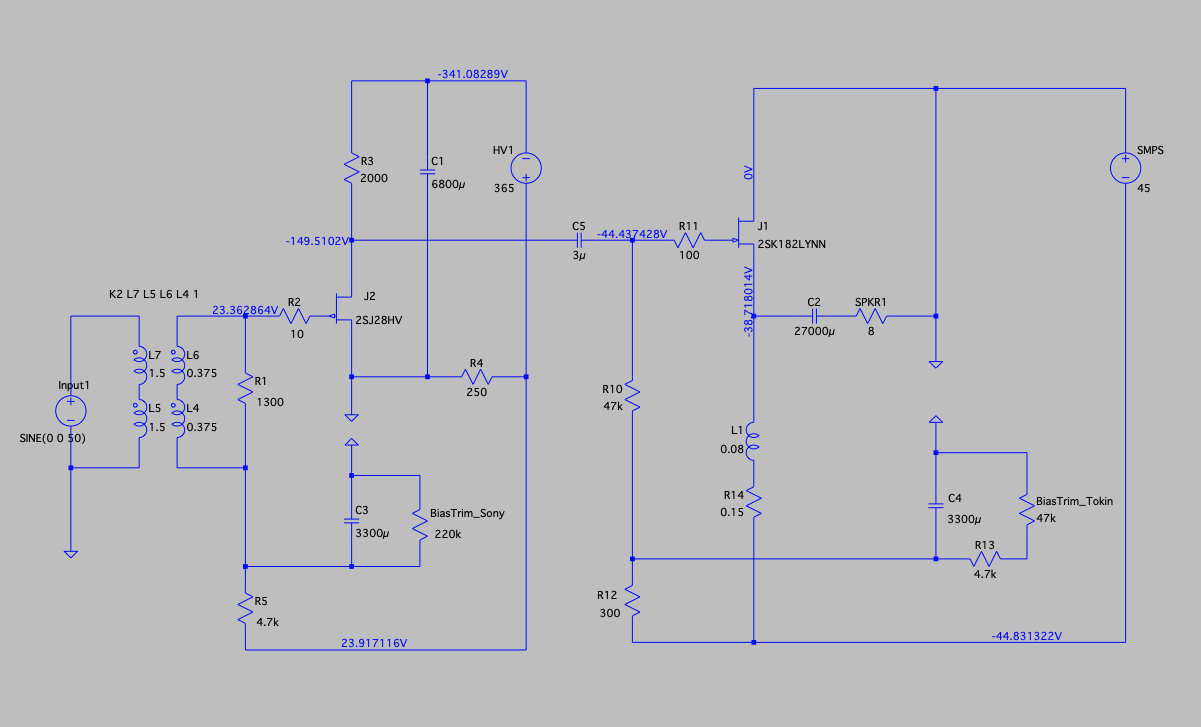

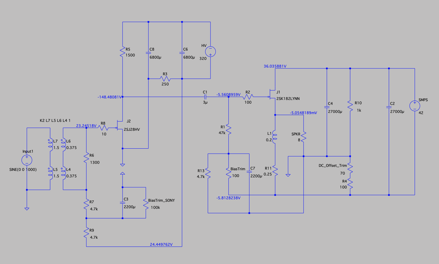

Updated Schematics Amp#1 v.1.1
I've found a rather serious mistake, and it was fixed. If anyone sees something wrong, please let me know.
What's new v1.1:
- Bias scheme of Sony is fixed. A capacitor and 2 resistors added. We have to do something like this to protect the gate from high voltage.
- Bias trimpod for Sony is also added. Not tested, but it should work.
- HV2 is now 320V, and values of several parts have updated.
- R10 and 3 trimpods' values has to be investigated a little more.
- Amp#2 is abandoned, and I don't think I will update it any more.

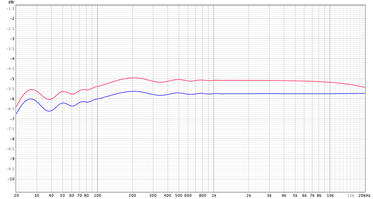

Updated v1.2:
I went back to my very first version after some experiments with real amp. While LTSpice shows considerably less distortion with previous versions, I find the real amp actually doesn't show any difference except low frequency THD is just a little different. Many issues are now solved just moving C2 from back to front of the speaker. My limited knowledge could not beat a simple and conventional way, but it was a good experiment for me, and I learned a lot of things. 🙂
Measured w/8ohm load. Sony 95mA, Tokin 4.2A.

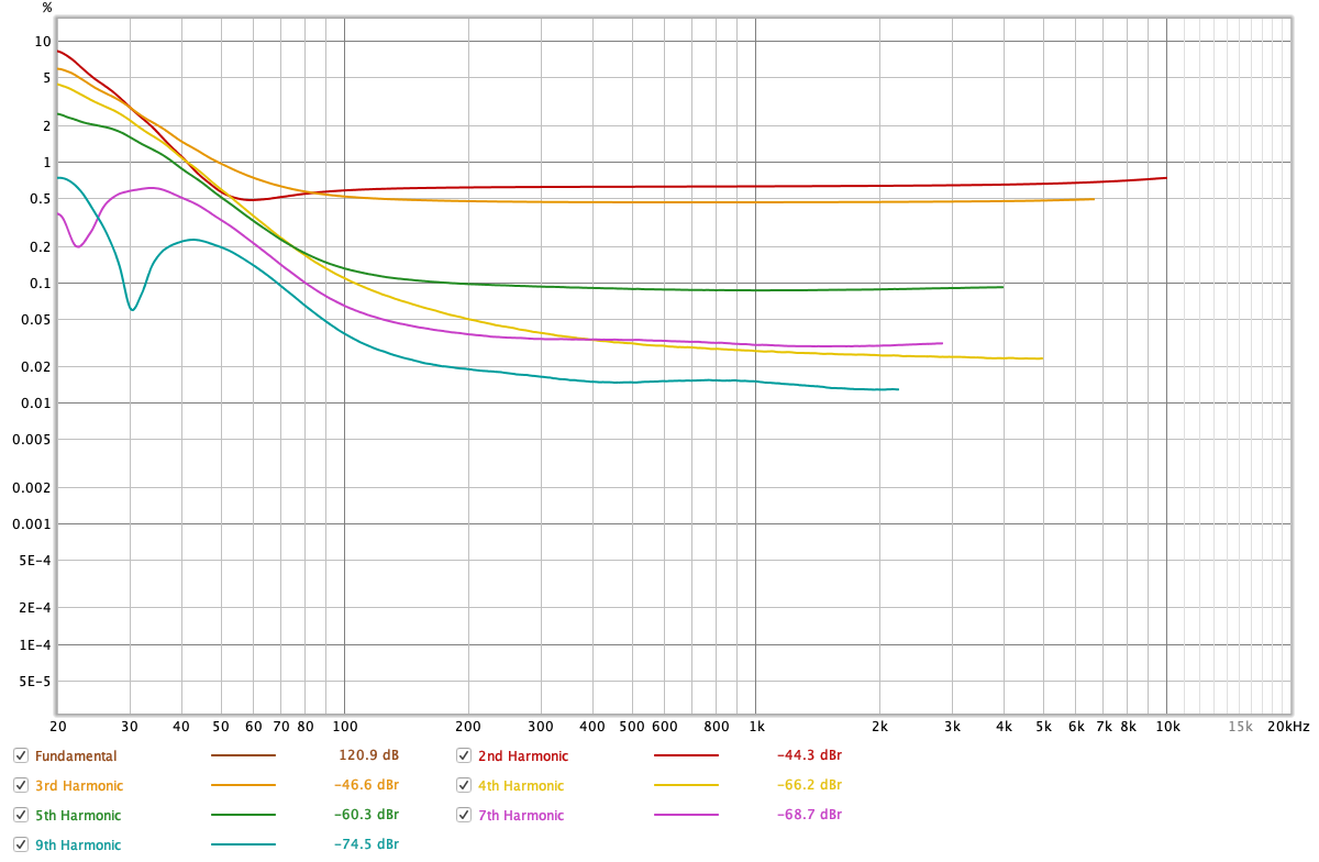

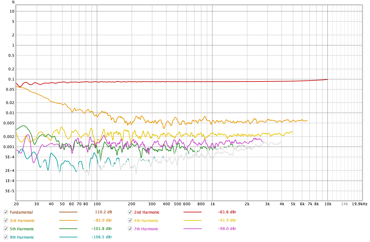

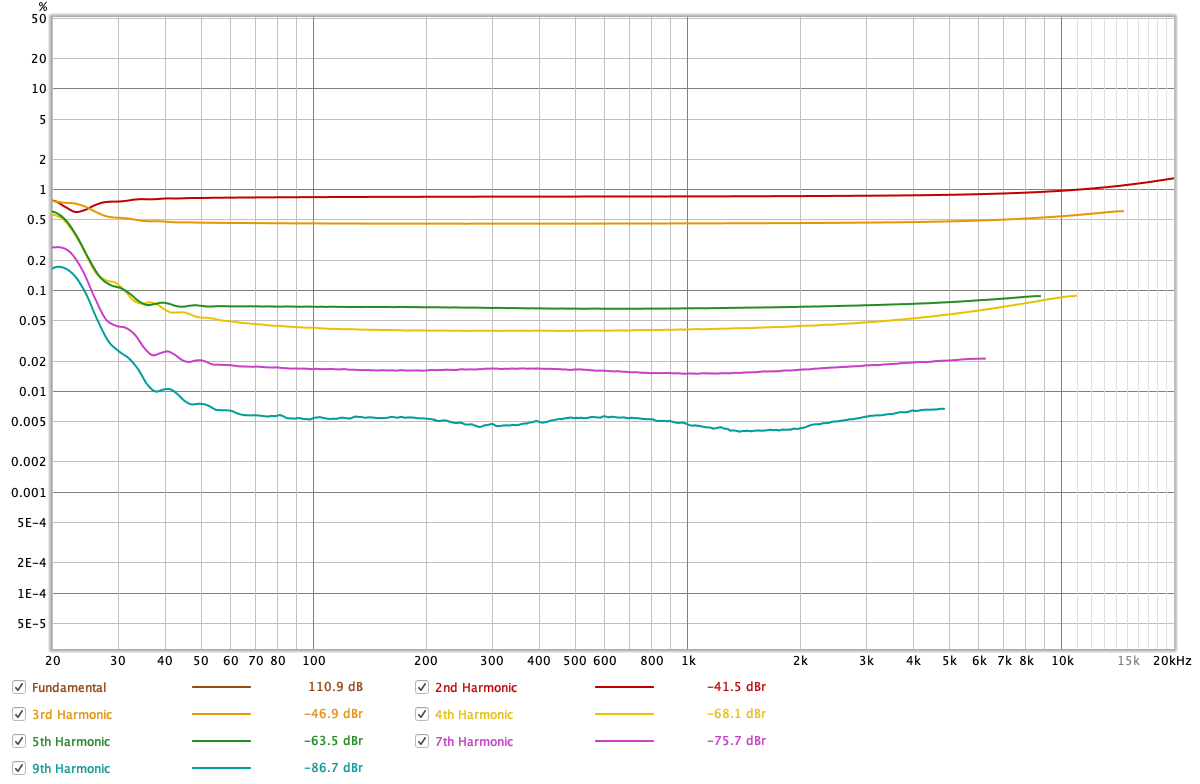

FR/THD @1W
FR/THD @50W
FR @1W-Blue, @50W-Red (showing better slew rate)
