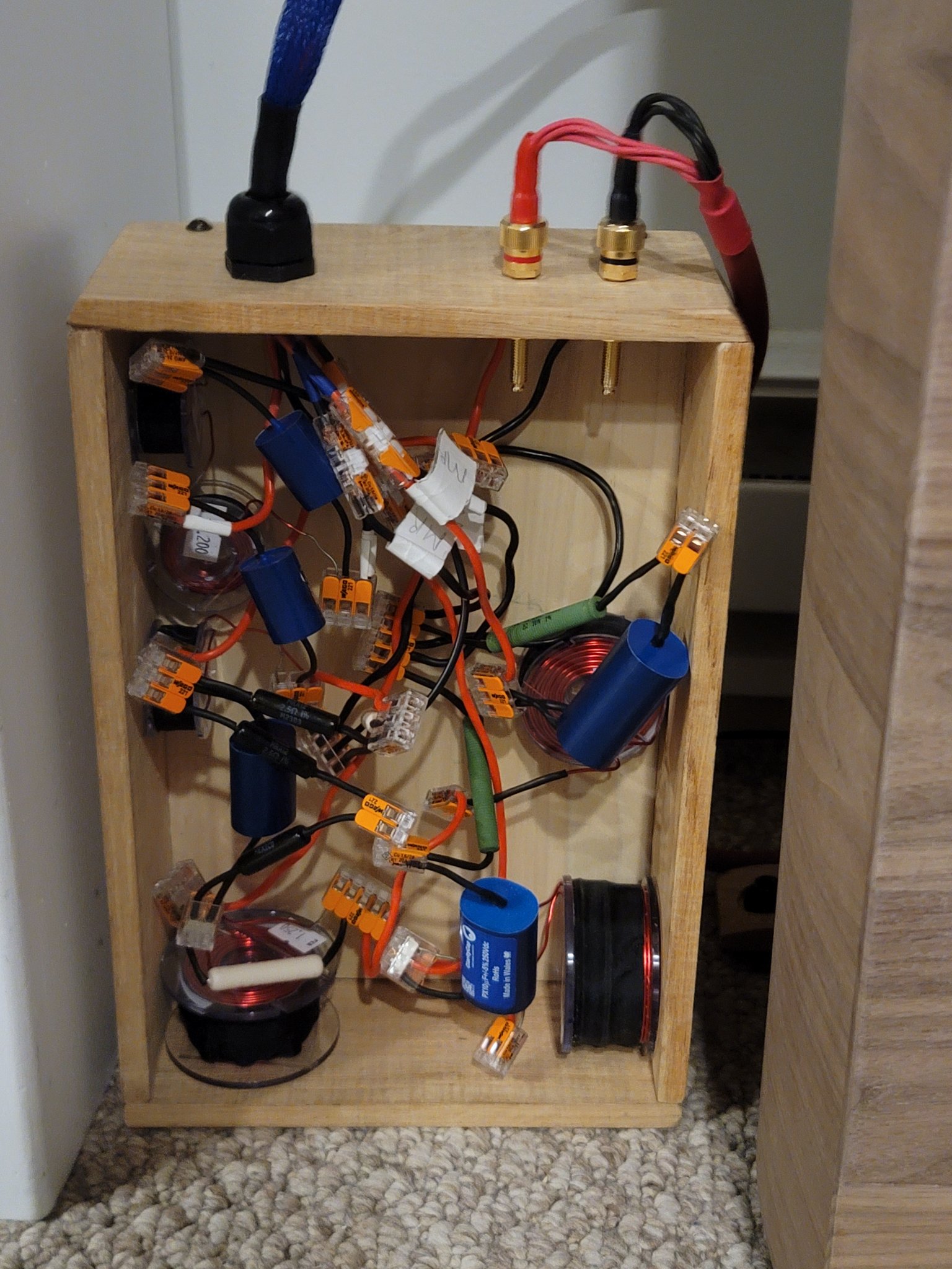

Rats nest of a external crossover below. I will clean it up and lay it out better now that I am happy with it.

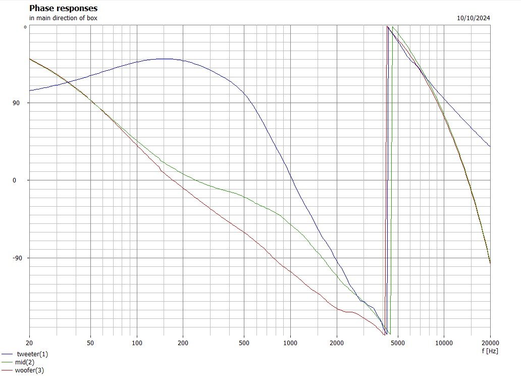

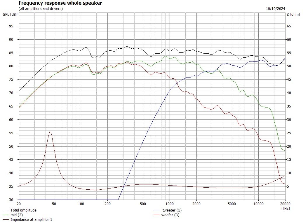

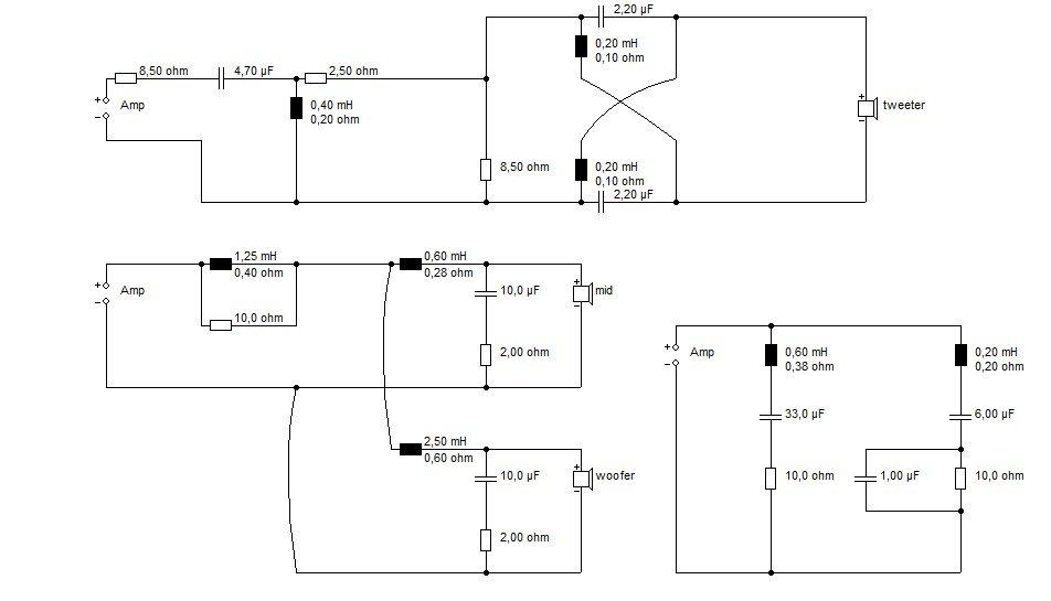

That's also a nice flat impedance > needed for true fidelity with many tube amps.Here's where I landed with my crossover with the all-pass in the tweeter to align phase better:
The all-pass filter allowed me to achieve a nice phase alignment between 2000 - 10000 Hz.
It sounds amazing!

I used the impedance shaping circuit in the bottom right to get that nice flat impedance. Without it, it is more variable, but still only peaks at 12 ohms.That's also a nice flat impedance > needed for true fidelity with many tube amps
