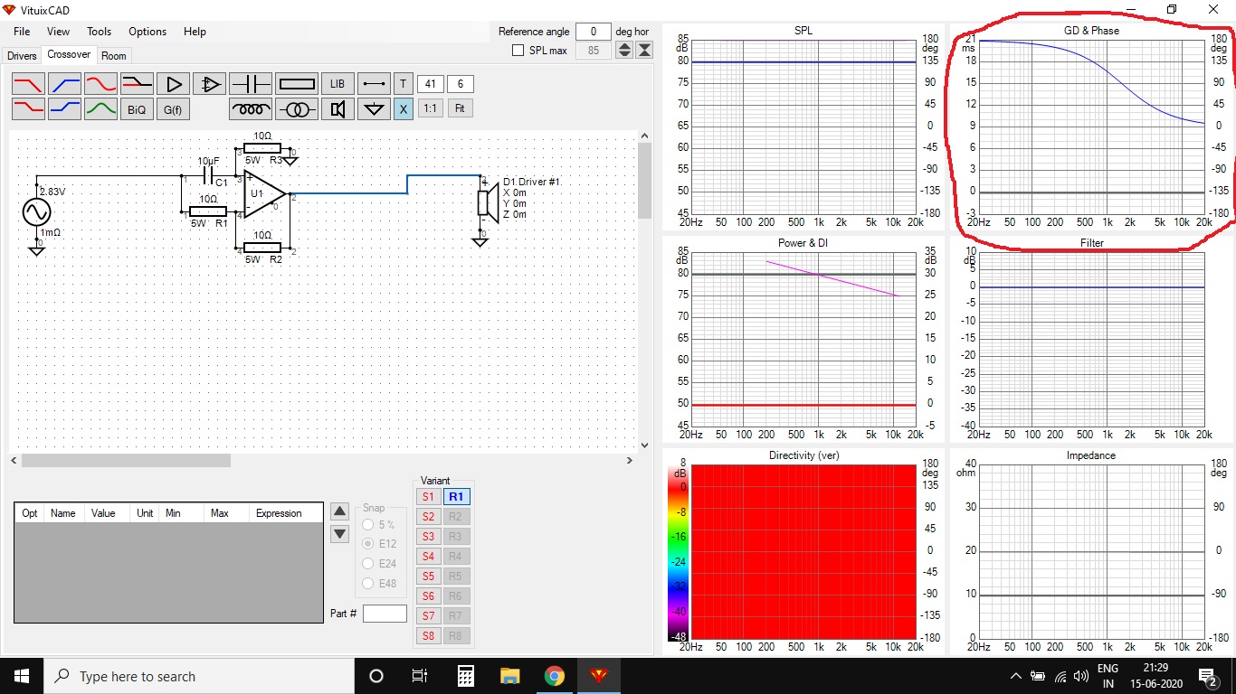

In post #3, your requirement b) is -180 degrees at lows, 0 degrees at highs>
From MT-20 description of First Order All-Pass, " If the function is a simple RC high pass (Figure 1A), the circuit has a phase shift that goes from −180° at 0 Hz. and
0°at high frequency"
How is that not a match to your b) requirement?

If your simulation is returning the inverse of what the tutorial says it should, then what do you think is wrong?
Perhaps start by checking which point in the circuit you are using as the reference phase input?
I'm assuming your post correction is the result of reading the tutorial...
I have played around with VituixCAD and another online spice tool and both gave the same phase response. I feel the AD paper (MT-202.pdf) you referred has a typo.
Pls review my schematic and tell me what to change and I shall do so.
I edited the post to upload the attachment. I have read that paper as well as Rod Eliott's all-pass schematic web page before starting this thread.
No, the paper contains no errors. There are plenty of other examples of the same topology and results on line. You are having a simulation problem. Phase is always measured relative to a reference. If your results are inverted you likely have the reference and measurement points swapped.

There is nothing wrong with the simulated phase response, the phase decreases with frequency as it is supposed to in a first-order all-pass. I haven't read the paper, but I guess the people who wrote it just calculate the phase modulo 360 degrees, as you can't see any difference between a sine wave shifted -180 degrees and +180 degrees (or +540 degrees for that matter).
