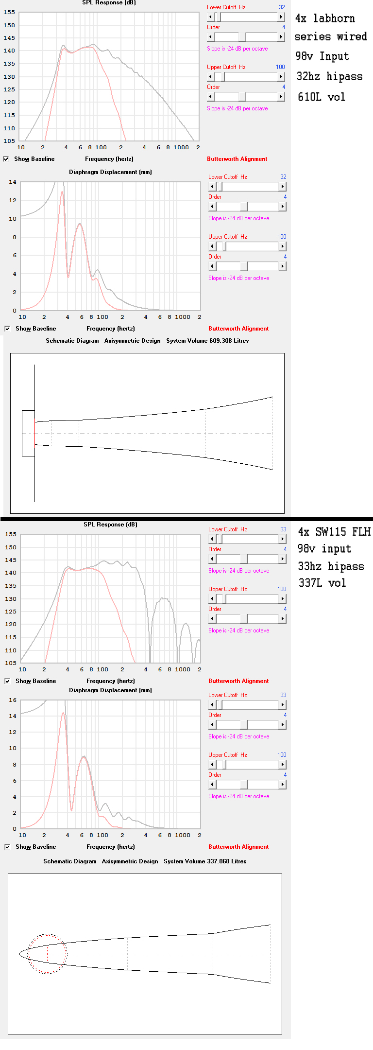

btw, heres my rough start sim on the 18SW115 horn (4stack) compared to the lab sub (in a 4xstack). fold forthcoming 😀. should fit in half the size though maybe

basically, for the same number of drivers, pick up 4 to 5 db in output, and a handlful of hertz in extension.
