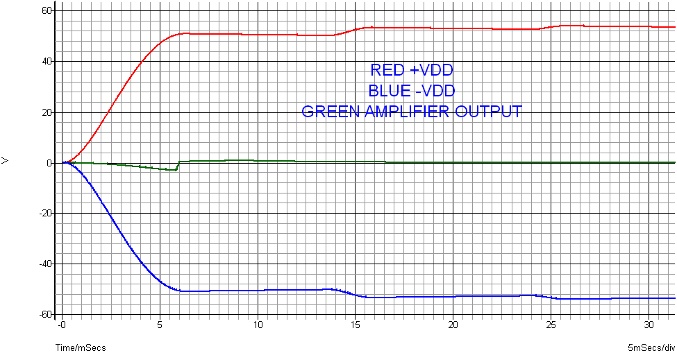

The last update is absolutely necessary as the power on thump
will be reduced to 3V peak over 6 millisecond , otherwise , without
the mod , it will reach as much as 40V for 35 millisecond duration.

Can LTspice look at this start up process and can it predict the voltage fluctuations on the output during the first few tens of milliseconds of start up?
Of course , you can either shape the supply voltage output function
or more simply "build" a regular power supply with two generators
and a diodes bridge + filtering caps...
For exemple , using the latter trick , the picture of this thread amp
powering on as it works with the last update discussed a few posts above.

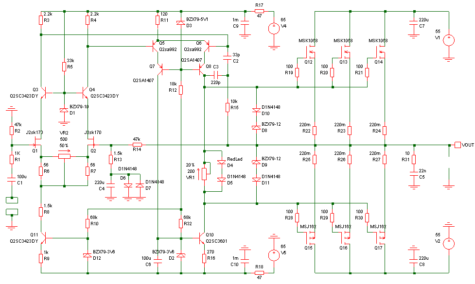

The standing currents are tailored such that the hotter ones will barely dissipate 0.1W , the 0.5W/1% you re using will be more than enough from the start.
I would have a question, which "transistors" must get some heatsink > I think about the VAS and front end.
Power mosfet-s of course!!!
I did check the transistors you picked, it seem some of them are special, not cheap but I'll source them.
As you pointed it, set apart the laterals , the VAS transistors are the ones
that need heatsinks.
In the schematic below , Q7 has to dissipate 1W while Q8 and Q10 dissipate
0.5W each.
You can mount Q7/Q8 in a common heatspreader if the design need
to be compact , just make sure the heatspreader is efficient enough.
Q11 , the input stage CCS , dissipate 0.16W and need no heatsink in principle.
The other transistors dissipation is negligible and they need no heatsinking.
For Q3/Q4/Q10/Q11 the following models will suit perfectly : 2SC2911/2SC2912/2SC3423/2SC3502/2SC3503/2SC3600/2SC3601
The complementary types are used for Q7/Q8 : 2SA1209/2SA1210/2SA1360/2SA1380/2SA1381/2SA1406/2SA1407
Just take the less expensive ones on the list....😉
Complementarity when chosing among those transistors is not critical , just be careful for the cascodes that must use a pair of the same device.

For performances i think that it s not easy to extract much better numbers from the current design
that reach the essential of two stages amps capabilities , this without compromising stability wich is feature that is not often adressed accurately by most of the designs that hangs on audio forums...
The perfs should be quite good and can be further improved for THD by using a TMC compensation
wich i elected to not implement since it can slightly reduce stability but if you re after the lowest
possible THD i put the mod below so you can choose to implement it or not.
The mod is only around the VAS and it would be easy to go from a compensation to another using the same PCB ,
the components are tailored for minimal TMC effect , to not endanger stability , it allow THD reduction
mainly in the audio band , by 10dB at 1KHZ and about 3dB at 10Khz.
Also , there s no LR network in serial with speaker in the schematic , as such a network position
is to be implemented elsewhere than in the amp PCB.
Eventual values should be 1R in parralel with a 1uH air inductance , about 15 turns of 1mm2 copper wire
around 10mm diameter should do it perfectly.
Why do you choose to apply the low frequency roll-off in the NFB (330ms) rather than at the input (4700ms) to the amplifier?
I realise that very little signal will exist at these frequencies, but could such wide-band abilities allow the NFB to interact with the PSU smoothing?
What is the purpose of the forward biased led+diode in the bias voltage string?
Roender implemented a cascode referenced to ground in the other half of the dual VAS. Thus applying ~half rail voltage to all three devices Q7, Q8 & Q10.
Do you see no advantage in such an arrangement, or worse, do you see a negative effect that should be avoided?
Yes , it increase the rejection of PSU VLF as the amp gain is reduced at those frequencies by the virtue of increased global NFB rather than with a passive attenuation at the input
that would left the amp intrinsical gain , thus PSRR , unchanged at those same frequencies.

The hotter zener is the one of the VAS current source , D2 ,
wich dissipate about 0.035W , so 1W give quite a margin...
A few points about the tests process to prevent any bad surprise.
The laterals gate voltage threshold dispersion is quite large on the datasheet
and it can be quite low , the ones on my amplifier are at about 0.25V Vgd
for 100mA current , so usually there s components whose value is to be set
when doing the tests.
As a result when setting your amp use a 100R trimmer instead of 220R ,
and replace the diode that is in serial with the led by a strap, this will
limit the total biaising voltage to 1.2V max value should the trimmer have
a faulty contact , laterals are expensive and one is never cautious enough...
If thoses conditions dont allow to reach a high enough quiescent current
then put a 220R trimmer and remove the strap to put the diode instead ,
all this will extend the biaising voltage range to about 1.9V.

On the PCB i see no boucherot/zobel cell connected to the output ,
that is 10R in serial with 22nF , R31/C5.
Otherwise it can be valuably deported in a separate PCB along
with the output LR network , this will ensure that no significant
AC current run in the amp PCB ground.

Hello wahab
Yes you right!
I know what happened, I left out the source resistors 0R22 and with those I forget the Zobel.
I will put on the speaker terminal if that good enough.
I read some opinion even better than on the PC board.
If you disagree I will try to find some room on the PC board.
To be honest I work on a amplifier Pass F5 turbo V1 enclosure, so I didn't went over on the layout again..
I will do that before I each the PC board! That must be done again.....
Thanks for the warning!

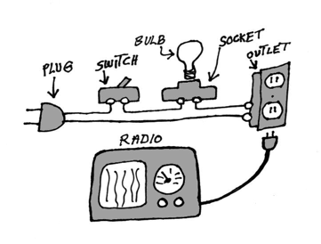

I know you wrote about the bias set up. A bit confusing to me..... To set up the bias it work the same way like at other amplifiers- higher resistance I measure on the trimmer between Collector Q8 & Q10 that cause lower bias?
From your instruction I understood exact the opposite.
I will use a 100W light bulb something like the att. picture until I set up the bias. If there is any problem the light bulb glows (will take away the current, and that help to minimise the damage)
AndrewT always advise the light bulb at start up...

That s it , the lower the resistance of the trimmer the lower the quiescent current , so it should be set at minimum resistance before powering on .
Indeed mandatory when doing the first real world steps....😉

In fact , the PCB ground should be separated in two different grounds
that will have their own ground wire that goes to PSU.
The first ground area should enclose all paths that have variable currents,
that is the return ground of the power stage decoupling capacitors
and the one of the zobel network.
The second ground area will enclose all the other grounds return paths ,
that are the ones of the frond end circuitry , including its own decoupling
caps.
Doing this way will reduce vastly eventual ground pollution
induced distorsion and noises.

Hello
I agree with you wahab!
I just try to test the amp now to get some idea of the performance.
Later I'll use separate grounds.
Even on simple amplifier (with one PS) I use two ground. I do separate the signal ground from the PS ground with a 10R resistor.
I test the amp and after I'll start to upgrade. Even like these I can get some idea about the sound quality.
At the test I'll use only one PS how you advised. If I like what I'll hear I will increase the front end with 10V rail voltage.
I'll separate the ground even the signal ground.
I just each one PC board for test! After it will be easy to mode the PC board.
Right now I try to keep my PC board a certain size.
Your advise well appreciated! If I like the amp I want min. DALE or PRP resistors, and I'll upgrade the PC board to.
These only a test board, I don't want to mess with PP connection.
